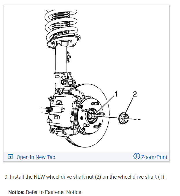

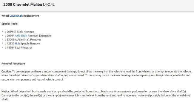

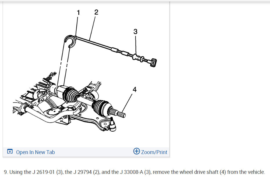

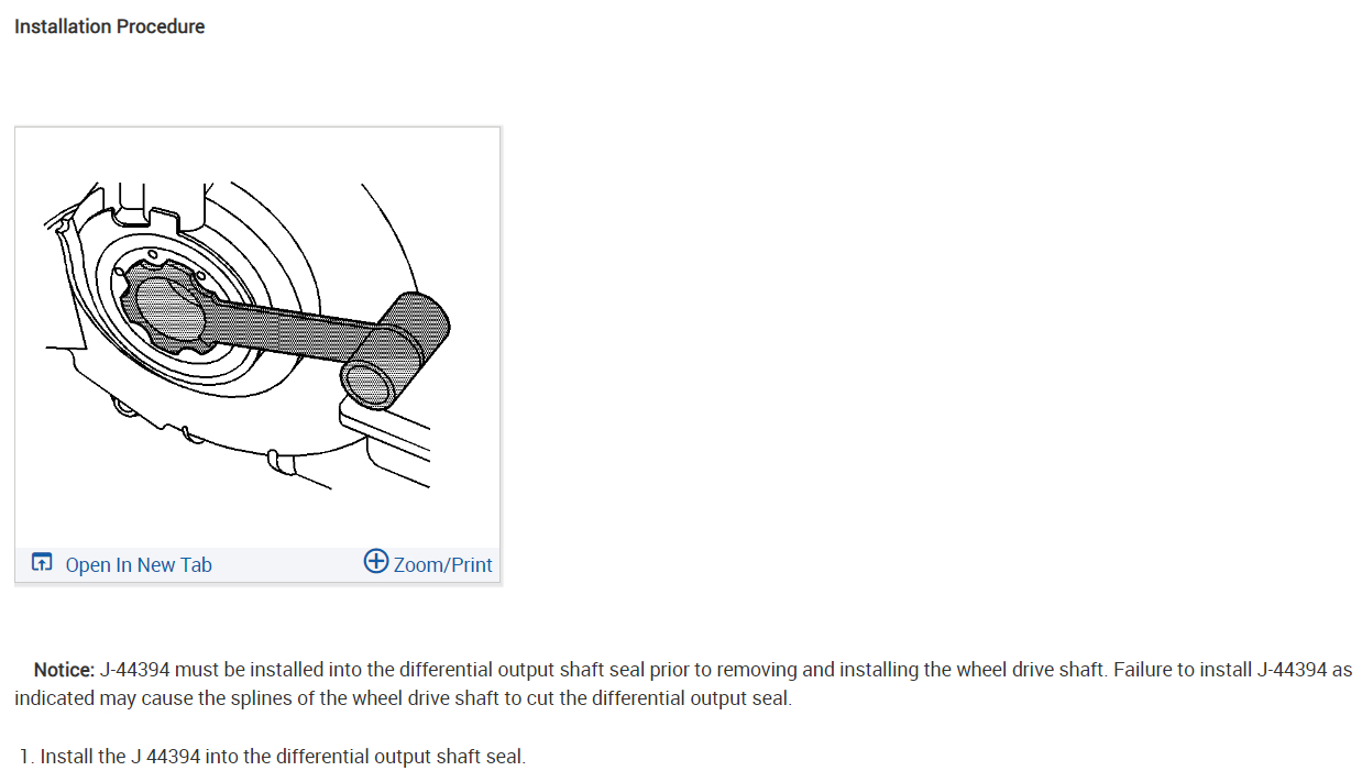

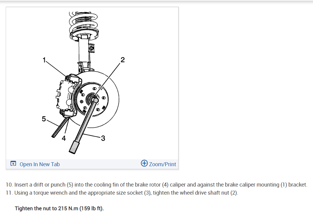

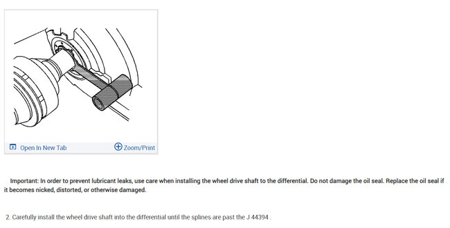

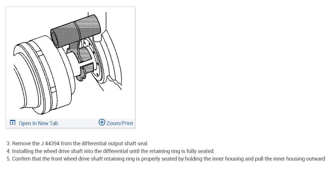

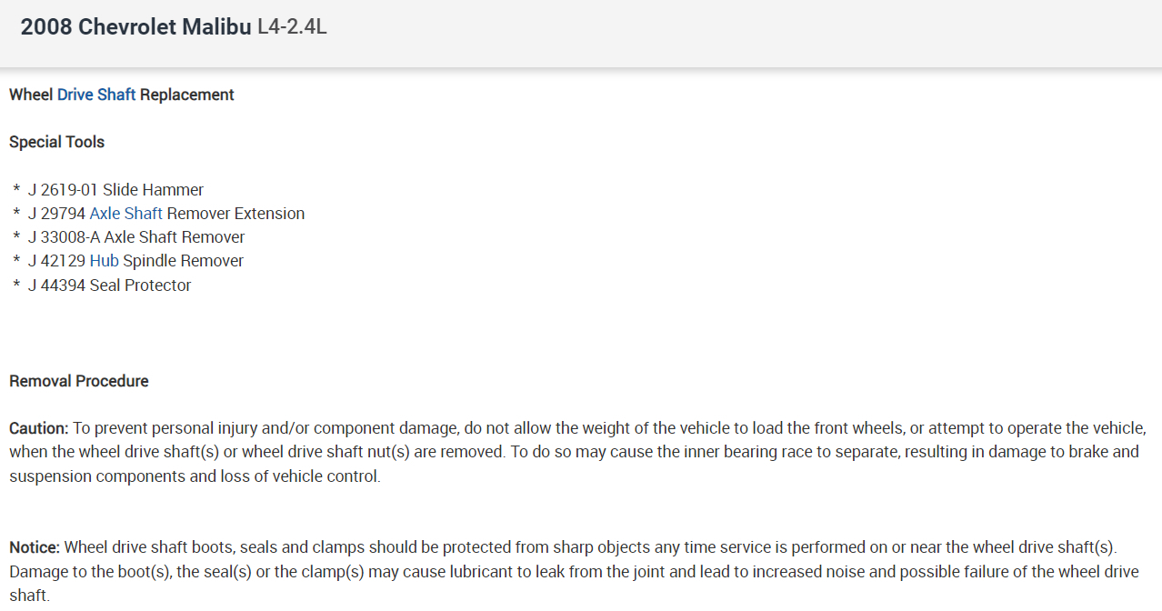

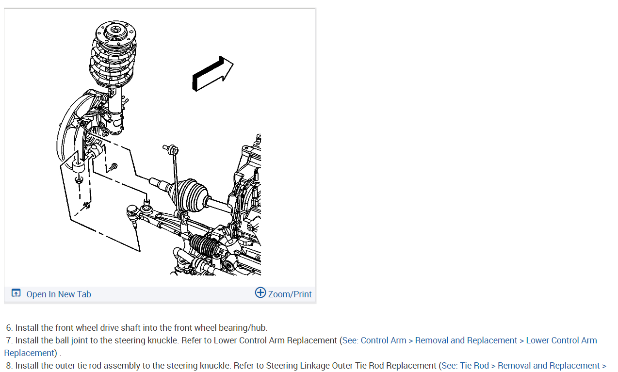

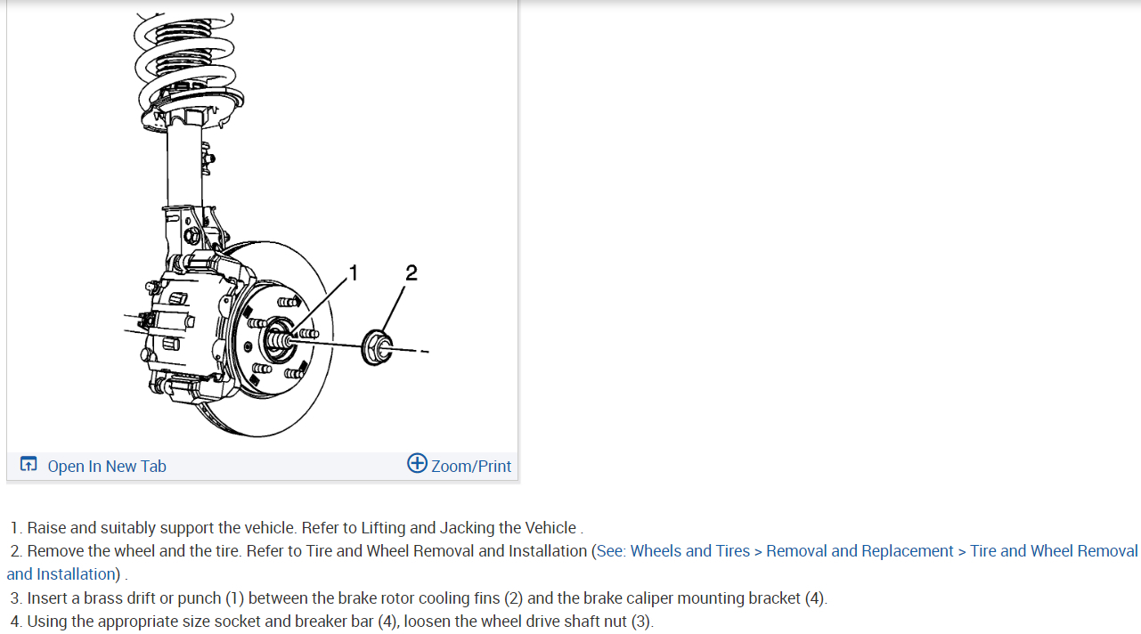

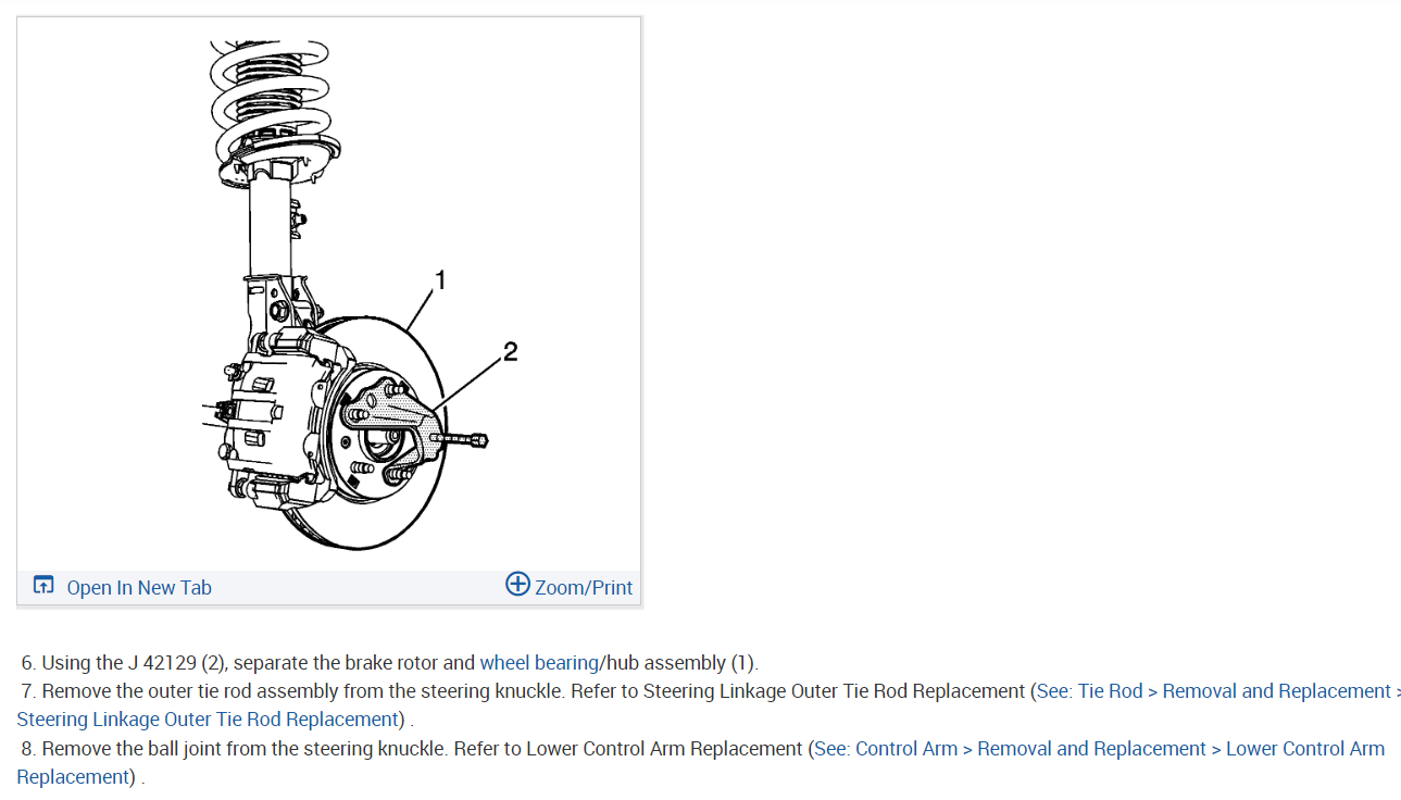

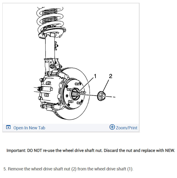

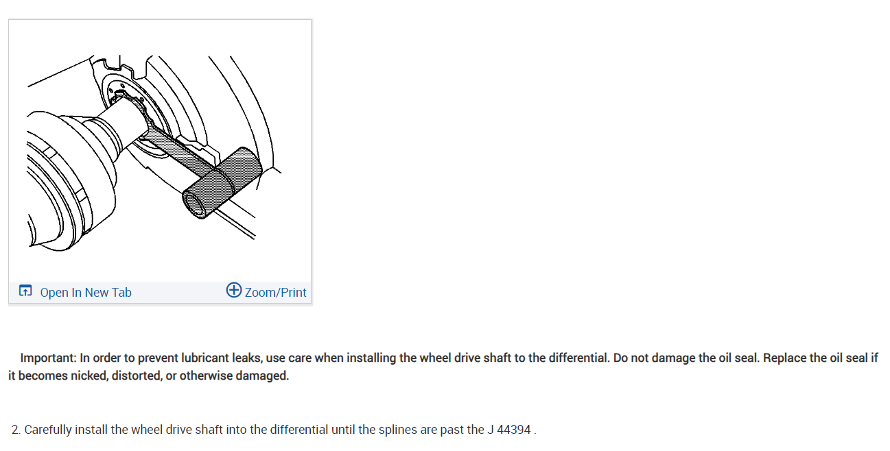

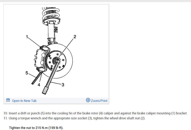

Here is how to remove the CV axle in case you need it. Check out the images (below). Please upload pictures or videos in your response to any problems so we can see what to help you with.
