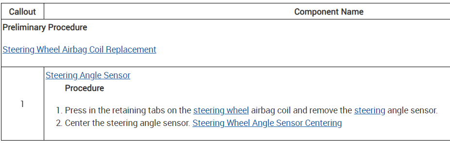

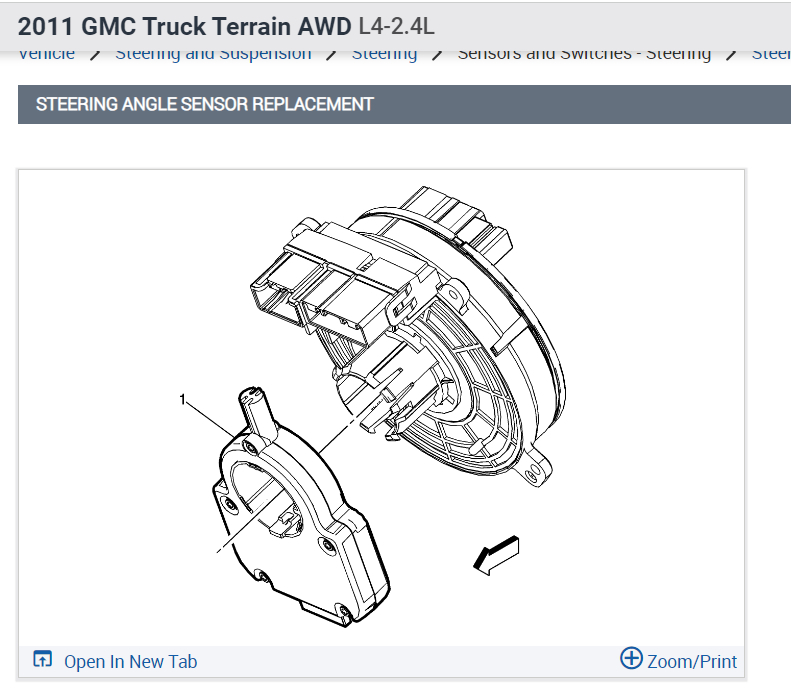

Here is how to change out the sensor in case a code is stored for it. Check out the images (below). Please let us know what happens.

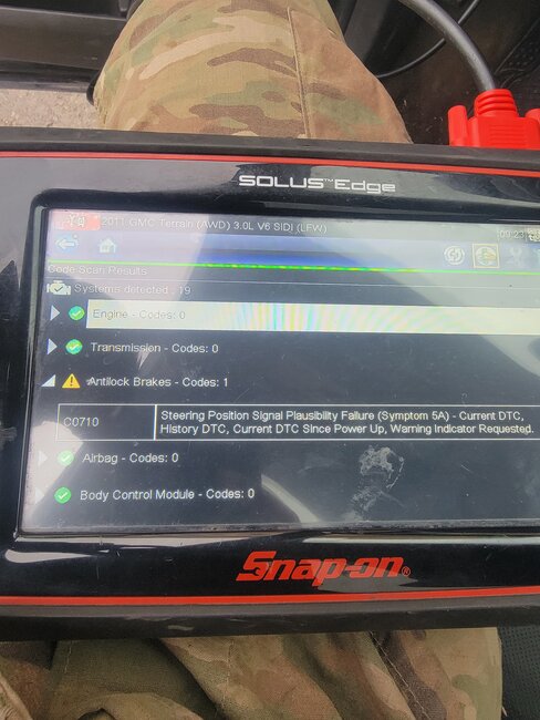

Code C0710.
Nov 21, 2023 at 2:38 PM
Thanks for the code. Yep, this would be a steering angle sensor problem, I would replace the sensor and then clear the codes which should fix the problem.
