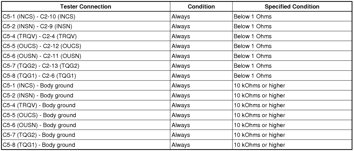

The first thing will be to verify the wiring is okay, visually inspect the wiring to the steering gear to make sure it is connected and that none of the wiring is rubbed through or broken. If it appears okay then test each wire to be sure they are conducting.

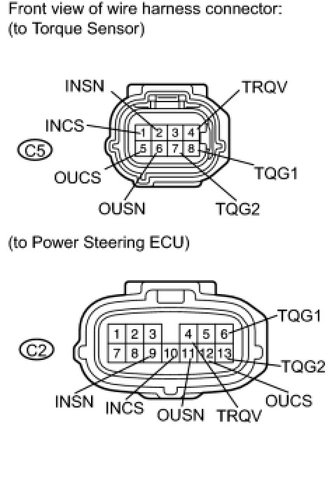

The first set of images show the two connections for the power steering sensor to the power steering ECU. Connector 2 and connector 5. Test between the points indicated in the chart and verify those values. (basic continuity)

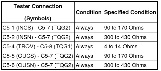

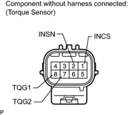

If the wires test okay (I am betting they will) then the next step should be testing the sensor itself to make sure it is actually bad, as this will rule out the problem being in the steering ECU. To do that test you test between the pins on the sensor connector following the information in the second set of images.
Once complete you should know if it is a bad sensor or a bad steering control unit.
