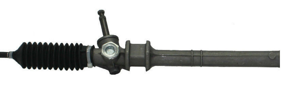

Yes right Roy, the steps you outlined are exactly what is expected. This car, however, has no steering hoses and no steering pump- it is the "Manual Steering Rack and Pinion Assembly 1994-1997 Ford Aspire Base SE" I am replacing (image attached). I have the Ford Service Manual for this car, and it calls for the steps I described in my question (it asks, in step 2, to remove the "steering column and lower steering shaft." In another section, it describes removing the steering column (which is where the problem is because it pretty much asks for the removal of everything!)Can you reconfirm one more time. Is it possible that the gear input shaft to couple bolt is inaccessible until the column is removed? That's a lot of work to replace a primitive gear as this one.
