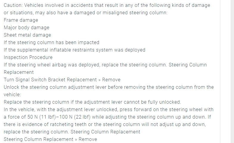

The new one does come with a plastic lock to prevent it from turning too much.

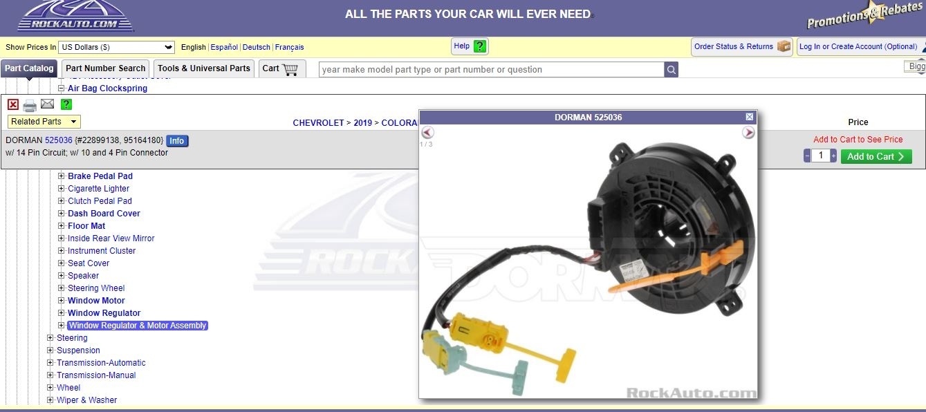

https://www.2carpros.com/articles/steering-wheel-clock-spring-removal
I attached a picture of it for you to view. Dorman makes the clock spring and you can get it at any parts store or Rock Auto.

The plastic piece is not available by itself. it is only available with the clock spring.
You can try to make one.
