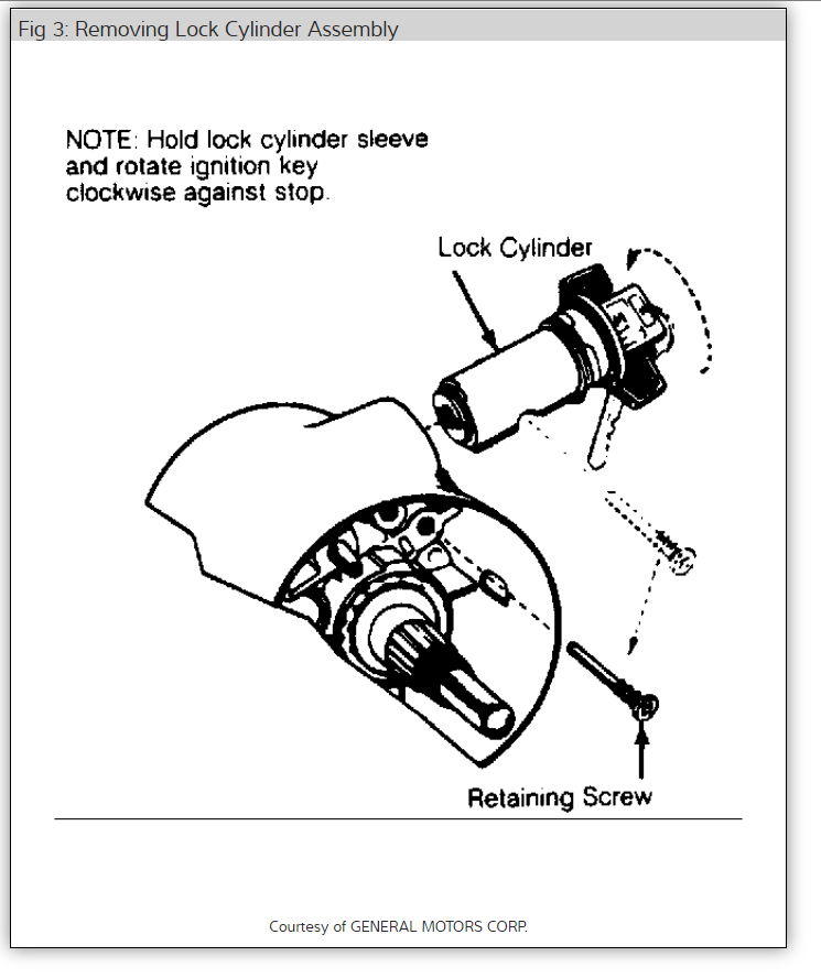

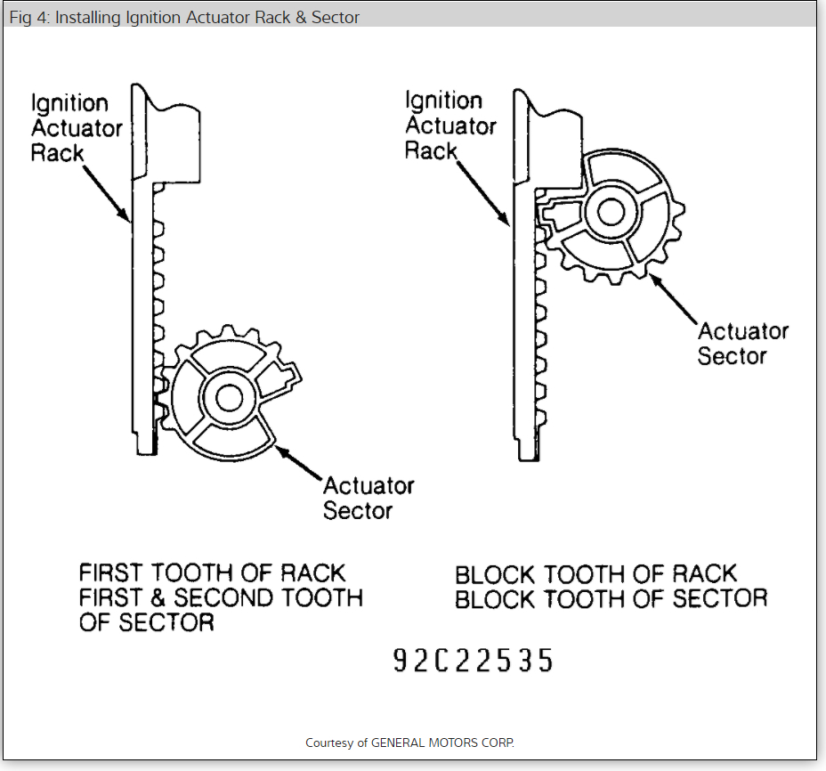

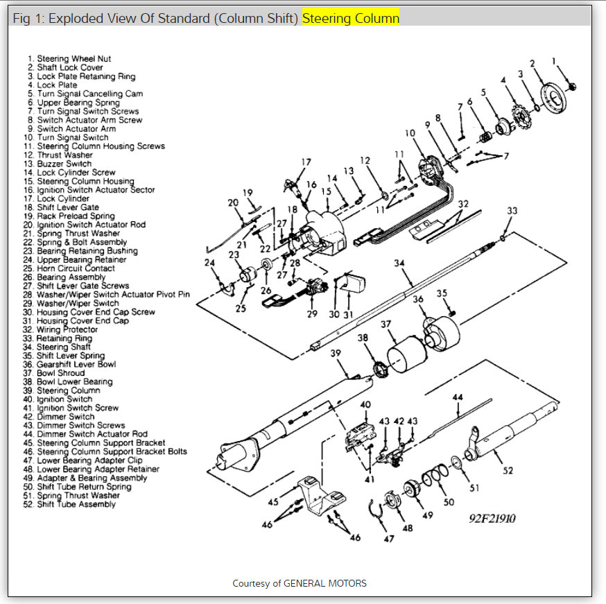

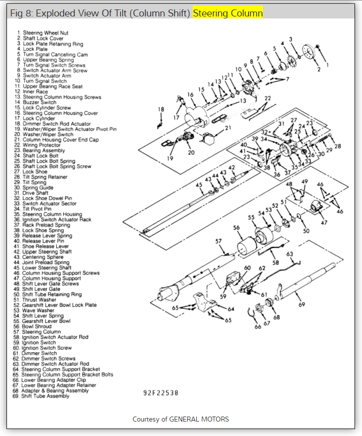

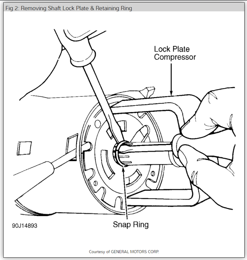

You will need to look at both especially the electrical connectors to make sure they match. here are instructions in the diagrams below to help with the repair. Check out the diagrams (below). Please let us know if you need anything else to get the problem fixed.
