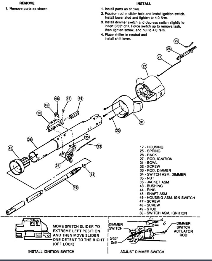

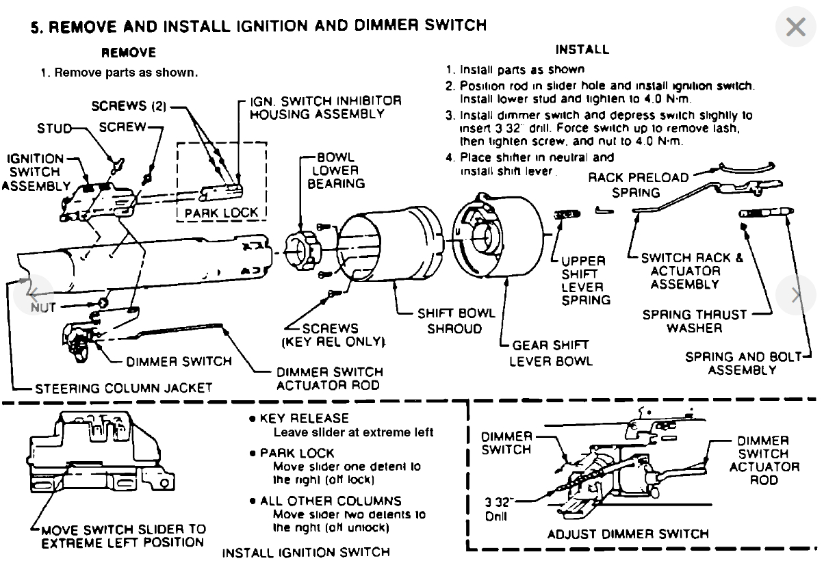

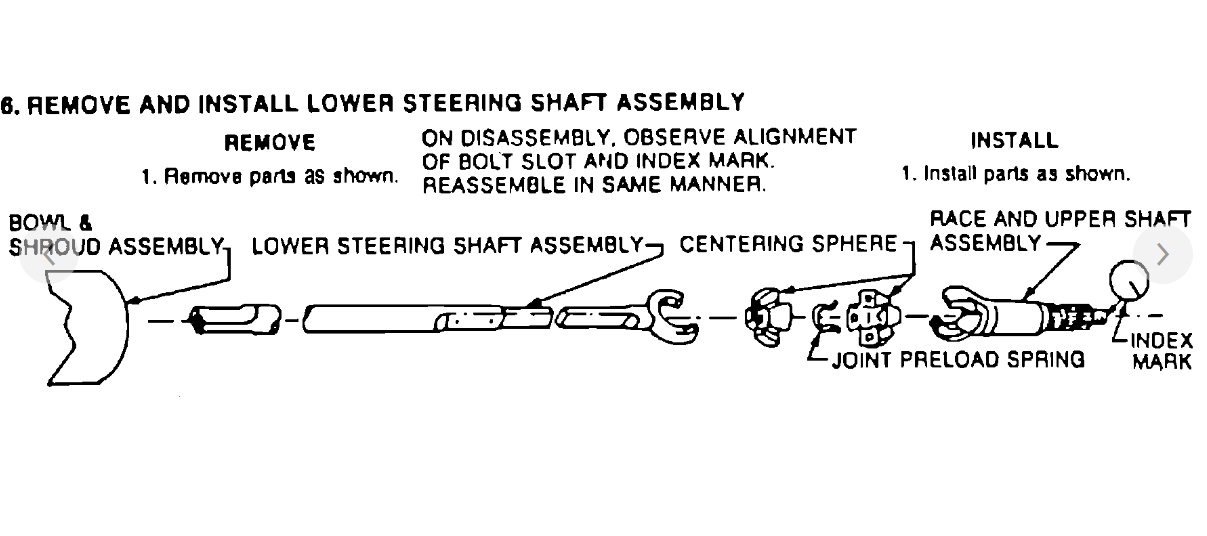

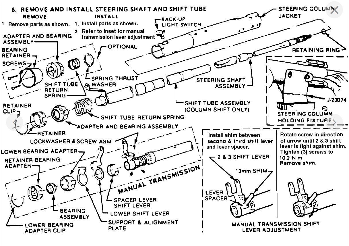

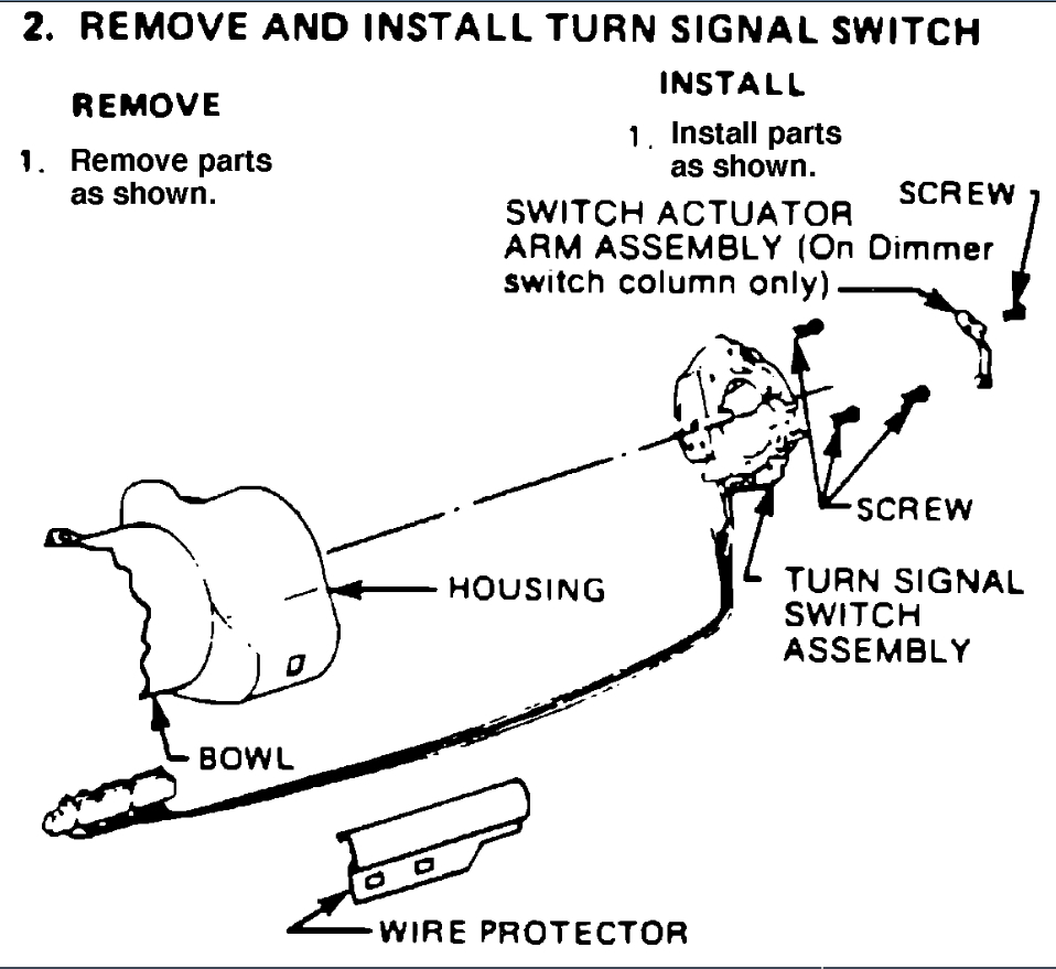

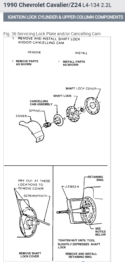

For the Cavaliers they use the same column (non-tilt) from 1990 to 1994 also the Pontiac Sunfire 1990 to 1994 uses the same steering column.
This is the OEM part number for the non-tilt column: 26003384.

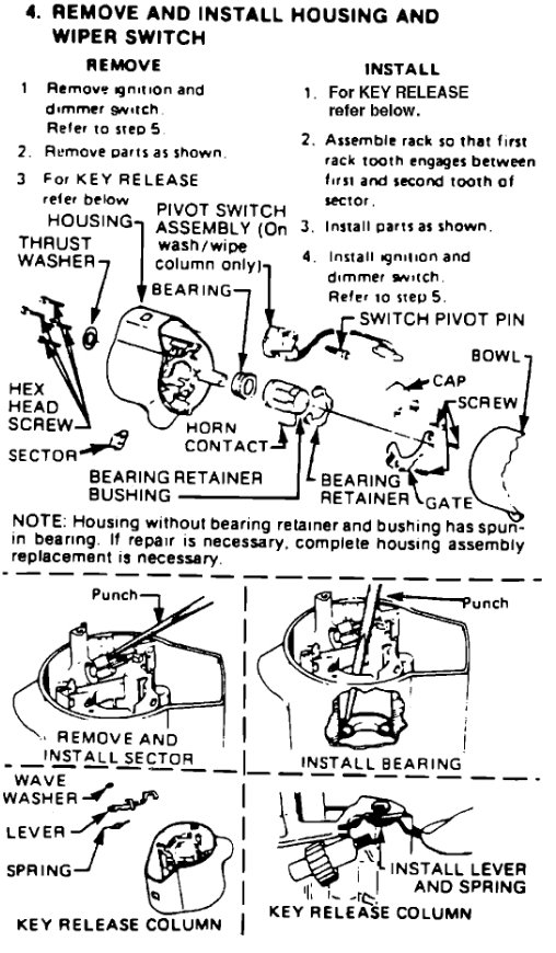

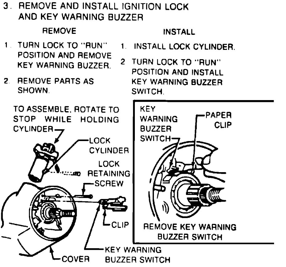

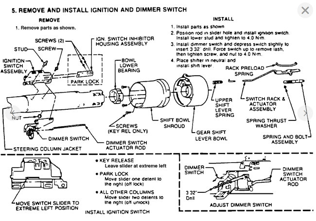

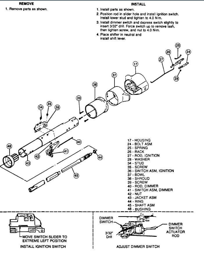

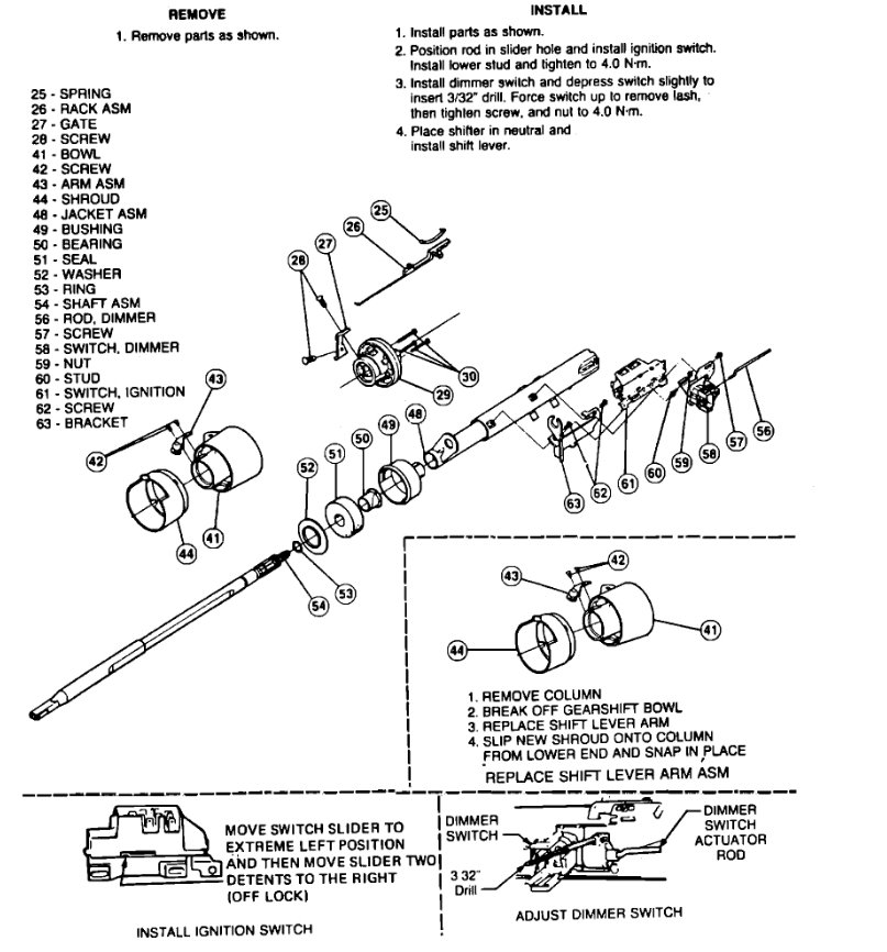

I have attached the replacement procedure below.
Let me know of any questions.
Thank you.
https://www.2carpros.com/articles/steering-wheel-removal
