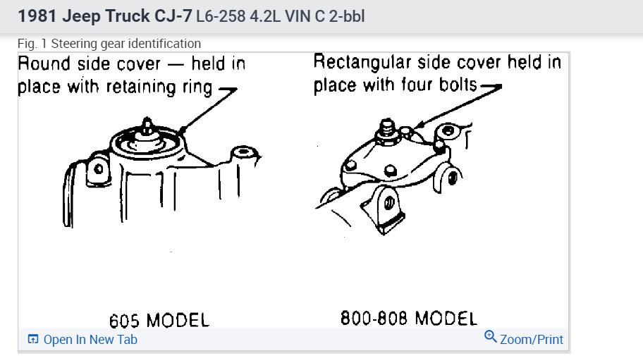

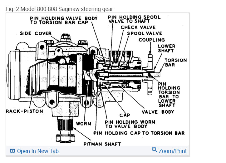

Sounds like fun! It sounds like the sector shaft valve int he steering box is not working correctly. There are two types of Saginaw integral rotary valve type single piston steering gears. The two different types of gears can be identified by the configuration of the side covers. The Model 605 gear has a round side cover, secured with a retaining ring. The Model 800-808 gear has a rectangular side cover, secured with four bolts. Also, note that the Model 800-808 gear incorporates balls in the rack piston, while the Model 605 gear does not.
The power steering gear operates entirely by displacing oil to provide hydraulic pressure assists only when turning. As the entire gear assembly is always filled with oil, all internal components of the gear are immersed in oil, making periodic lubrication unnecessary. In addition, this oil acts as a cushion to absorb road shocks that may be transmitted to the driver.
The steering shaft, hydraulic valve, worm and rack piston nut are all in line, making a compact and space saving steering gear. All oil passages are internal except the pressure and return hoses between gear and pump.

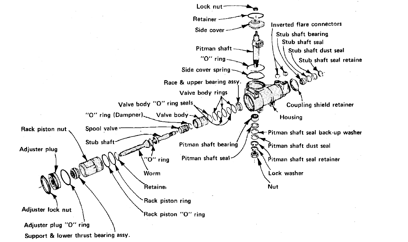

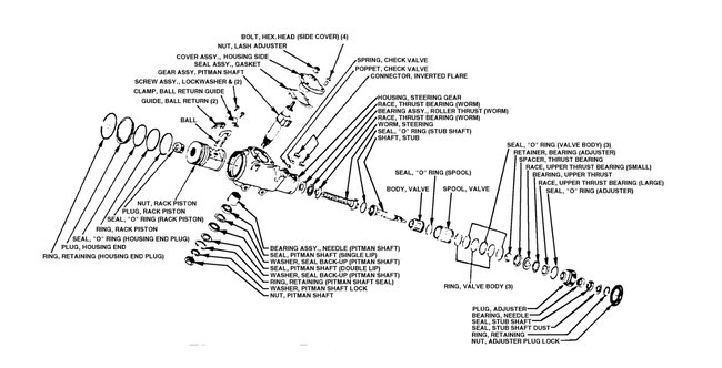

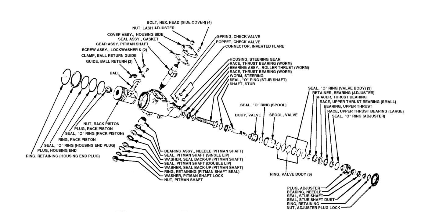

Here are exploded diagrams of the steering box below so you can disassemble the unit to see what went wrong, or you can get a rebuilt box. Check out the images (below). Please let us know what happens.
