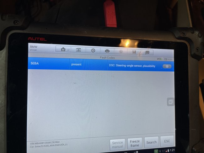

Traction light and yellow brake light are both on. Initial code was for SAS, got a used one installed it but it won't program, keeps saying maybe faulty. Codes attached.

5eba same code as before.

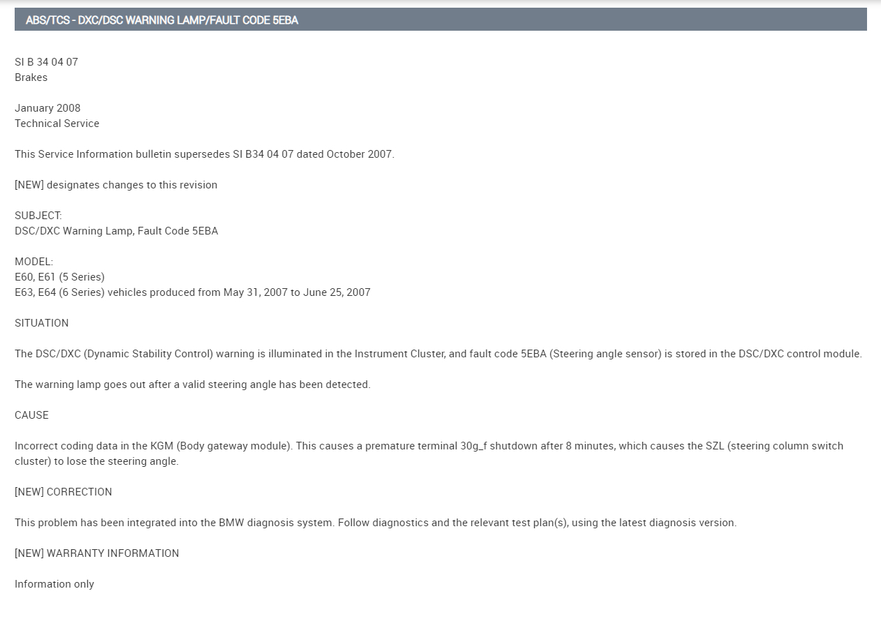

Just to add in here, there is a TSB about this issue. It's a problem with the Body Gateway module shutting down before the coding can be finished. On CAN bus systems with a Gateway, the network runs through the Gateway then out to other modules, this is what stops your reprogramming. It's not the SAS. BMW has an update in their diagnostic equipment for this is what it's saying. So, the Body Gateway Module might need to be updated by them to finish programming other modules, or just the SAS. I can see the two different procedures for setting the steering angle correctly, but the network is shutting down too quickly due to faulty coding of the other module unfortunately.

Same as before 5eba.
