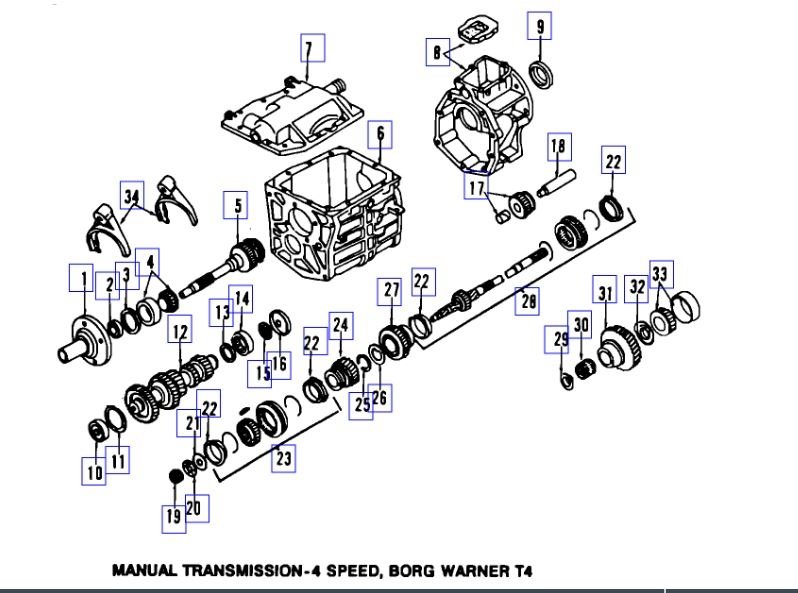

As far as the grinding, it sounds like a synchro for 3-4 is the issue. The brass ring wears out and grinds when changing.
https://www.2carpros.com/articles/how-a-standard-transmission-works
I would change the oil and inspect for any meal debris in the oil. It will look like shiny brass in the oil.

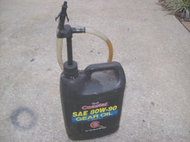

My transmission guy says you can run 80W-90 GL-5 in a T-4 or T-5,
Which is what I run in my 1977 CJ-5 T-150 transmission, Dana 20 transfer case, and both of my differentials (Nowadays, it is used instead of 90 wt, which is what I used back in the 1980's and 1990s).
I can comprehend doing this! It's a gearbox! I see no special materials in there that mine does not have.
