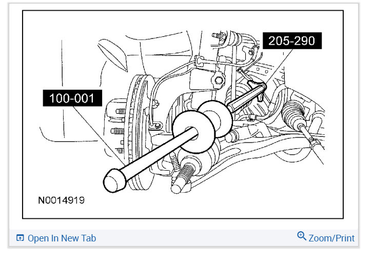

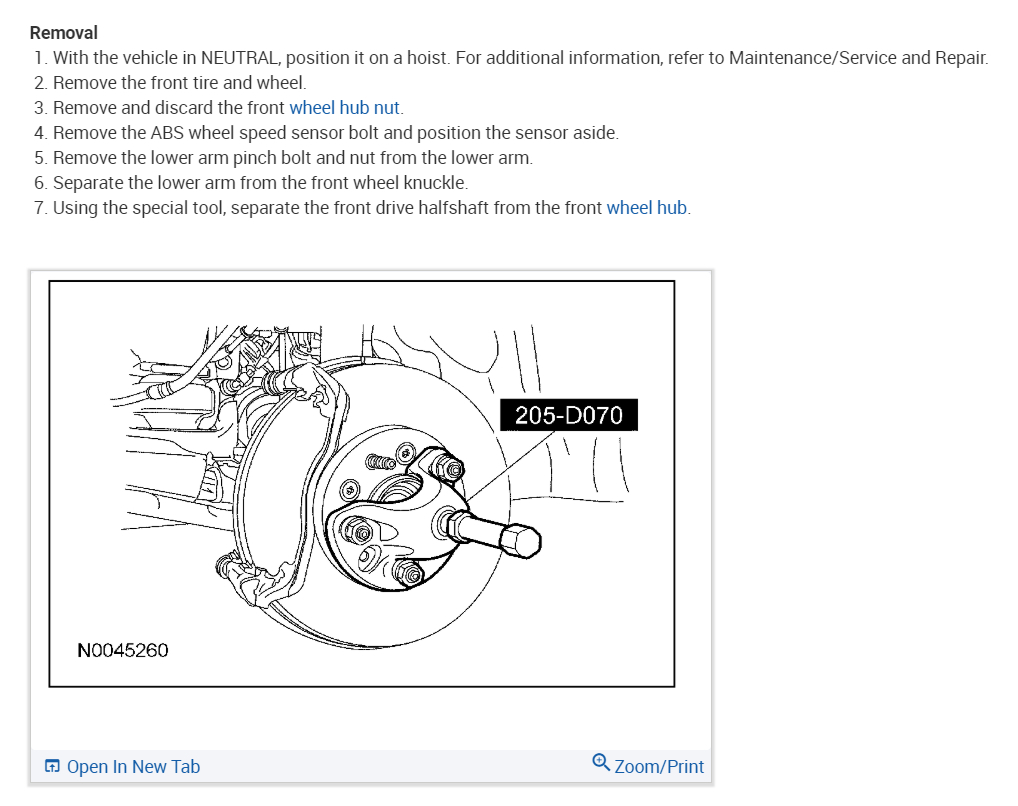

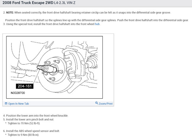

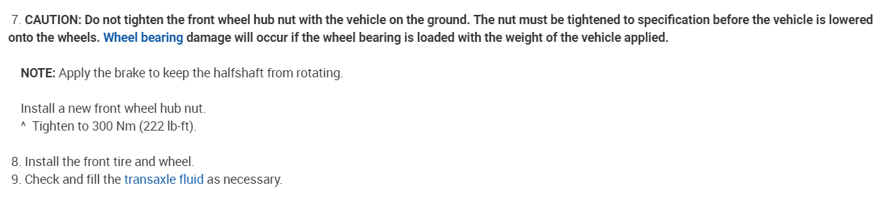

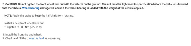

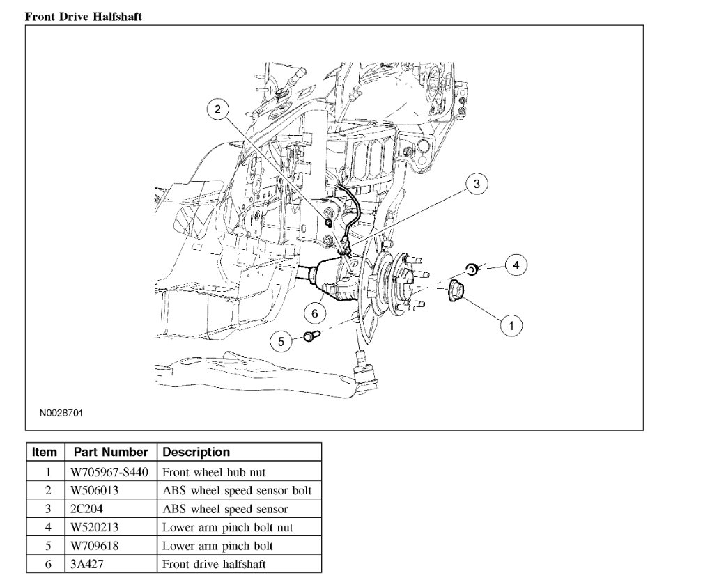

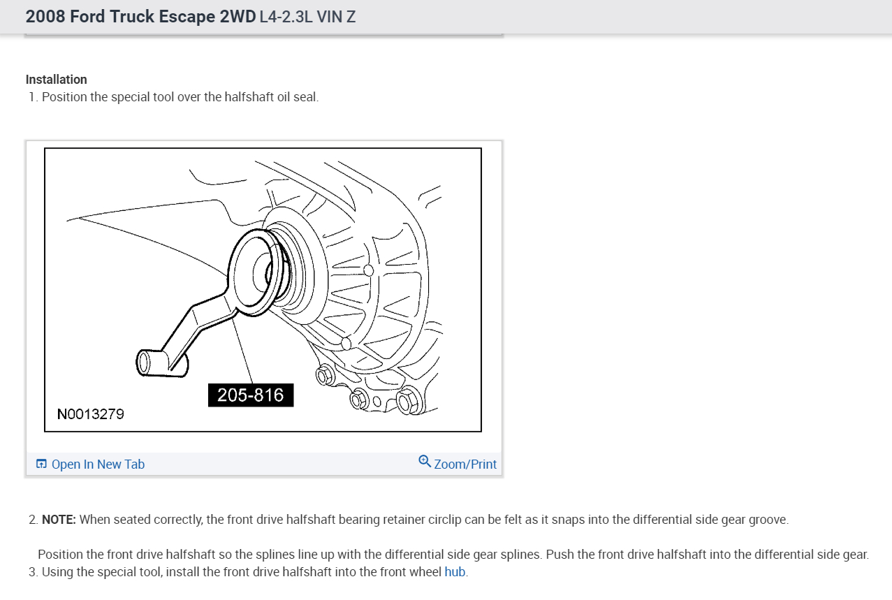

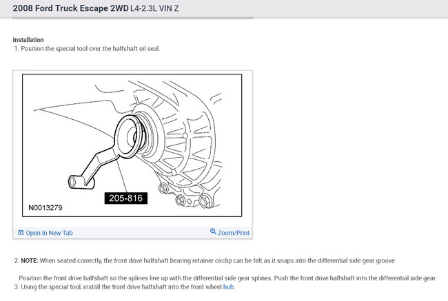

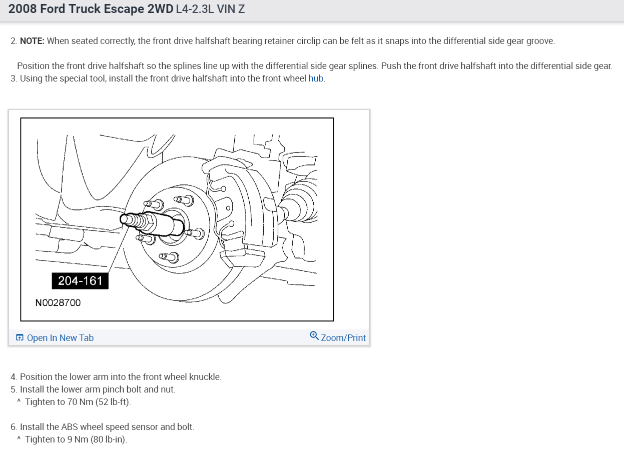

This is typical of CV axles that are worn out and need to be replaced. here is a guide to help walk you through the steps and diagrams below to show you on your car:
https://www.2carpros.com/articles/replace-cv-axle
