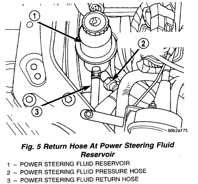

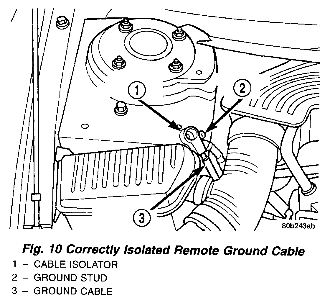

See picture 1
1. Remove the battery ground cable from the ground stud on the shock tower and isolate the ground cable by installing the cable isolator on the ground stud.
NOTE: The following step should be done to prevent excessive spilling of power steering fluid when the power steering fluid lines are removed from the power steering pump.
2. Using a siphon pump, remove as much power steering fluid as possible from the power steering fluid reservoir.
CAUTION: When removing the power steering fluid supply hose from the nipple on the power steering fluid reservoir, do not use excessive force. The will result in the nipple being broken off of the power steering fluid reservoir.

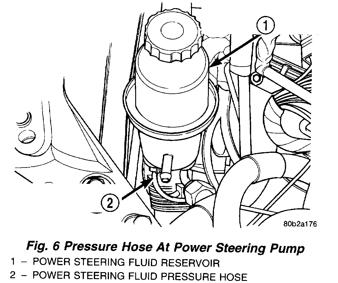

See picture 2
3. Remove the power steering fluid return hose from the power steering fluid reservoir.
4. Let power steering fluid drain from the power steering fluid reservoir and power steering pump.
5. Install a cap on the open nipple of the power steering fluid reservoir to prevent power steering fluid from spilling when removing the power steering pump.

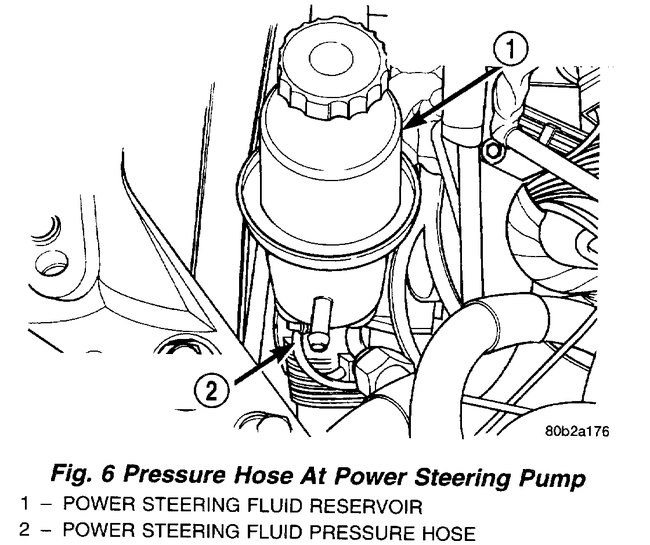

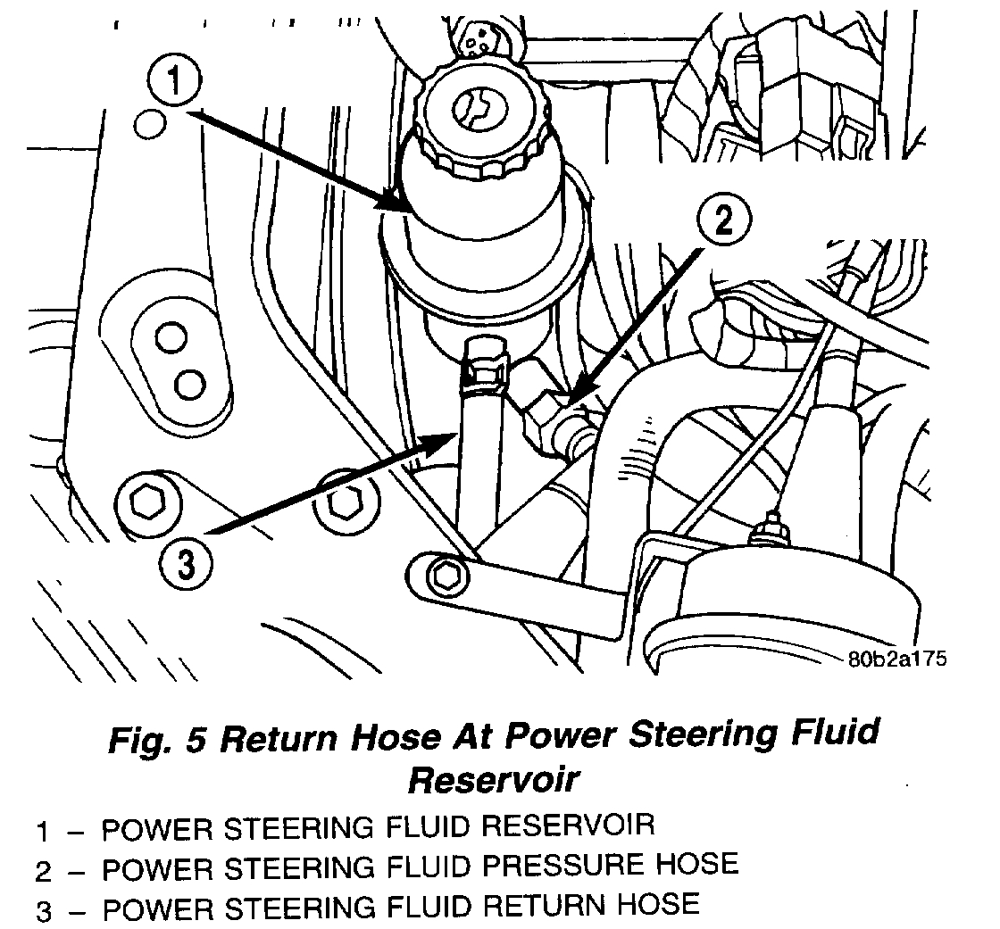

See picture 3
6. Remove the power steering fluid pressure hose from the pressure fitting on the power steering pump.
7. Let remaining power steering fluid drain from the power steering pump.

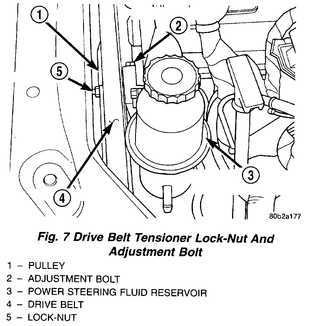

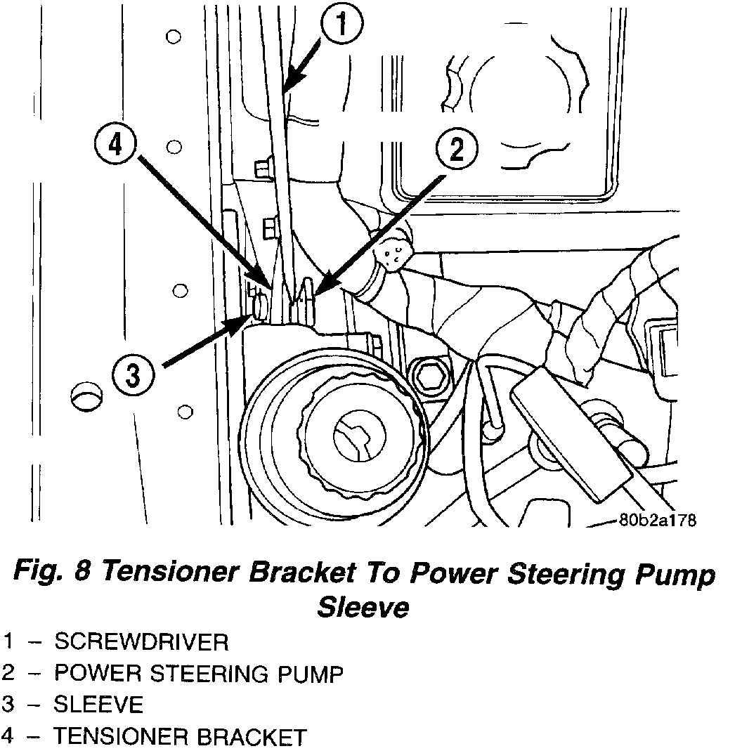

See picture 4
8. Loosen the lock-nut on the front of the pulley for the serpentine drive belt tensioner.
9. Using the adjustment bolt remove the tension from the drive belt for the power steering pump.
10. Remove the drive belt from the power steering pump pulley.
NOTE: Access for the power steering pump mounting bolts is through the holes in the face of the power steering pump pulley.
11. Remove the 3 bolts attaching the power steering pump to the power steering pump mounting bracket.

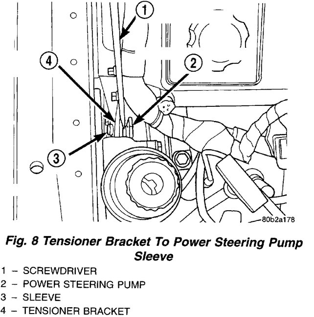

See picture 5
12. Insert a screwdriver between the power steering pump and the sleeve in the tensioner bracket. Using the screwdriver push the sleeve forward in the tensioner bracket until it is flush with the back side of the tensioner bracket.
13. Remove the power steering pump, power steering fluid reservoir and pulley as an assembly from the engine. Power steering pump is removed from the top of the engine.

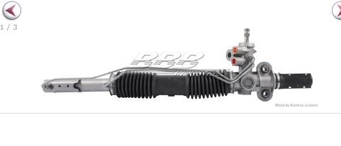

lines are different sizes can not be switched rack is not new just the bearings in it. Could it be electrical?
Jan 20, 2019 at 9:45 PM
No, it most likely is a failed rack. You will need to remove it and replace it.
