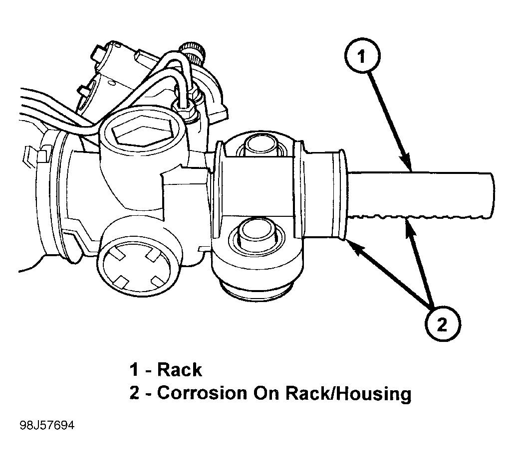

let us know what you find. It may be something to do with the steering rack.
Oct 9, 2016 at 8:56 PM
AL514
  • 5,465 POSTS
there is a technical service bulletin on corrosion on the end of the steering rack.
