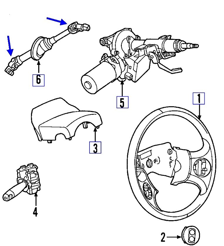

Both conditions can be caused by a worn universal joint in the steering shaft. The drawing below shows two joints to inspect. Watch each one while a helper moves the steering wheel back and forth. Let me know what you find.

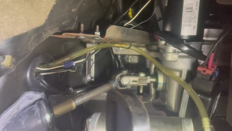

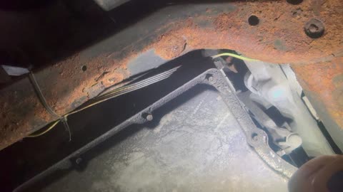

Both u joints appear to be intact, also noticed no movement or play while grabbing ahold of inside and outside of the car and shaking vigorously.
While not the clearest image of the joint connecting to the rack and pinion, both show free movement with no binding while turning the steering wheel stop to stop.
Any other suggestions?
