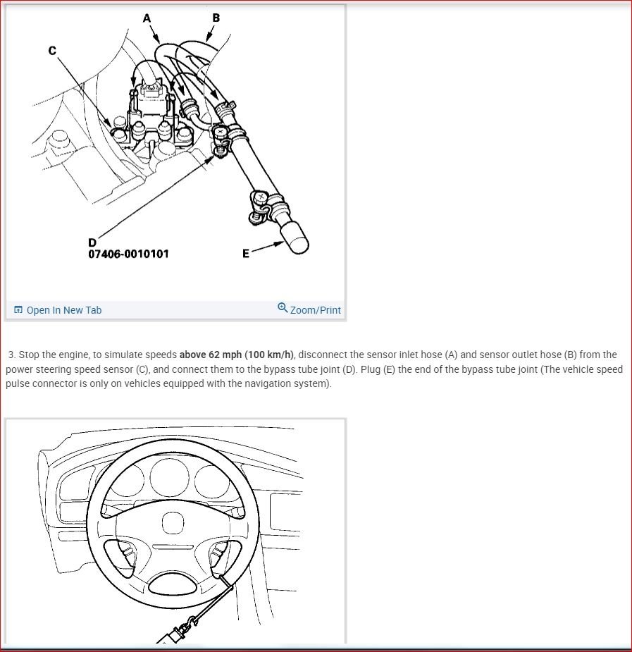

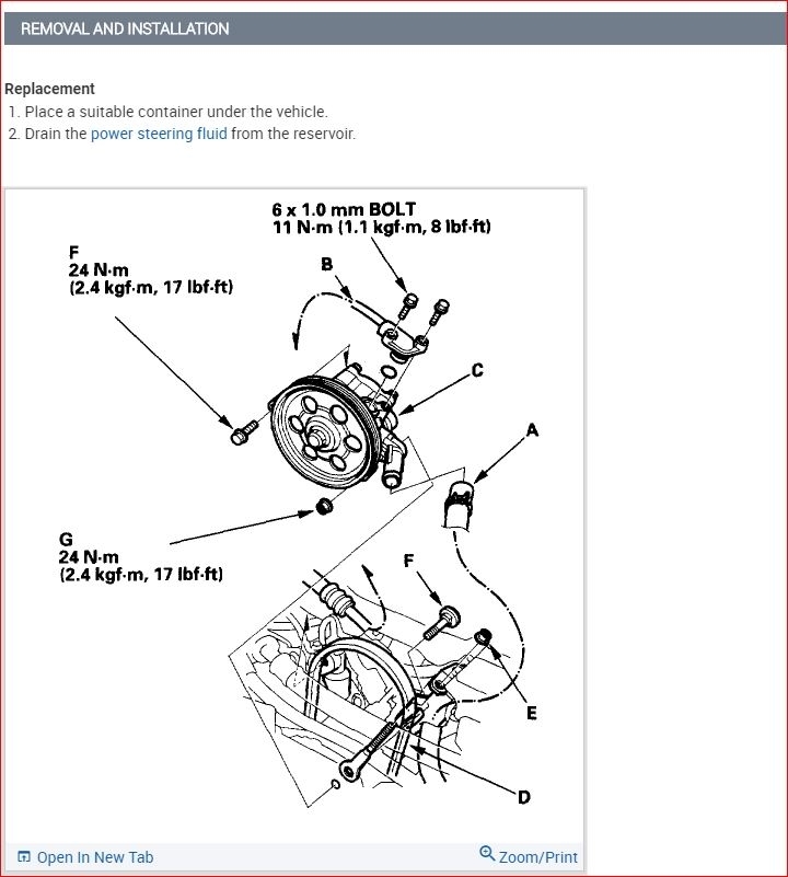

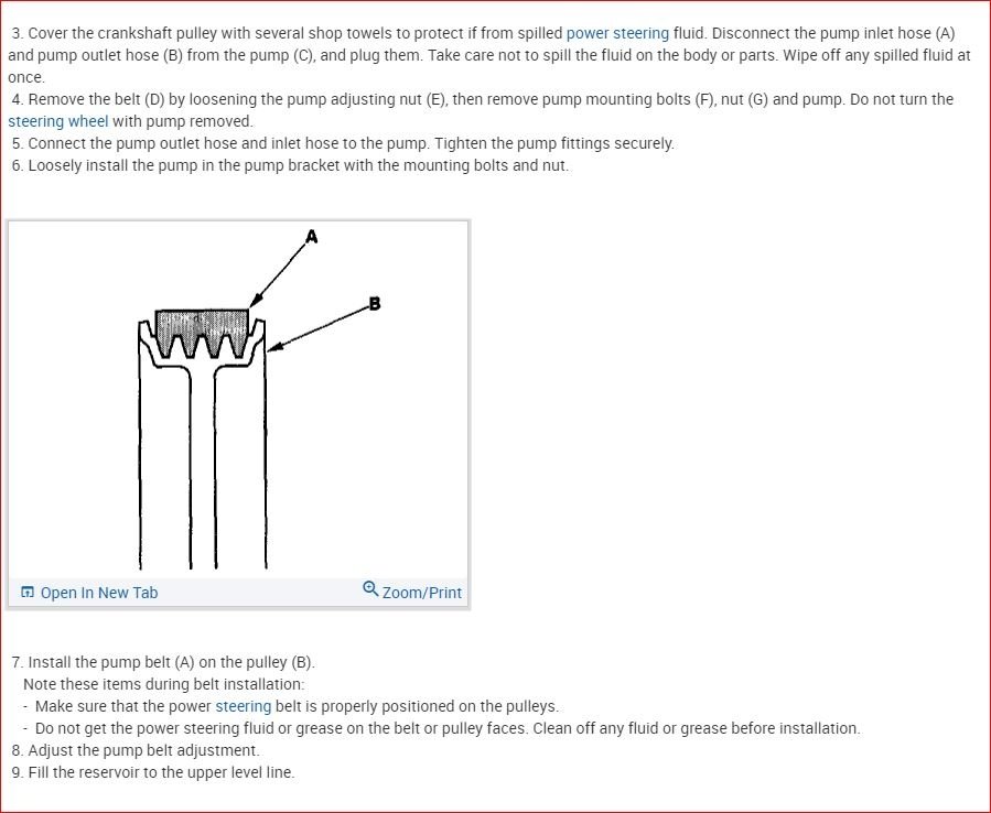

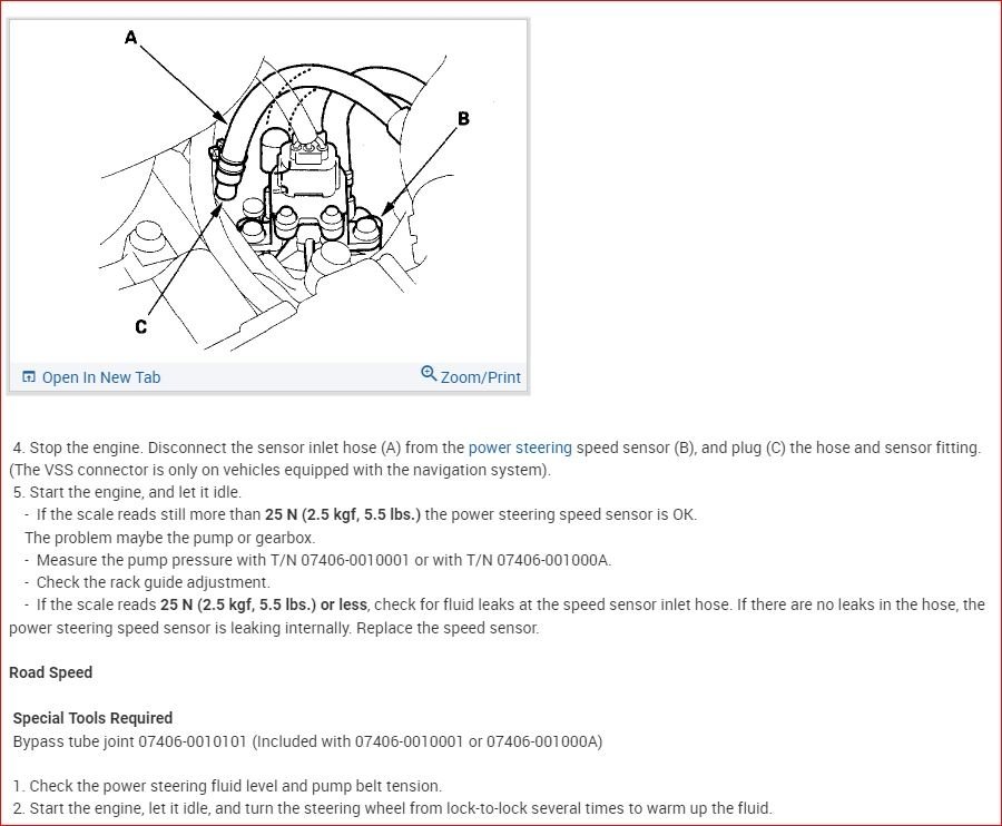

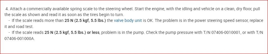

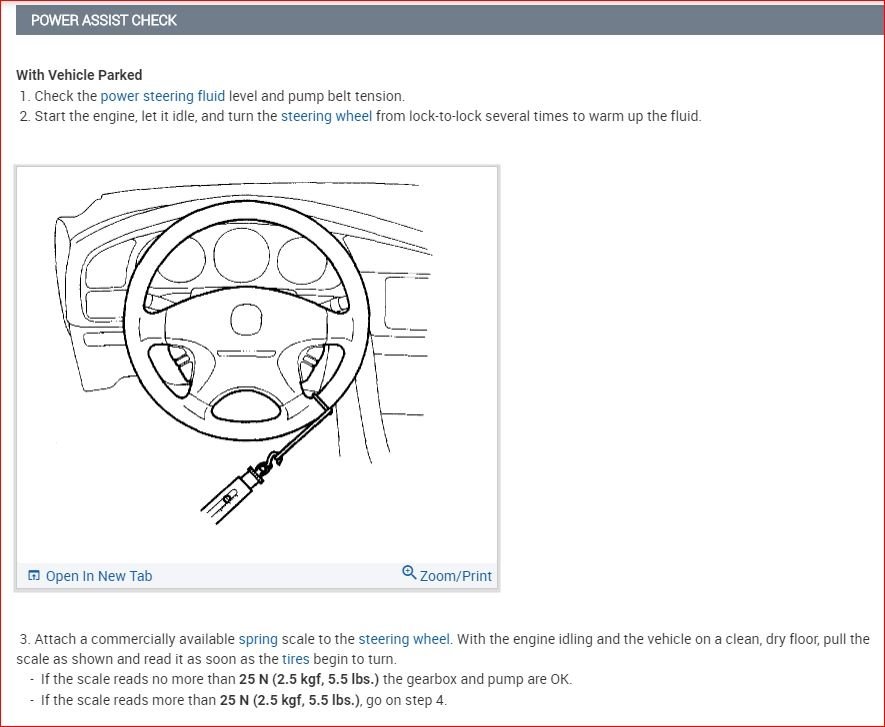

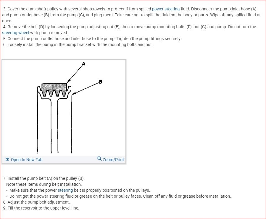

Sounds like the power steering pump has failed. There could be other components but this is the most likely cause.
I attached the process of testing the power steering system and the procedure of replacing the pump.
Please let me know if you have questions. I will be happy to assist any way I can. Thanks.
