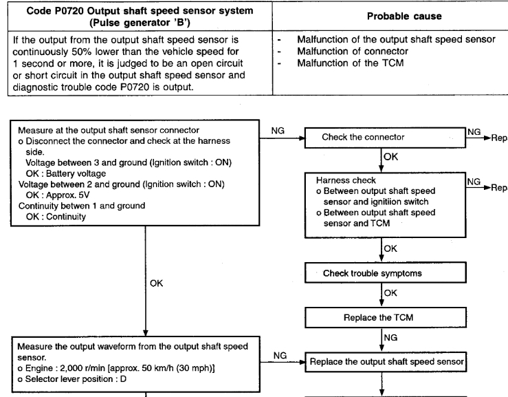

The codes are related to both the transmission and a camshaft position sensor. The P0340 is the CMP sensor code.
As far as the P1529, that only indicates the transmission control module has requested the check engine light on. The P0720 is specific to the output speed sensor on the transmission and can cause it to go into limp mode.

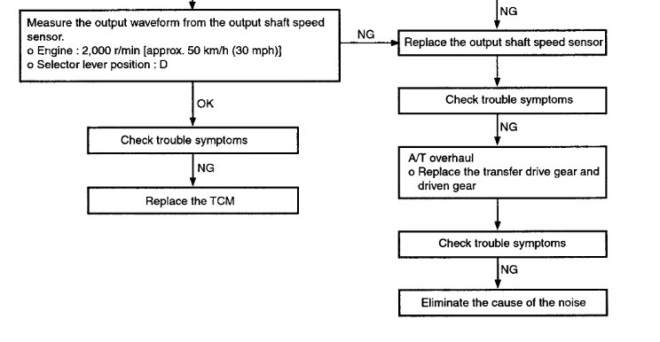

I attached the diagnostics below. Take a look through them and let me know if you are comfortable performing them.
See pics below.
Apr 11, 2024 at 7:46 PM
DANGELL73
Thank you so much for your wonderful advice. I did replace the output speed sensor and it definitely 100% fixed the problem.
