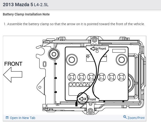

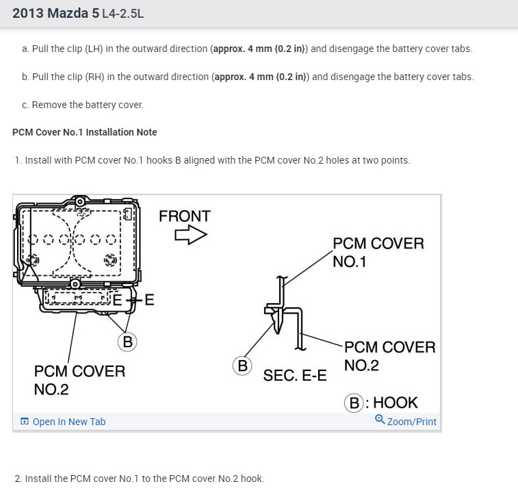

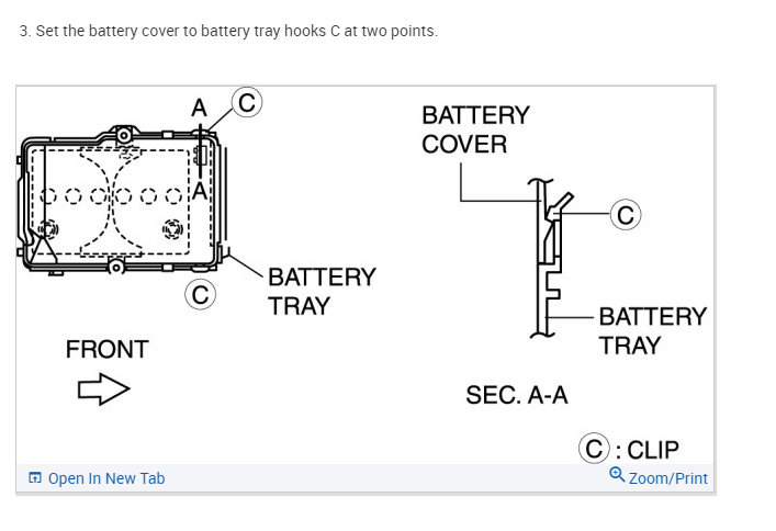

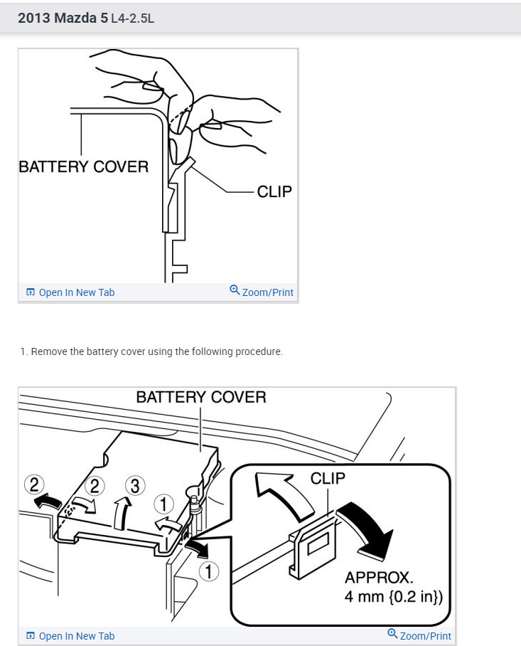

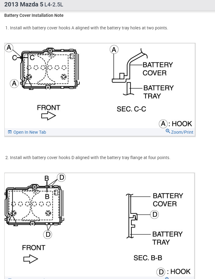

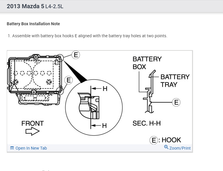

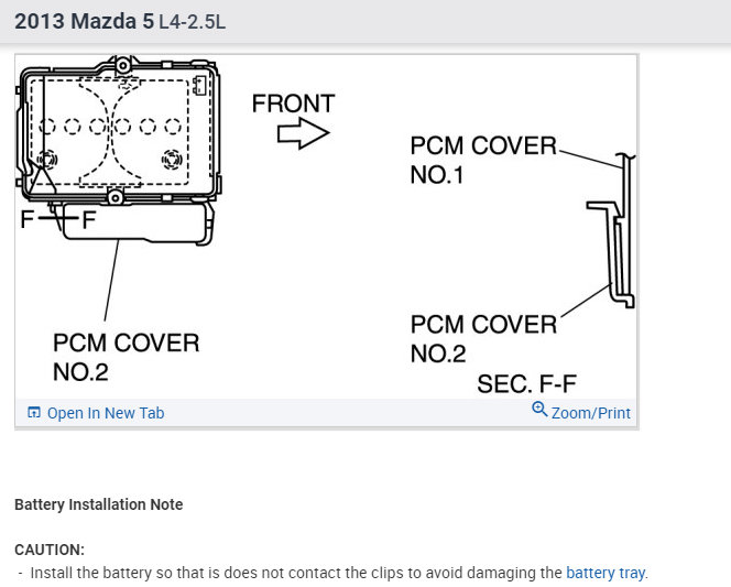

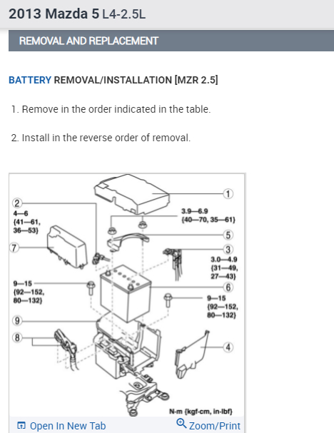

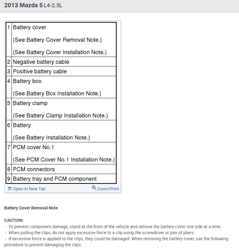

Check out the diagrams (below). Please let us know if you need anything else to get the problem fixed. Thank you.
