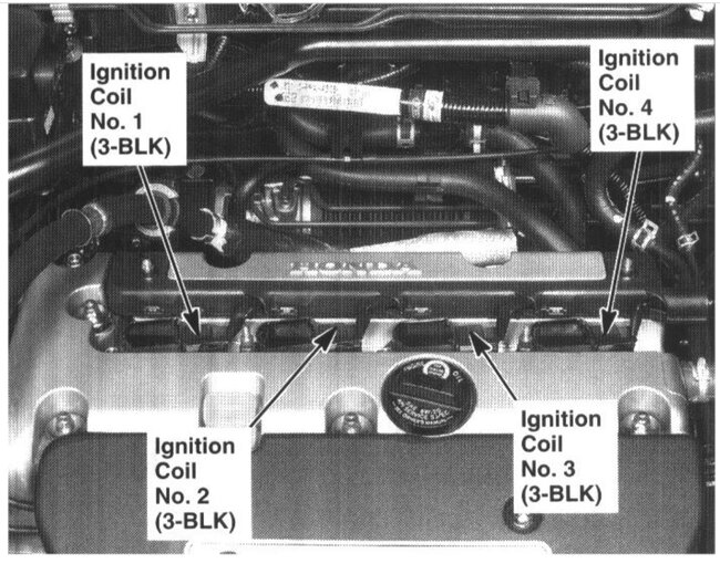

This happens when the ignition coils get wet. I would remove the coils and dry them out here are instructions to help you. Also, if the engine has not been tuned up this will help as well, please go over this guide:
https://www.2carpros.com/articles/how-to-tune-up-a-car-engine
Spark plug .................... NGK: IZFR6K-11 DENSO: SKJ20DR-M11
Gap .................... 1.0 - 1.1 mm (0.039 - 0.043 in)
Torque .................... 18 N.m (13 lb.ft)
Check out the images (below). Let us know how it goes.
