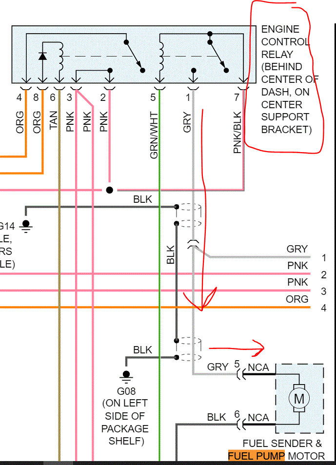

First, I attached a pic of the relay that powers the fuel pump. It is referred to as the Engine Control Relay. See pic 1. It shows location.
Next, take a look through these two links and let me know if you feel what you experience could mirror what is discussed in link 2 (symptoms).
