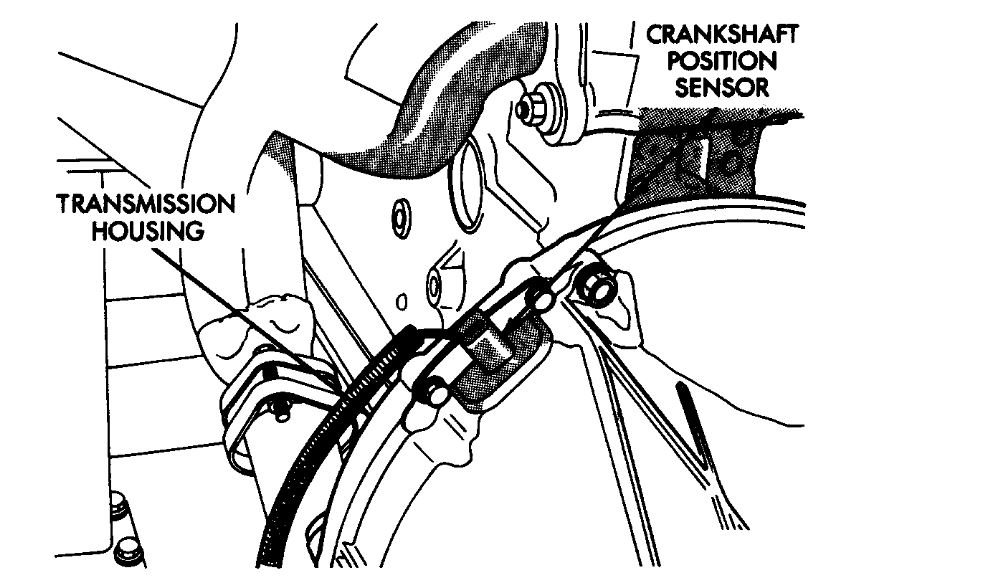

A very common issue is the crank sensor. It is located on the bell housing upper left side.
When this fails there will be no spark.
You can get it at any parts store.
Aug 17, 2018 at 4:54 PM (Merged)
