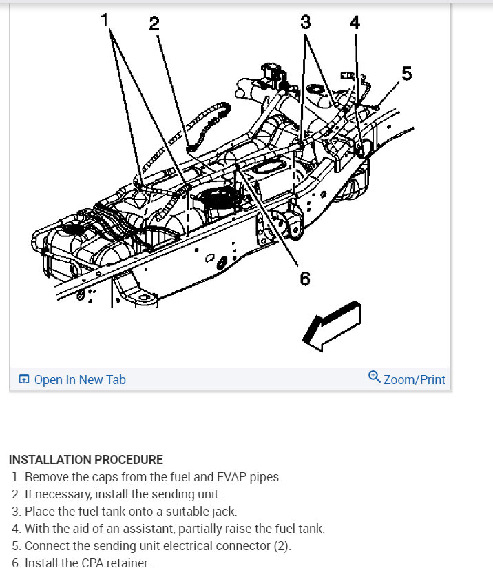

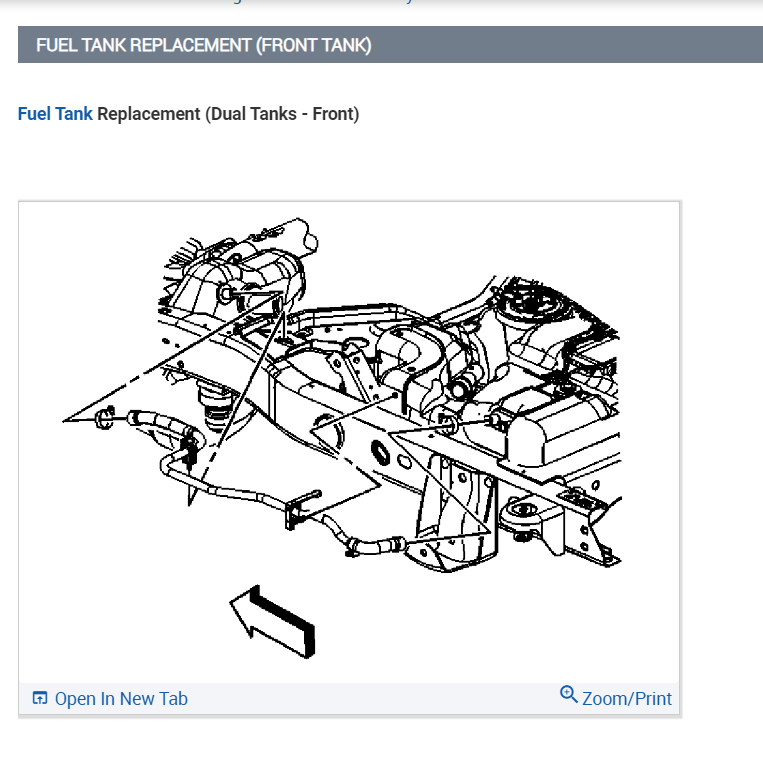

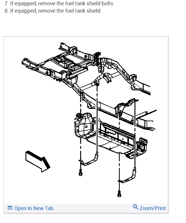

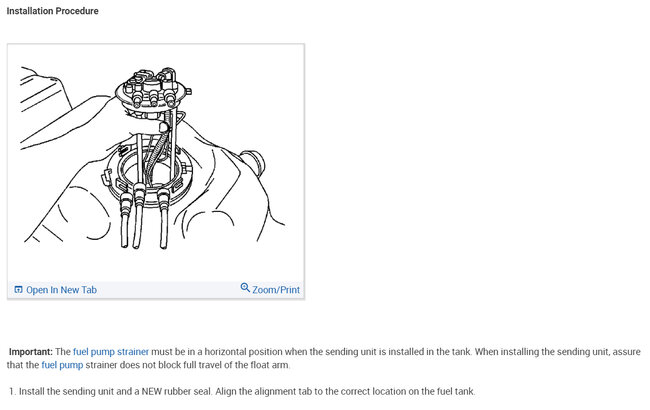

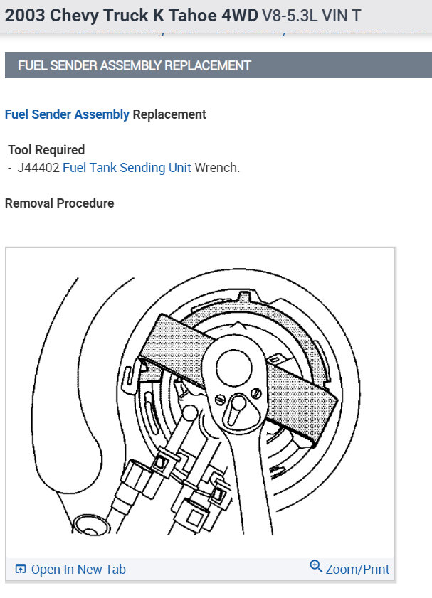

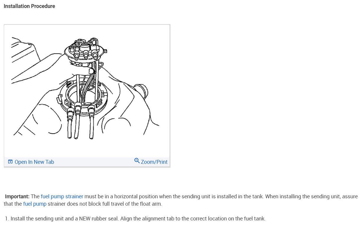

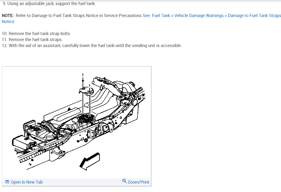

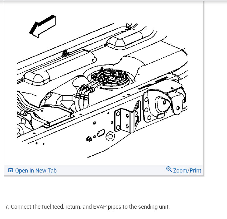

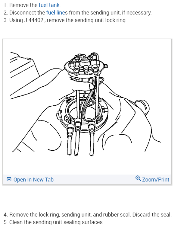

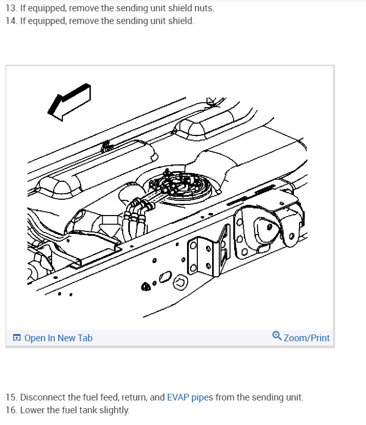

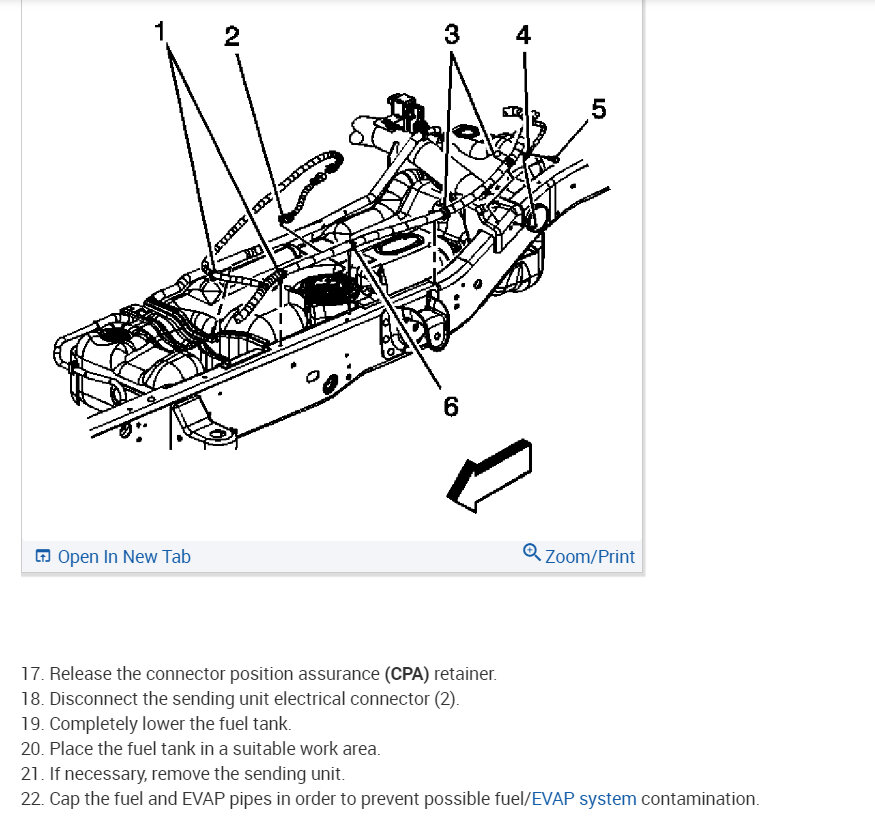

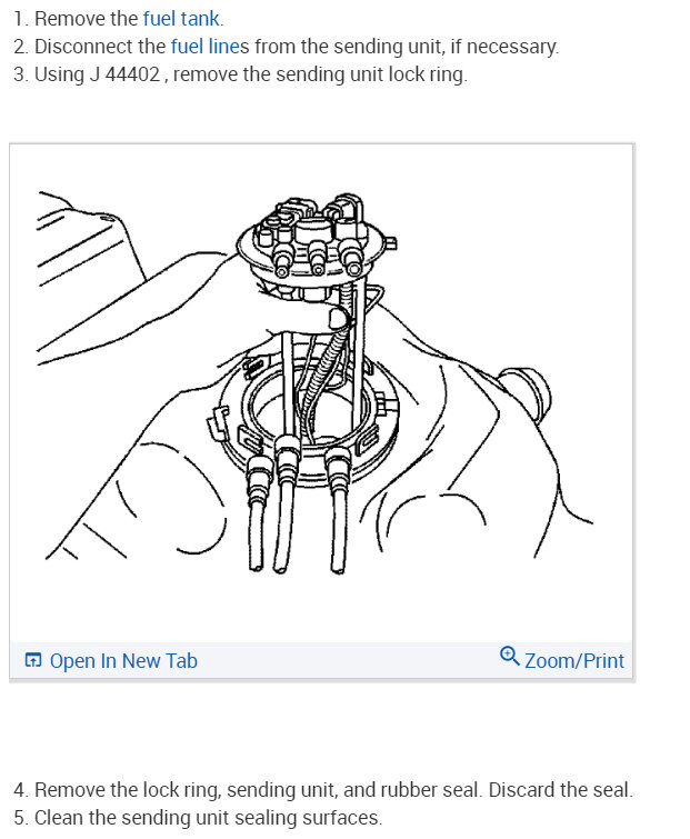

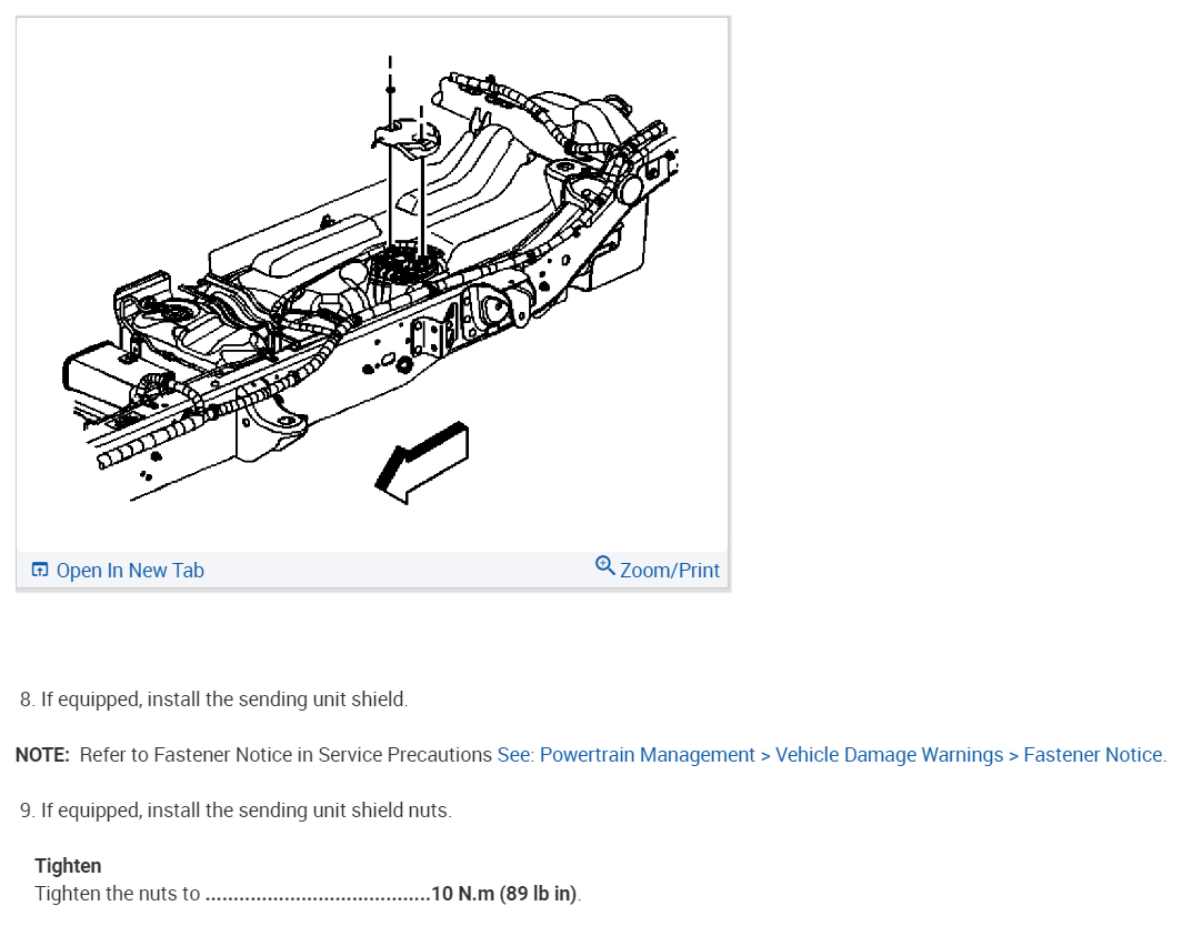

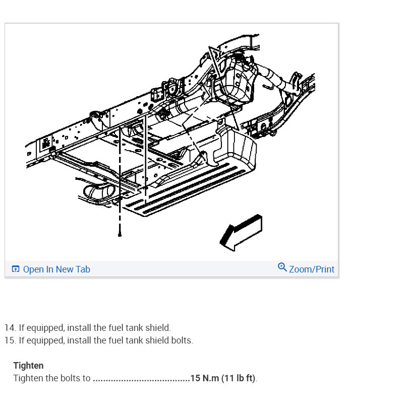

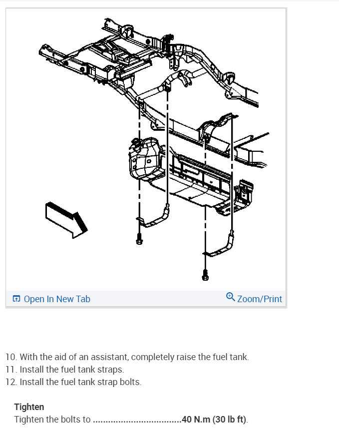

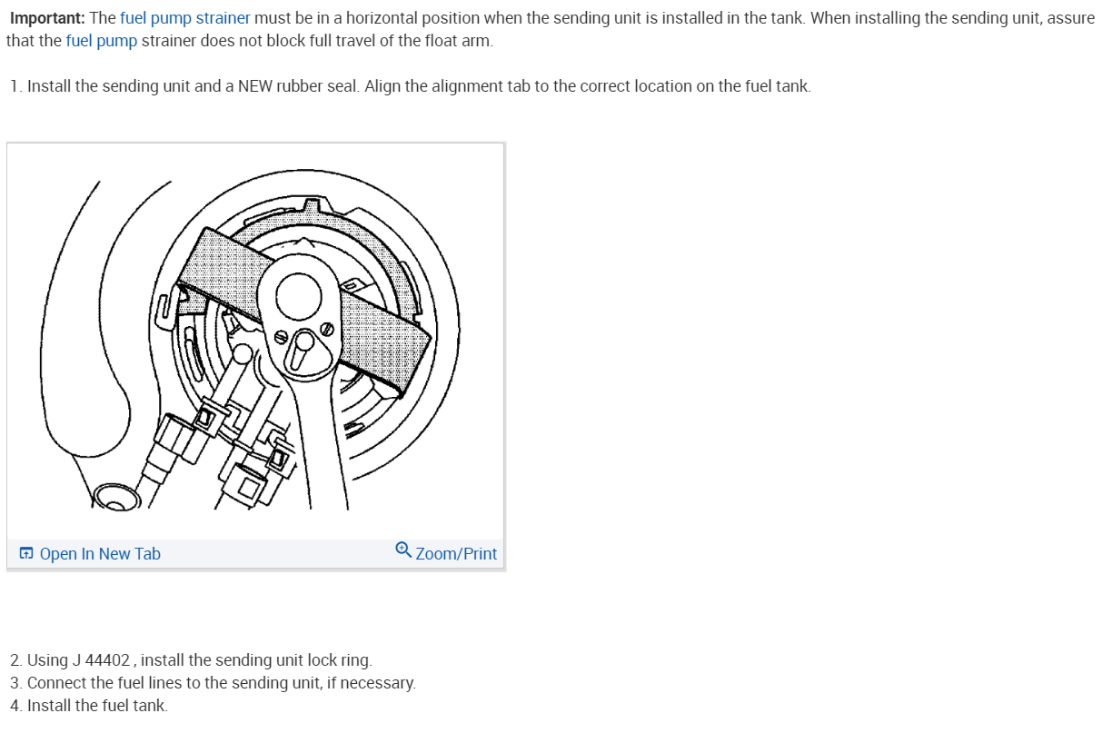

Yep, I agree with HMAC300, it sounds like the fuel pressure is low because the fuel pump is going out which is common for these trucks. Please go over this guide which shows out how to check the pressure and I have included how to change the pump out in the images below as well.
Drain the fuel first.
