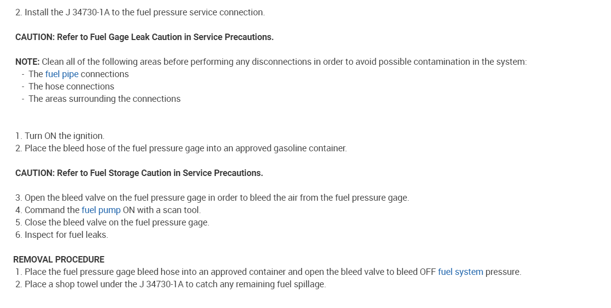

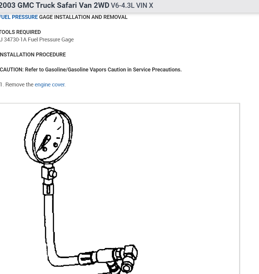

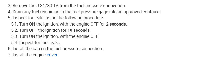

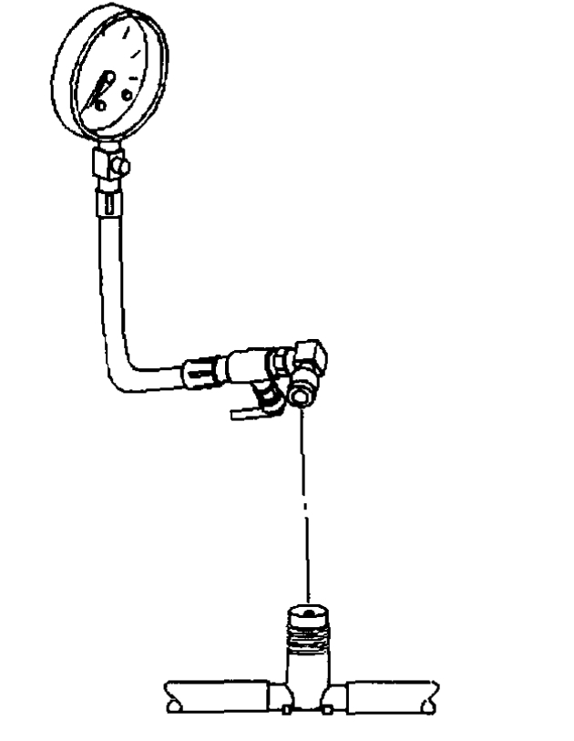

I have seen a weak fuel pump cause this issue, but to be sure let's do a fuel pressure test. here is a guide to help with the instruction for your car and how to replace the fuel pump in the images below:
Fuel System Pressure (w/fuel pump running) .................... 379 - 427 kPa (55 - 62 PSI)
Fuel System Pressure (after fuel pump shuts off) .................... 34 kPa (5 PSI)
Fuel System Pressure Drop (after 5 minutes) .................... 14 kPa (2 PSI)
You can rent a fuel pressure gauge for cheap at the local auto parts store. Check out the images (below). Please let us know what happens.
