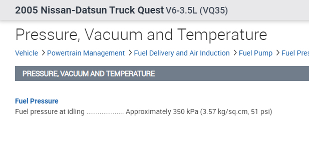

Based on your description, it sounds like the fuel pump may be failing. With that in mind, I would start by checking the fuel pump pressure. You will need a fuel pressure gauge for this, but most parts stores will lend one to you.
Here is a link that explains in general how to test it:
If you look below, I attached the manufacturer's fuel pressure specifications for this vehicle.
Let me know if this helps and what you find.
See pic below.
