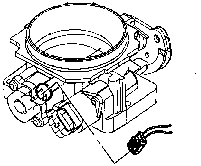

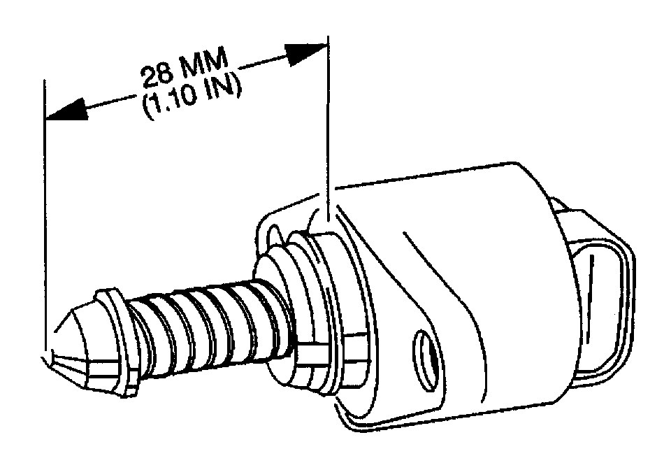

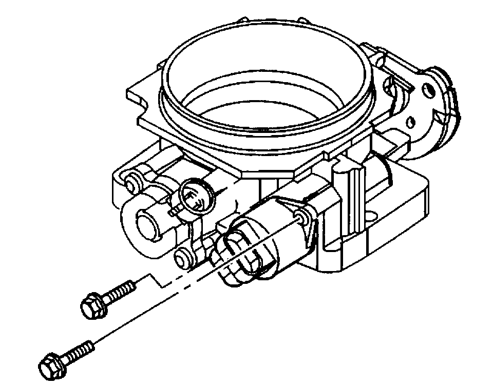

This could be the result of a few different things. First, check to see if there are any engine vacuum leaks. Here is a link that shows how to check:
Next, the idle air control valve (IAC) is responsible for maintaining engine idle speed. It is located on the throttle body. I attached two pics below (pics 1 and 2) showing the location. The IAC allows a metered amount of air enter the engine when the throttle plate is closed. So, if it is not functioning or is clogged with carbon, it will cause a problem

1996 Chevy Truck C 1500 Truck 2WD V8-5.7L VIN R
Idle Air Control (IAC) Valve Replacement
Vehicle Powertrain Management Fuel Delivery and Air Induction Idle Speed/Throttle Actuator - Electronic Service and Repair Procedures Idle Air Control (IAC) Valve Replacement
IDLE AIR CONTROL (IAC) VALVE REPLACEMENT

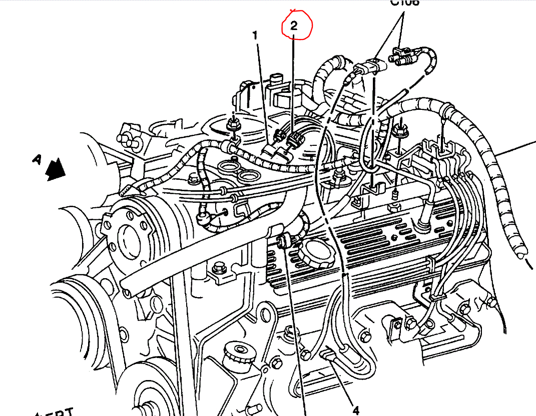

Throttle Position Sensor Electrical Connector
pic 3
pic 4
pic 5
pic 6

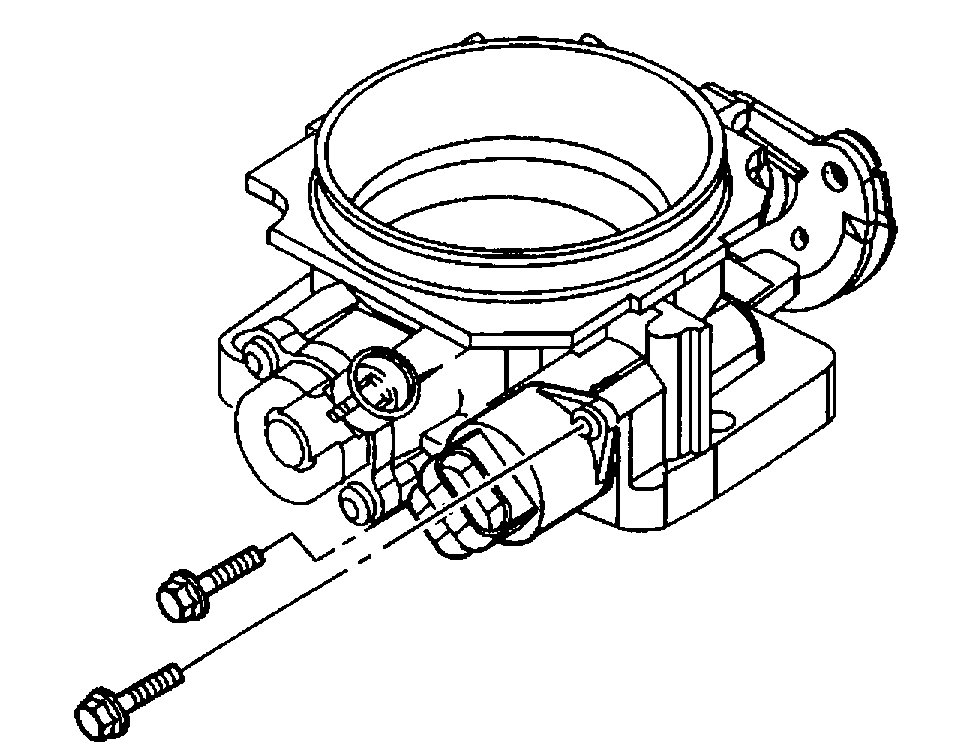

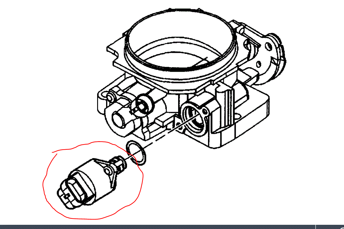

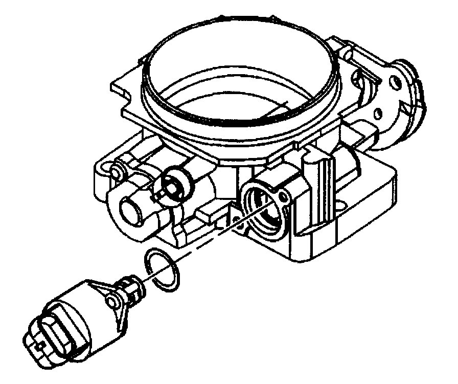

REMOVAL PROCEDURE
1. Remove the electrical connector from the Idle Air Control (IAC) valve
2. Remove the IAC valve attaching screws.
CAUTION: If the IAC valve has been in service: DO NOT push or pull on the IAC valve pintle. The force required to move the pintle may damage the threads on the worm drive. Also, DO NOT soak the IAC valve in any liquid cleaner or solvent, as damage may result.
3. Remove the IAC valve assembly.
4. Remove the O-ring.

3. Measure the distance A between tip of IAC valve pintle and mounting flange. If greater than 28 mm, use finger pressure in order to slowly retract the pintle. The force required to retract the pintle of a new valve will not cause damage to the valve.
