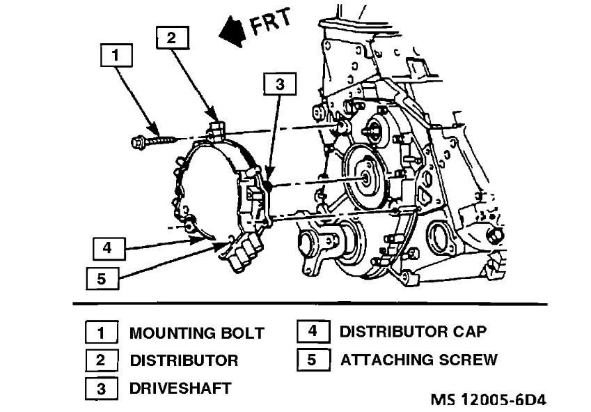

I would also check the distributor. Common for the cap and rotor to get wet and cause this type of issue.

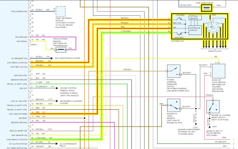

This does sound like you are losing spark.
Can you test the power to the distributor with the key on? I am wondering if you have power in the start position and not in the run position.
Do you have a scope that can monitor the signal from the distributor to the ECM?
