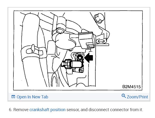

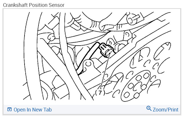

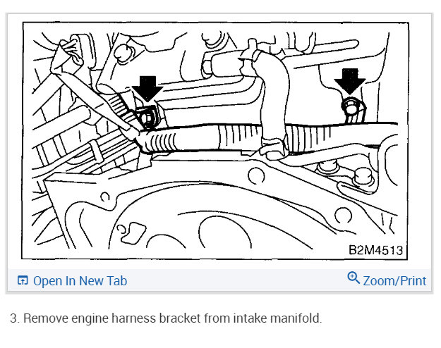

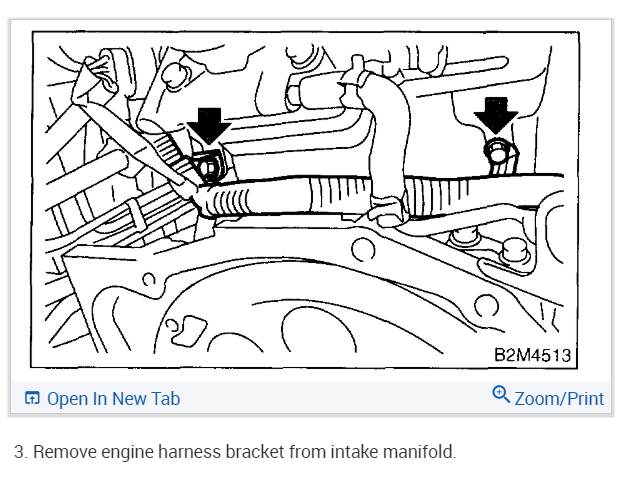

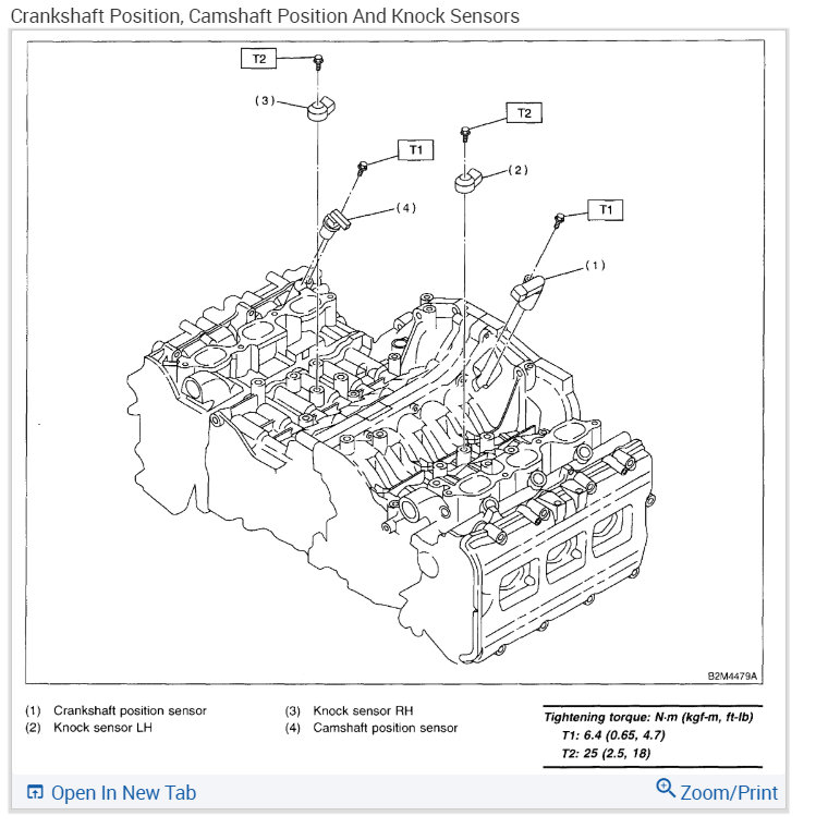

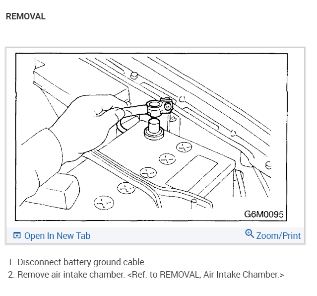

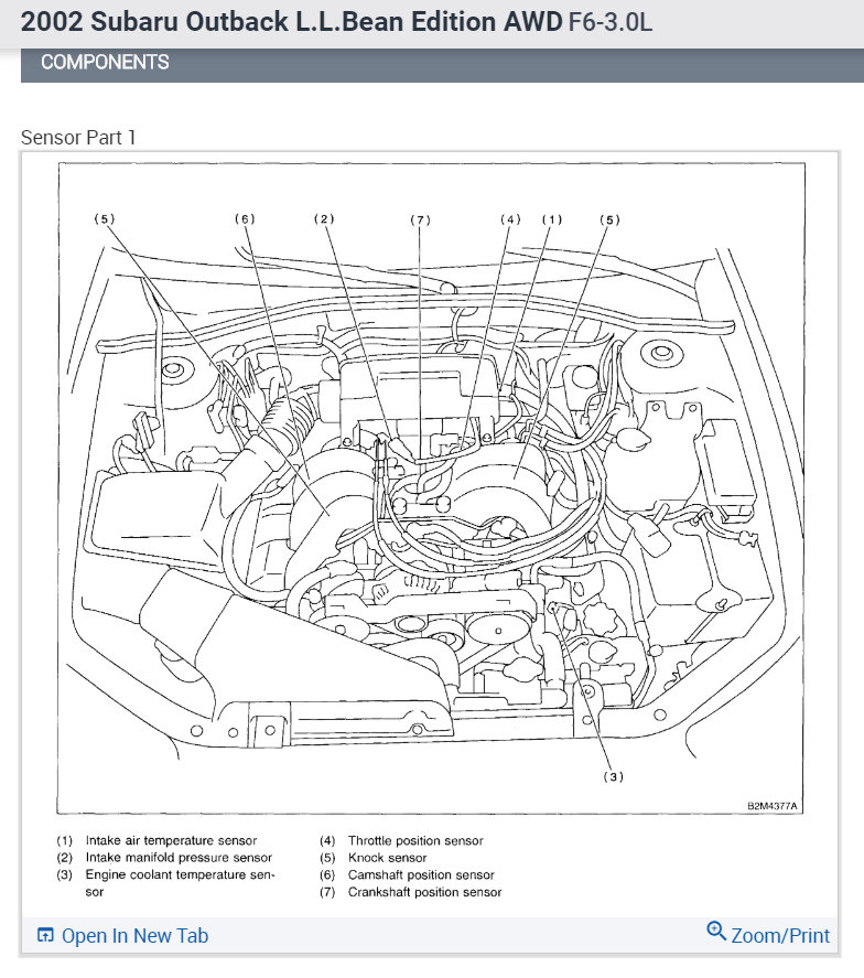

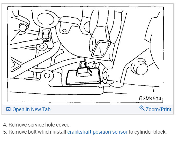

on the 2002 Subaru Outback 3.0 the crank senor is it located on top of the bell housing because it`s not under alternator?
Nov 22, 2019 at 4:38 PM

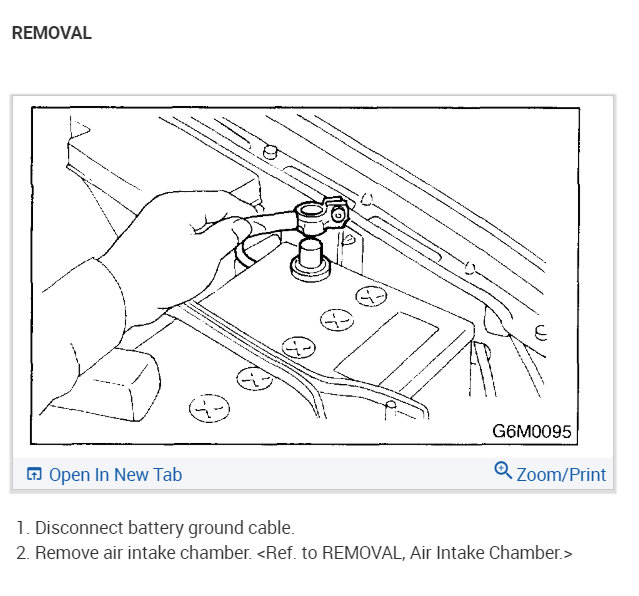

Here is the location of the crankshaft sensor and the instructions on how to replace it in the diagrams below. Check out the diagrams (below). Please let us know what happens.
