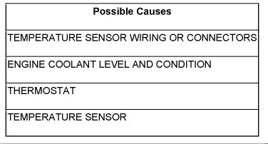

Picture 1 is that of possible causes for the codes: Note that it indicates coolant temp sensor or sensor wiring.

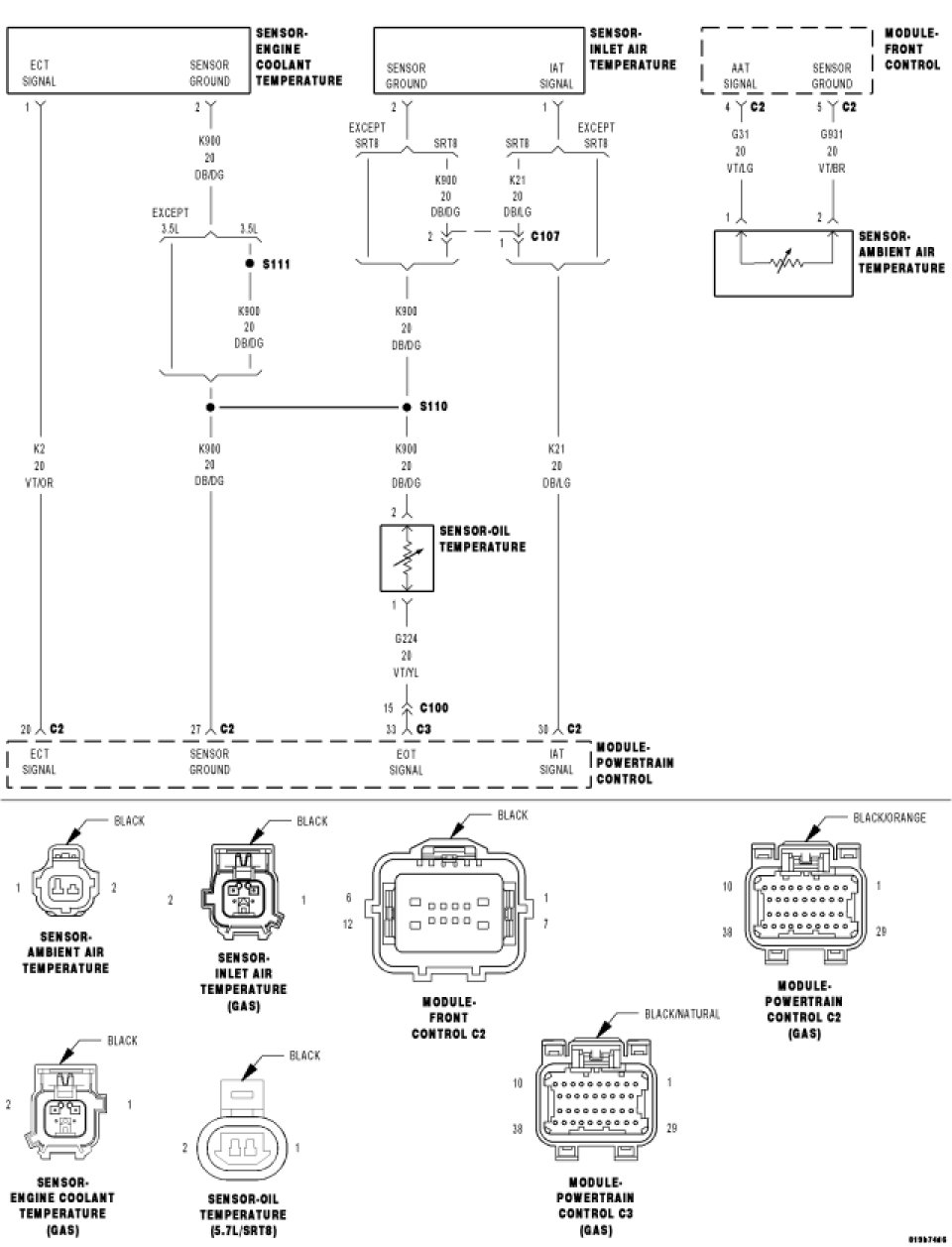

With that being said, I would recommend that you scan the computer and collect real time data. Go to the coolant temperature sensor and see what it is actually telling the computer. If it is 80 degrees F where you are and the computer thinks it is -40 degrees, the fuel mixture will be too rich for the engine to run or run properly. Additionally, I have attached a wiring schematic of these components for your review.
