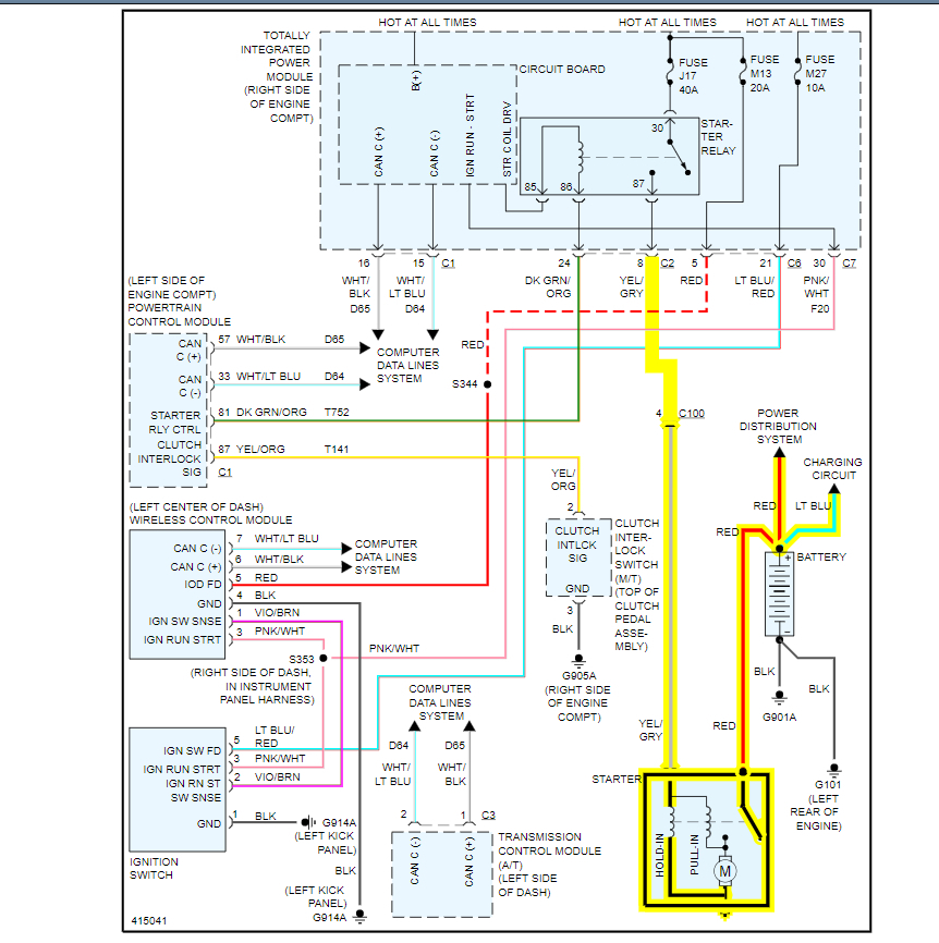

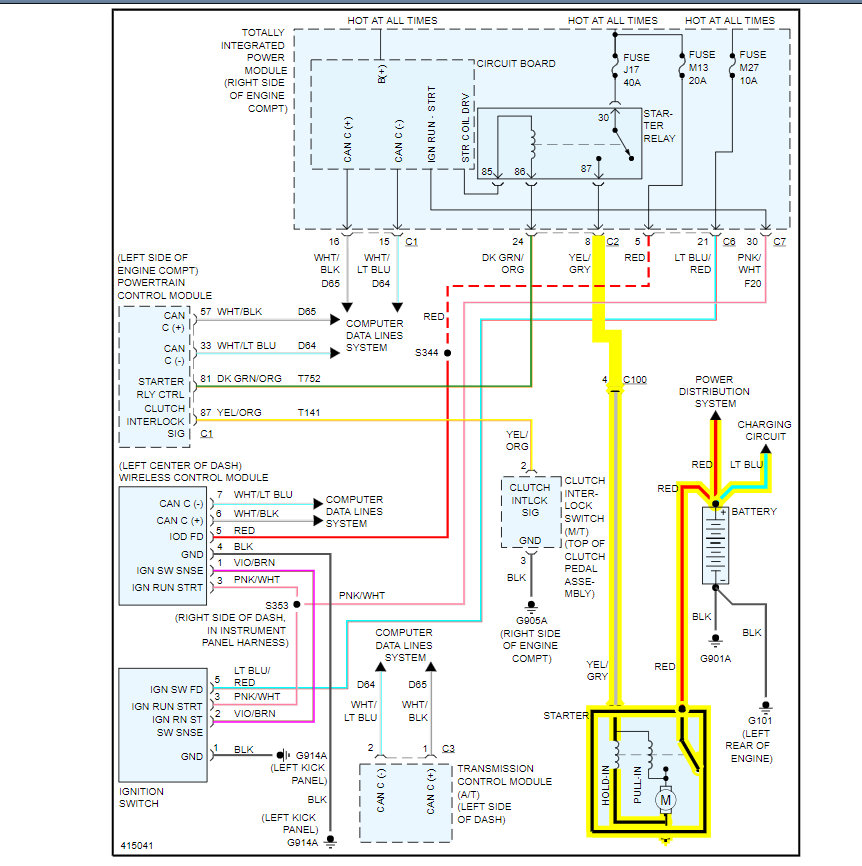

You could have a wiring issue with this vehicle. I have attached the starting system wiring diagram for your reference.

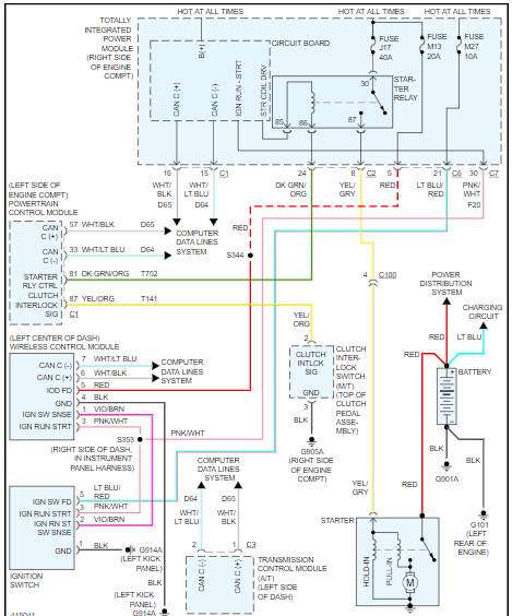

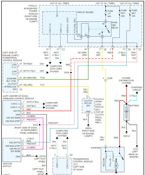

Good afternoon,
I attached the wiring diagram for you to view. There is a starter relay in the fuse block or TIPM. It looks for a neutral or park signal. Once it sees that signal, it will ground the control side of the relay and send power to the starter solenoid.
There should be 2 powers to the starter relay. Make sure the powers are present with the key on.

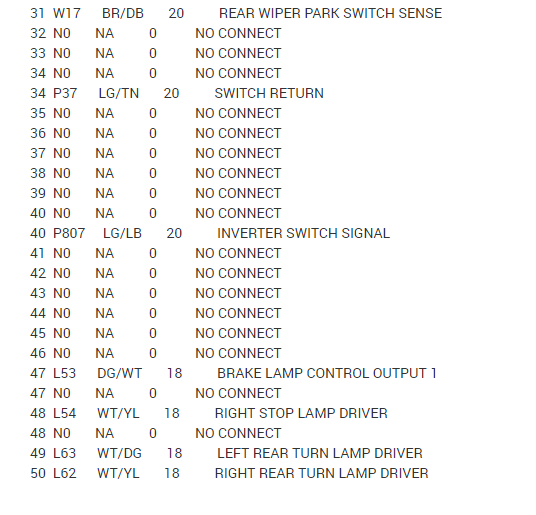

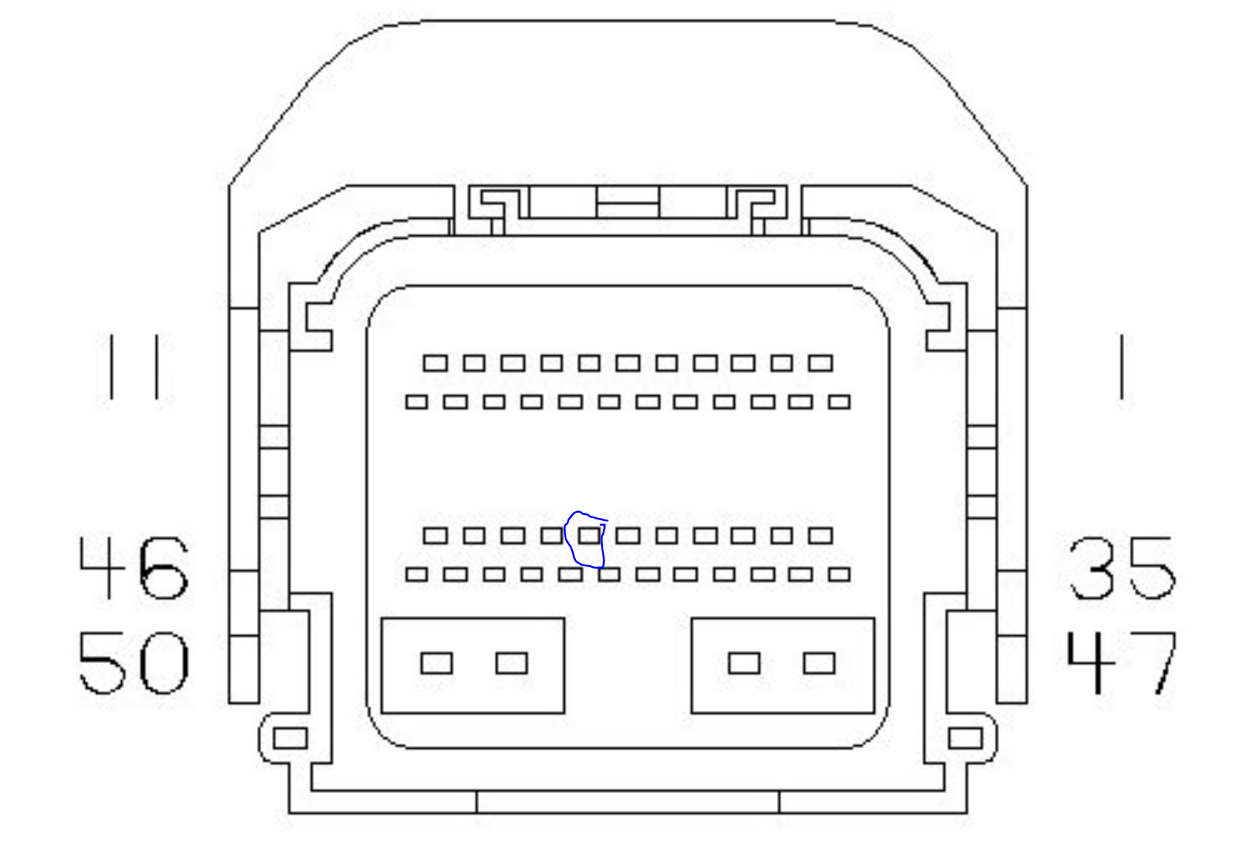

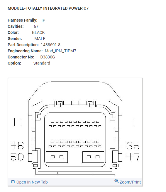

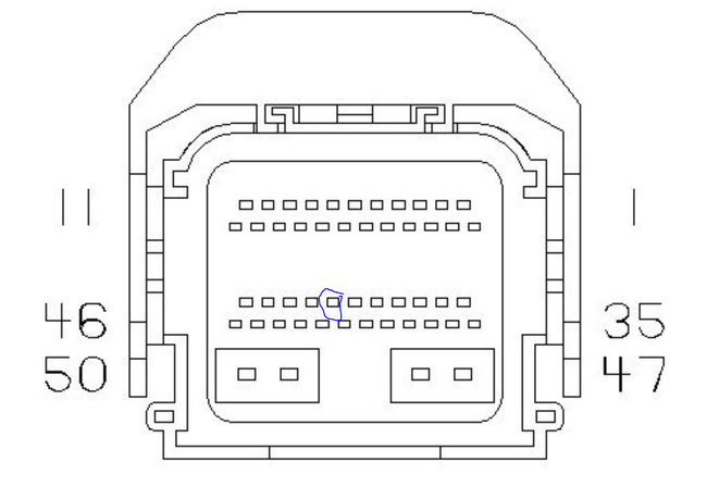

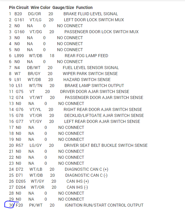

Okay, you need to check pin number 30 on the power module or fuse block. It should have power in the start position. I attached the connector diagram for you for the test. Back probe the wire for testing.

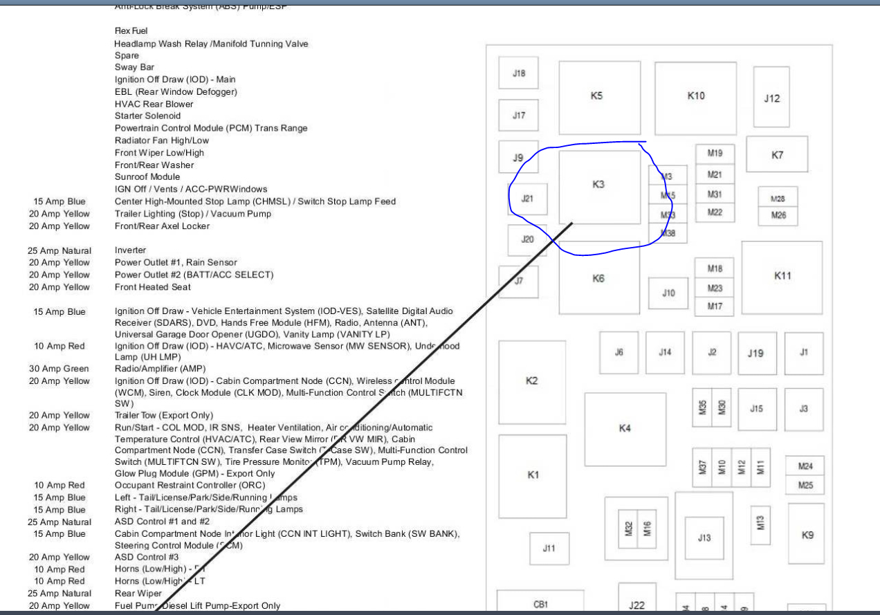

I attached the location of the module for you.
