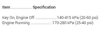

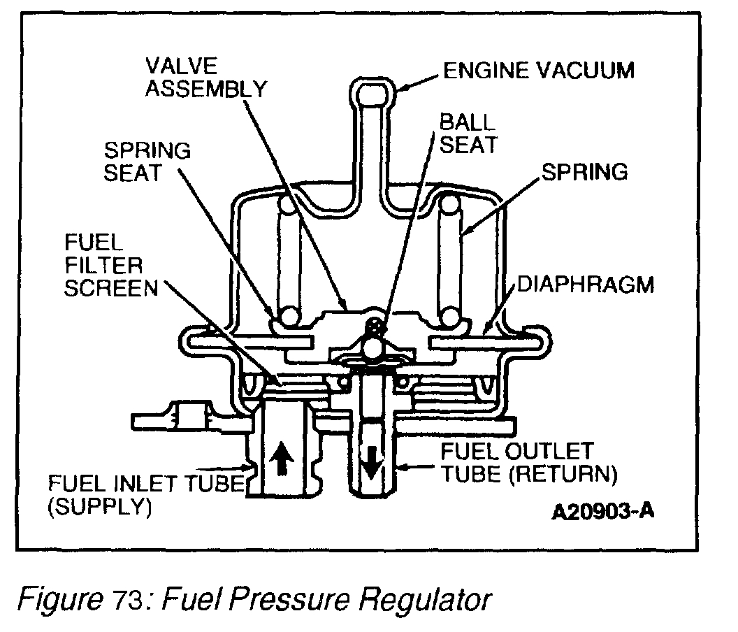

My car won't start, cranks over but that's it. I have put a fuel pump driver on it. The fuel pressure is reading 80.psi"s. i know that's too high. Would this possibility be a fuel pump regulator problem and if so is it located in the fuel tank with the pump? Or what else could it be ? I'm getting fire because it will run as long as I feed gas to it. Thanks any input. Mike
