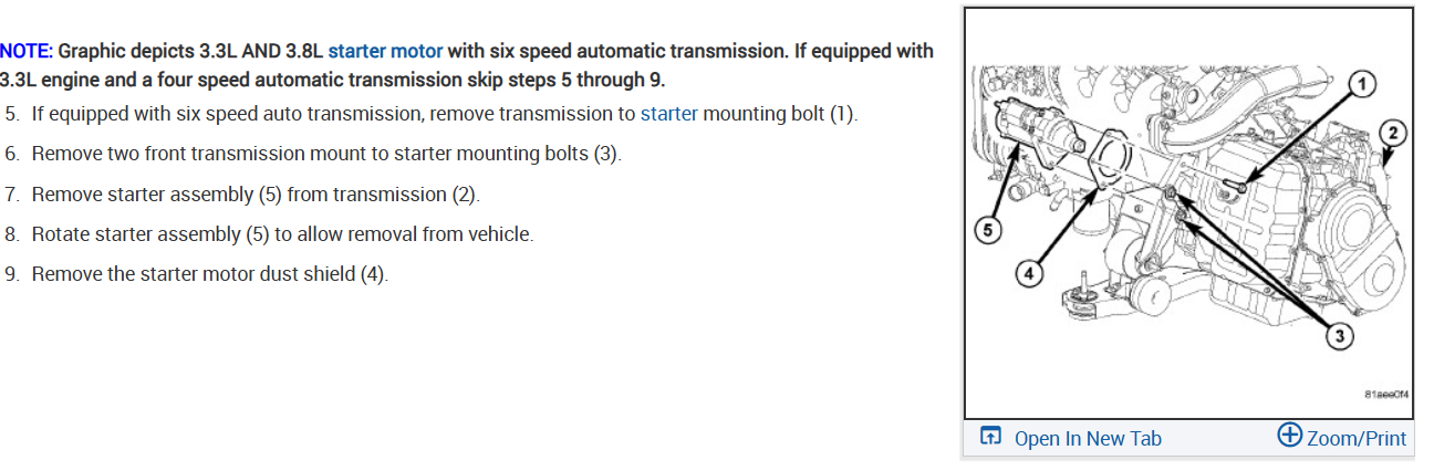

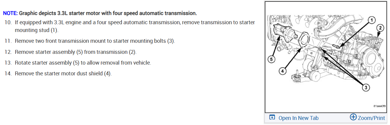

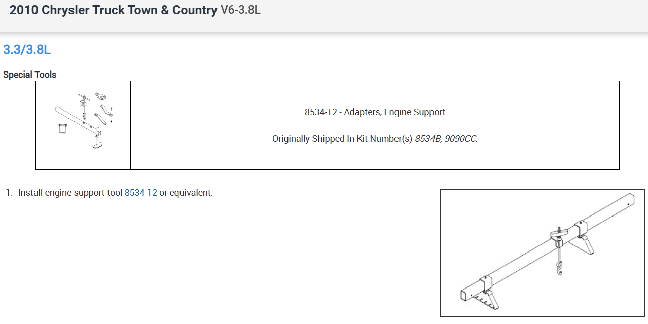

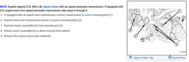

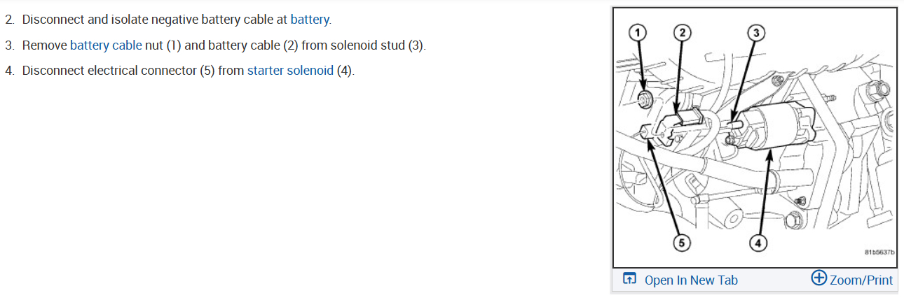

Try to crank the engine over in neutral to see if anything changes. If you tap on the starter and it starts working it is bad, here is how to change it out. Check out the images (below). Please let us know what happens.

I am sorry to hear about your troubles. I would try the hammer trick on the starter to see if there are any changes, it does sound like the starter is the problem though. Here is a guide to check and see for sure though in case the hammer trick does not work.
https://www.2carpros.com/articles/starter-not-working-repair
