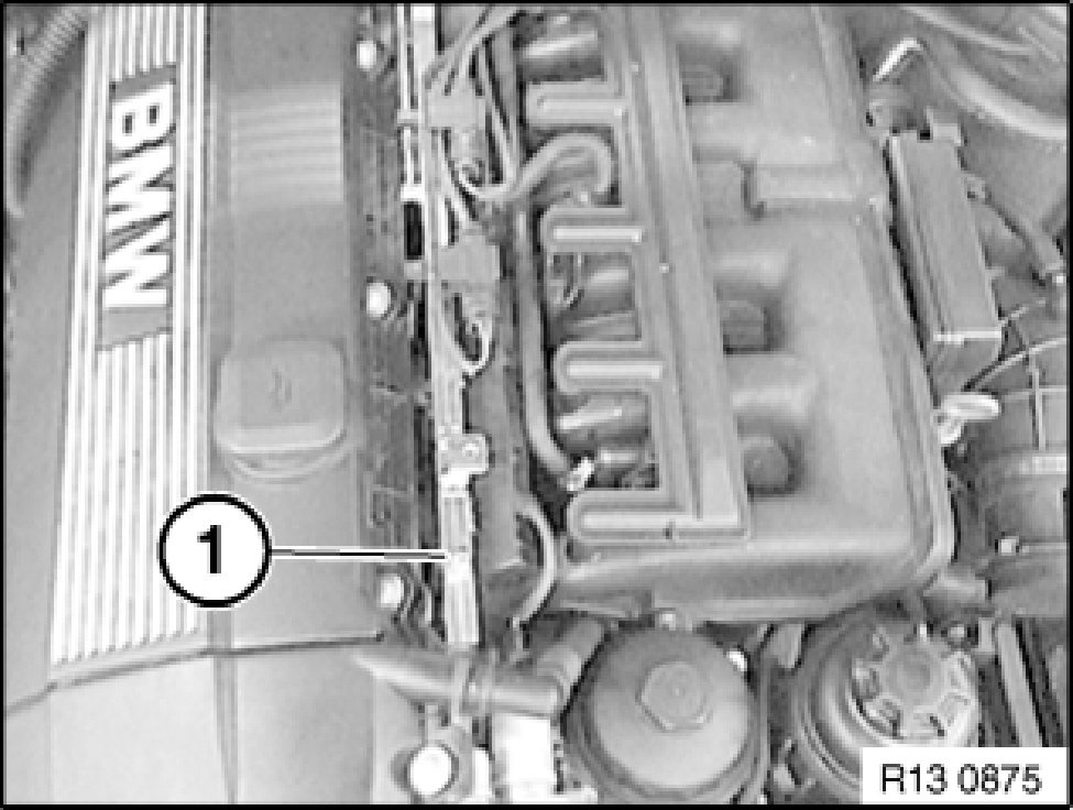

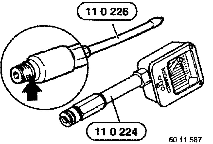

Disconnect all supply leads from ignition coils (interrupt power supply to ignition coils).
picture 1
Remove all spark plugs See: Spark Plug > Service and Repair

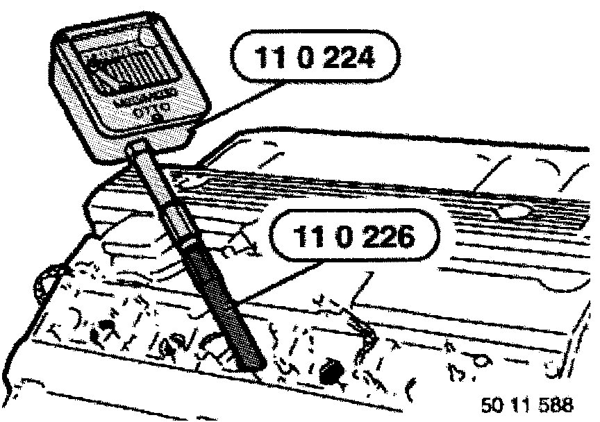

Screw special tool 11 0 226 by hand into spark plug thread and connect special tool 11 0 224.
Note: Check that seal is in perfect condition.
picture 2
Depress accelerator and actuate starter until compression stops rising.
Compression pressure See: Compression Check > Pressure, Vacuum and Temperature

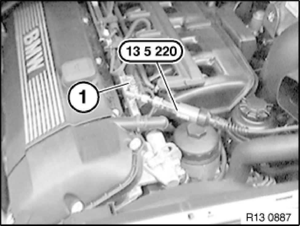

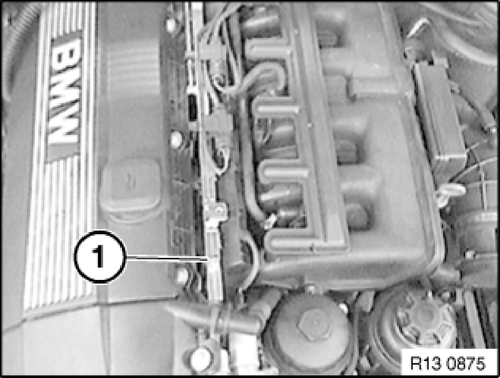

Remove cover from fuel injectors.
picture 3

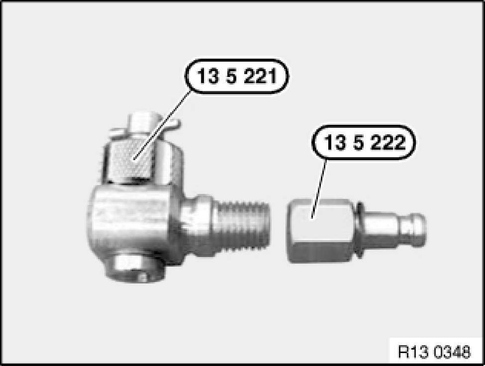

Remove dust cap (1) from measuring valve on fuel rail.
picture 4

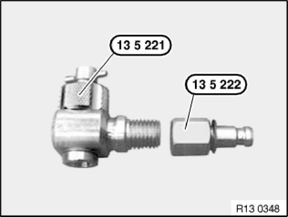

Prepare special took kit 13 5 220 (consisting of 13 5 221 and 13 5 222).
picture 5
Unscrew check valve (1) on special tool kit 13 5 220.
Fit special tool kit 13 5 220 on measuring valve and tighten knurled nut until hand-tight.

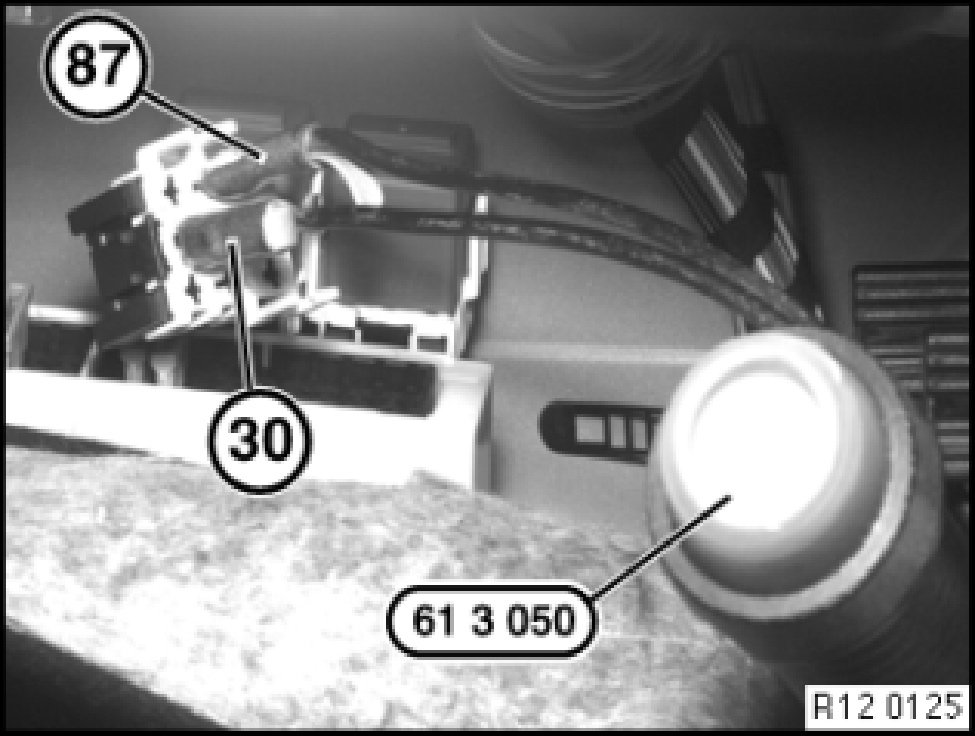

Detach fuel pump relay.
NOTE: Check whether fuel pump no longer starts up during engine starting procedure (engine fails to start).
picture 6

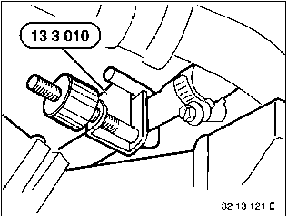

picture 7
Keep special tool 13 3 010 ready for further tests.
Further tests are described in the section "Fuel pressure check".
