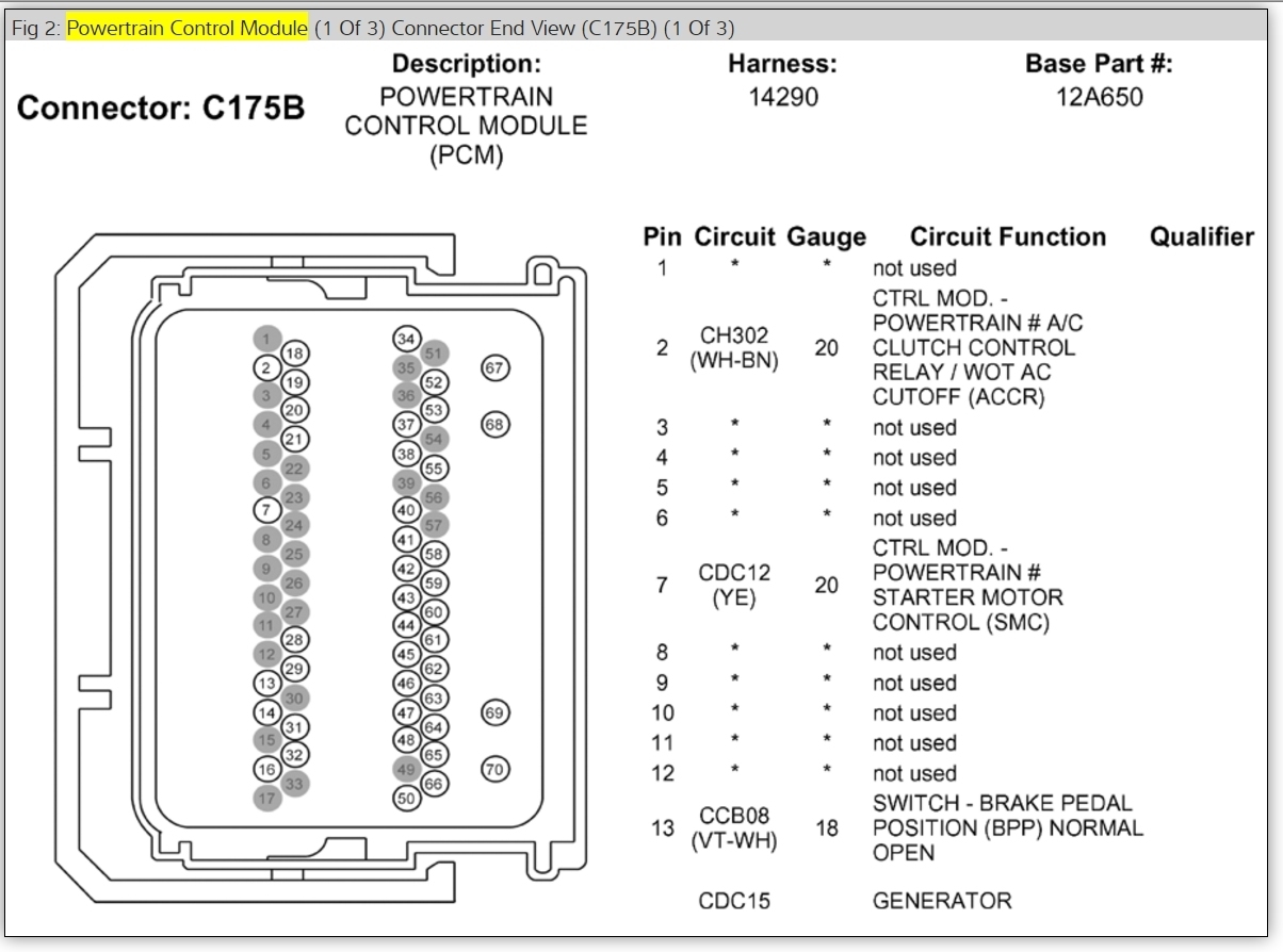

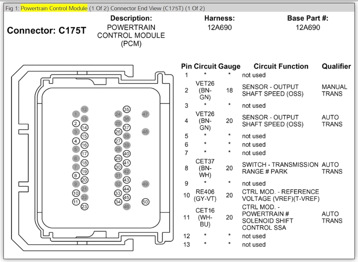

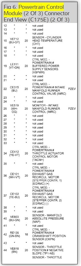

The BCM stands for body control module, but I apologize your car does not have one, it will be the PCM causing the problem. I would do a pin to pin check on the all the system grounds first though because of the blown fuse which could be an indication of this problem. Here are the wiring diagrams for the computer so you can check the computer ground which look like they are at he front fender.
Please let us know what you find
Best, Ken
