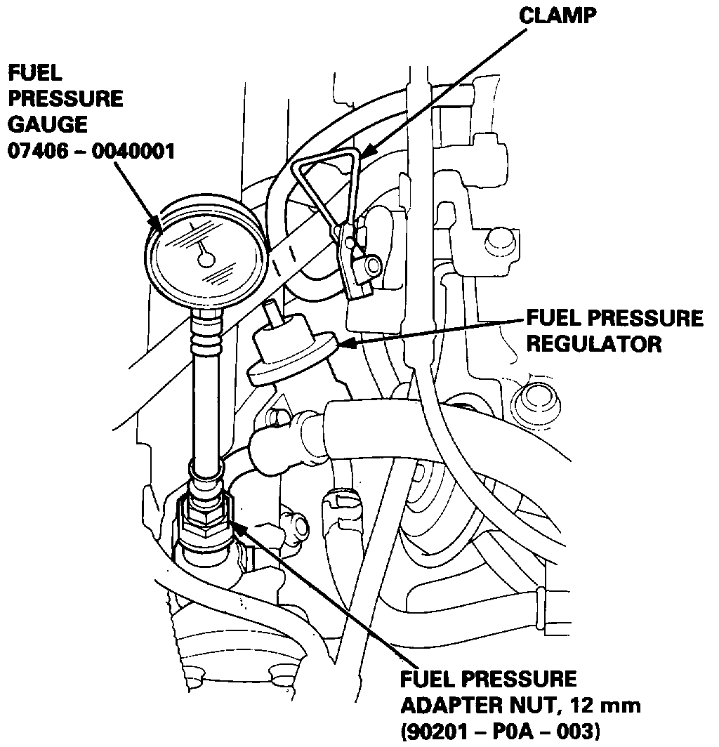

The flashing engine light indicates a misfire is occurring at that time. Now, many things can cause that to happen, however, I would suggest starting with checking the fuel pump pressure. Although you hear it run, it may not be providing enough pressure. As a result, hard start, engine miss. Here is a link that describes how, in general, to check pressure:
Here is a link that discusses what can cause a hard start:
https://www.2carpros.com/articles/engine-cranks-excessively-before-starting
Here are the directions specific to your vehicle for testing. The manufacturer's specifications for pressure are in the directions.
____________________________________________
Inspection
1. Relieve fuel pressure.
2. Remove the 12 mm sealing nut from the fuel rail. Attach the 12 mm fuel pressure adapter nut and the special tool.
3. Start the engine. Measure the fuel pressure with the engine idling and the vacuum hose of the fuel pressure regulator disconnected from the fuel pressure regulator and pinched. If the engine will not start, turn the ignition switch on, wait for two seconds, turn it off, then back on again and read the fuel pressure.
Pressure should be: 270 - 320 kPa (2.8 - 3.3 kg/sq.cm, 40- 47psi)
4. Reconnect vacuum hose to the fuel pressure regulator.
Pressure should be: 200-250 kPa (2.1-2.6 kg/sq.cm, 30-37 psi)
If the fuel pressure is not as specified, first check the fuel pump.
If the fuel pump is OK, check the following:
- If the fuel pressure is higher than specified, inspect for:
- Pinched or clogged fuel return hose or line.
- Faulty fuel pressure regulator.
- If the fuel pressure is lower than specified, inspect for:
- Clogged fuel filter.
- Fuel line leakage.

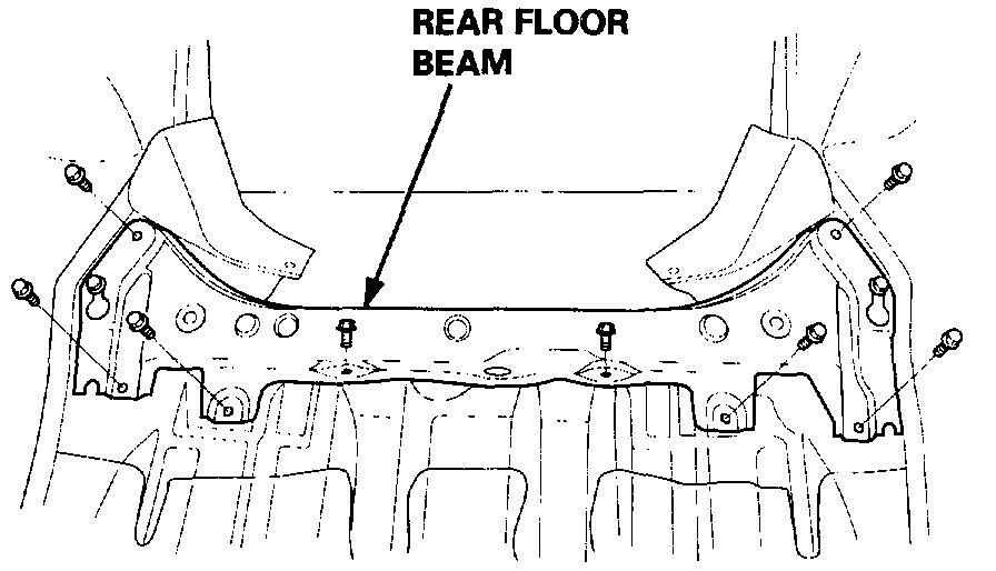

1. Remove the seat cushion, and pull up the carpet.
2. Remove the rear floor beam.
3. Remove the access panel from the floor.

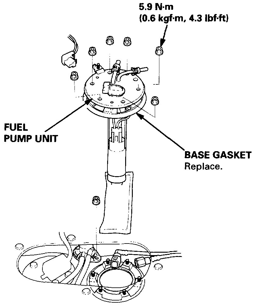

4. With the ignition switch OFF, disconnect the 2P connector (C508) from the fuel pump.
5. Remove the fuel pump mounting nuts.
6. Remove the fuel pump from the fuel tank.
7. Install parts in the reverse order of removal.
