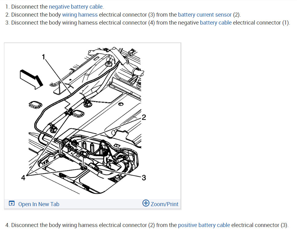

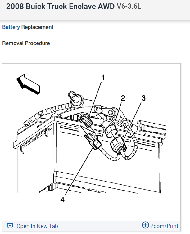

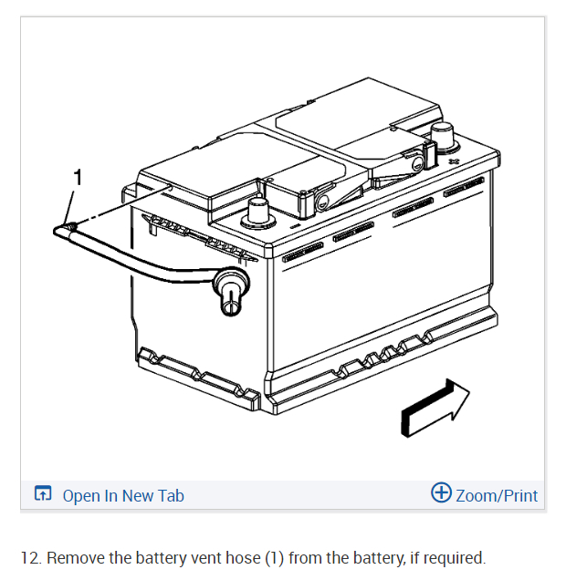

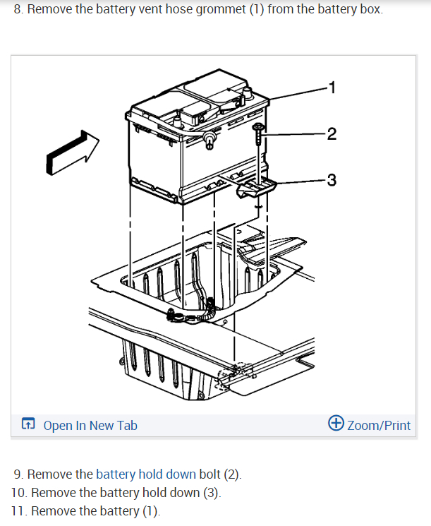

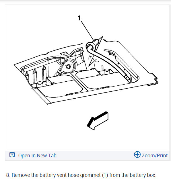

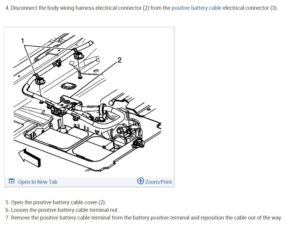

Yep, the battery sounds like it needs replacement, here is a video that will help you find out for sure:
https://youtu.be/6YRW8fyNudY?si=PcYklmYGplxdED0i
Here is how to change the battery out. Check out the images (below). Please upload pictures or videos in your response of any problems so we can see what to help you with.
