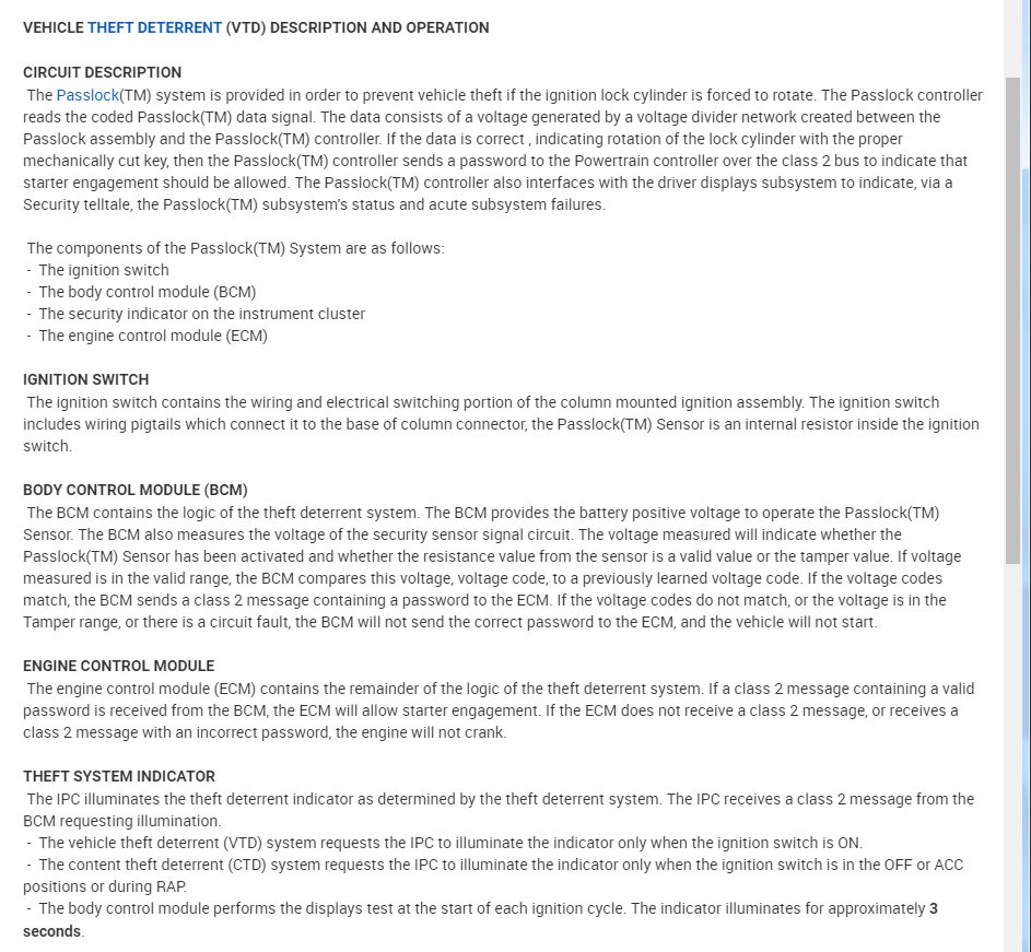

Is the theft light remaining on? I attached the info about this system. If the theft light is remaining on then we need to check for codes and see if there is something specific that it is telling us is the issue.
Let me know if there are codes and we can go from there. Thanks

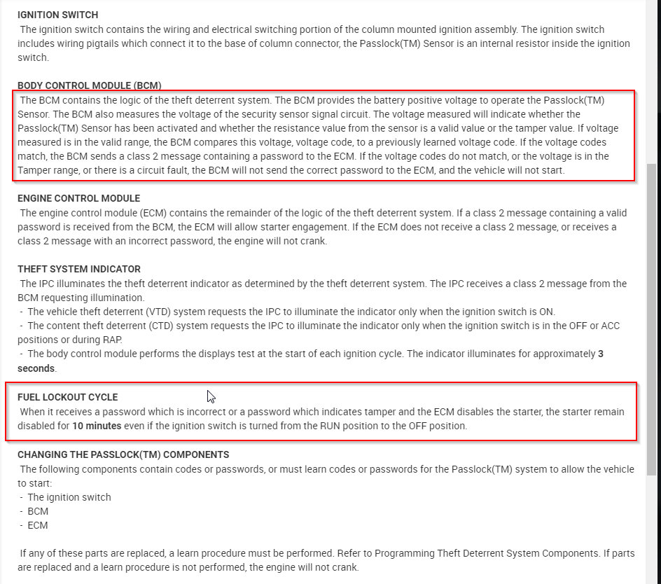

I was worried about that. This means we are going to need a scan tool capable of communicating with the BCM and looking at live data to see if the ignition switch state is changing when you turn the key. If the BCM is not seeing this then it will not deactivate the system. It will not set any codes because it doesn't know anything is wrong. At this point, it could be the switch, BCM, or ECM. It is in what is called full lock out mode. You sitting with the key in the on position for 15 minutes should unlock it but again, if the BCM is not seeing the switch state change then it will not unlock it.
Sorry I don't have better news but if you don't have this scan tool we are going to need to get a shop involved that can do this.
