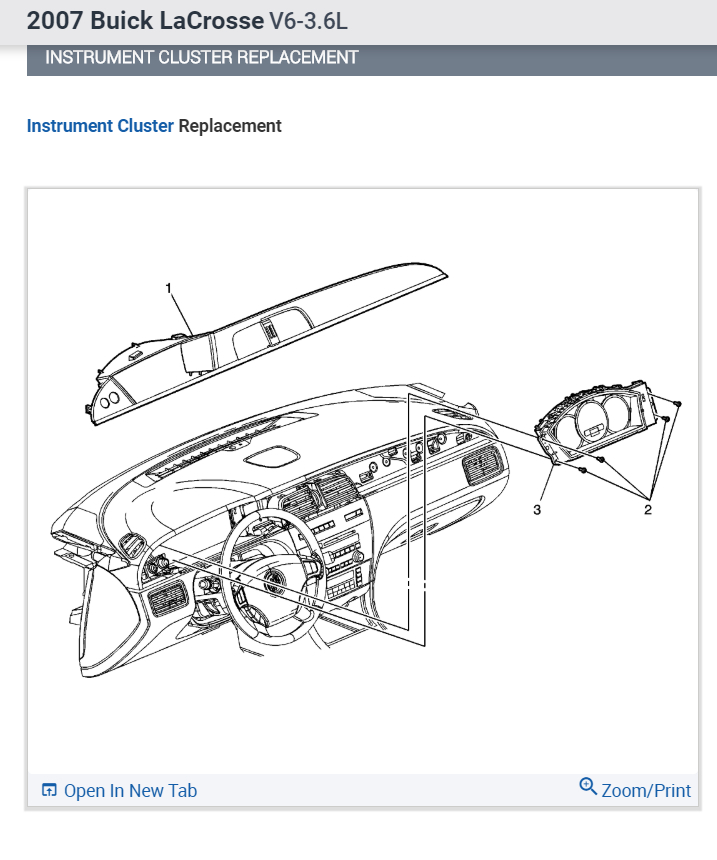

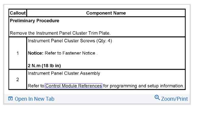

When I put the keys in the ignition and turn to "on", the instrument cluster goes haywire and if I go directly to "start" it won’t turn over and everything goes haywire. If I wait for about ten seconds, the instrument cluster normalizes and it will start. It began that way and now I have fluctuations in my rpm, going from 900 to 3500 rpm while idling.
