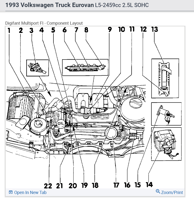

I've have had several coil failures. Currently it will try to fire/start but will fail to stay running and smells like it had flooded (light gray smoke from exhaust). It may take several attempts and when it does start, it may not stay running. It seems to always start normally when cold. AutoZone has ordered me a HEI coil, it was listed as one of the options for this vehicle. I haven't read anything describing this van having a HEI in my Bentley repair manuals. I've sent the ECM in for a test and check, and was found to have no problems. The alternator is providing 14.45 volts per specs.
Plugs and wires are relatively new and show no signs of problems. Voltage regulator is also quit new and is putting out correct voltage each time I check.
