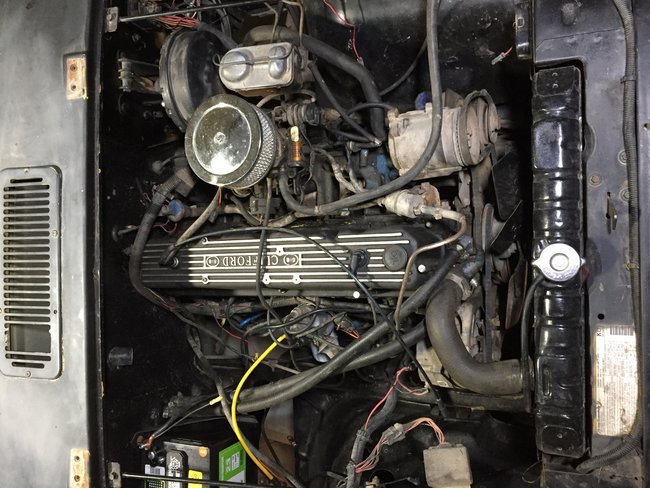

Photos are always appreciated, but in this case the only thing I can see is some uneducated do-it-yourselfer slapped on an air filter that is much too small, and it is not in the correct housing with all the needed hardware that goes with it. What you need to do is start with one system, and make that complete and correct, then move on to the next system. If you look for missing stuff haphazardly, you can be sure you are going to overlook many individual things. You will have better luck finding a similar vehicle in a salvage yard that you can use for reference.

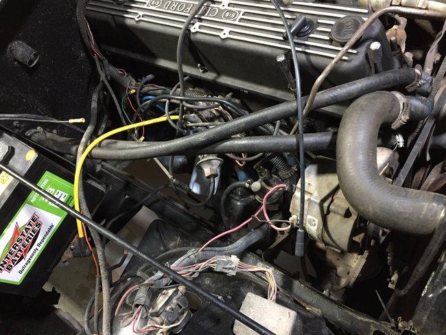

For example, start with the charging system. Be sure the generator is mounted correctly and the drive belt is in line with all the pulleys. Your generator is a GM unit and in my opinion, it's the second best design after the older Chrysler alternators. Two wires plug into the side of it. The large output wire bolted to the rear should have full battery voltage on it all of the time. One of those smaller wires will also have full battery voltage all of the time. If the "Battery" warning light on the dash turns on when you turn on the ignition switch, that second smaller wire's circuit is working. Now pick another system and approach it that way.

My specialty areas are electrical, suspension and alignment, and brakes. I got a real bad feeling as soon as I saw the butchered air filter. My concern is what else was done that we do not know about. If the ride height was altered, I do not even want to be part of the conversation unless it involves restoring it to factory specifications. With the brakes, there is a real lot that do-it-yourselfers can do to cause problems, and there is a real lot that professionals do during a normal brake job to avoid causing problems. Once we get the engine running, I am still going to be uneasy worrying about what we do not know that could have been modified with the brakes.
