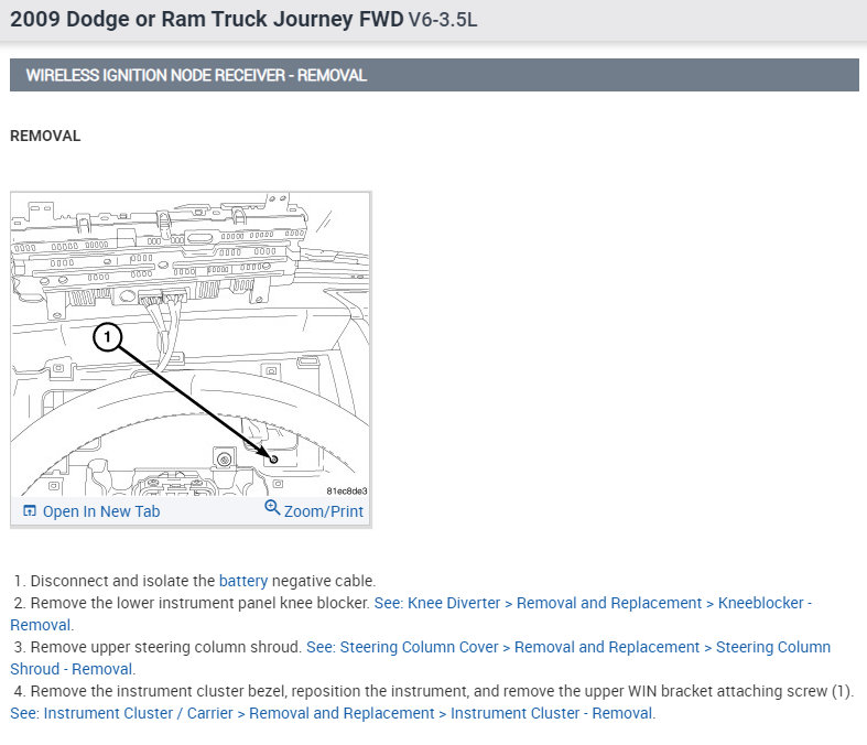

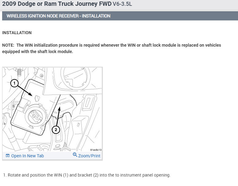

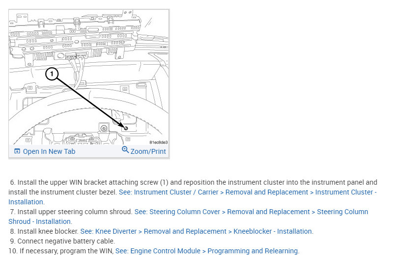

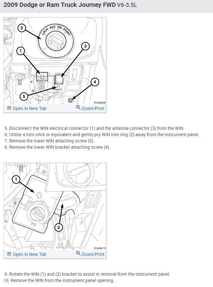

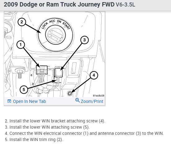

If you tried to jump start it and it still does not make any noise then, it could be due to a faulty ignition node.
The ignition node is the electrical component that performs the starting and other functions.
Please let me know mode details of what you might be experiencing or what you have tried so far.
