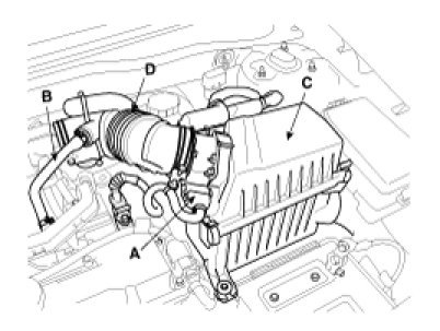

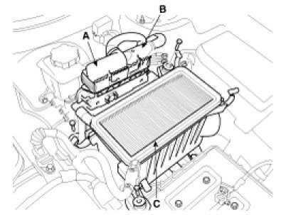

2. Remove the air cleaner assembly.

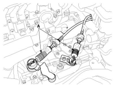

3. Remove the shift cable and bracket. (M/T)

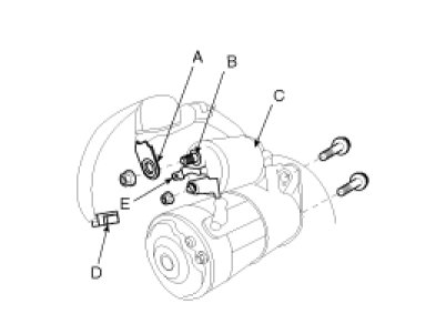

4. Disconnect the starter cable (A) from the B terminal (B) on the solenoid (C), then disconnect the connector (D) from the S terminal (E).
5. Remove the 2 bolts holding the starter, then remove the starter.
