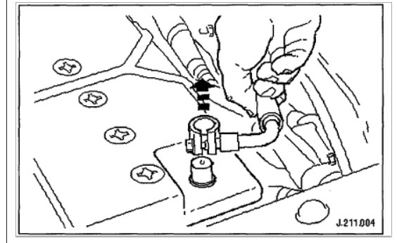

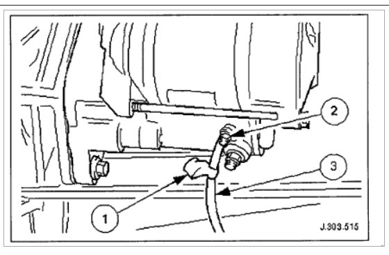

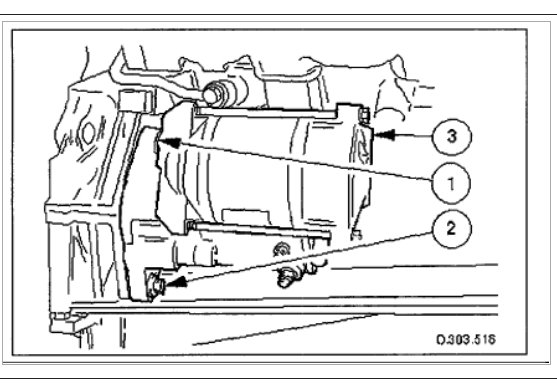

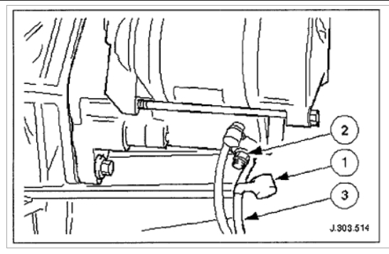

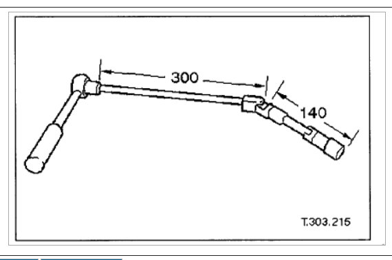

Here is the diagrams shown from the manual for your car (below).
Check out the diagrams (below).
