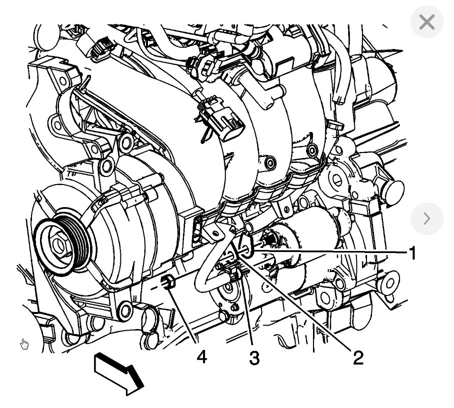

I've replaced starter and putting it back together and have a wire that I didn't notice during removal. I believe it attached with the command on the terminal with the battery feed because it was the only nut I removed. It is the same wire end at the battery feed and I'm guessing it is a feed positive feed to the harness; it is heading toward the passenger side and up.
Jun 29, 2019 at 1:59 PM

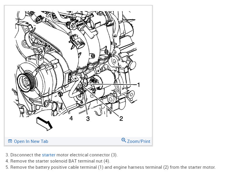

Without seeing a picture, you sound correct. Here are the instructions on the starter. It appears they list 4 wires/connections total.
Let me know if you need assistance. If you can submit a picture of this wire, it may help in identifying.
Thanks
Jun 29, 2019 at 2:49 PM
JOE DURST
Yes, I see the wire in the picture that I was blocked from seeing.
