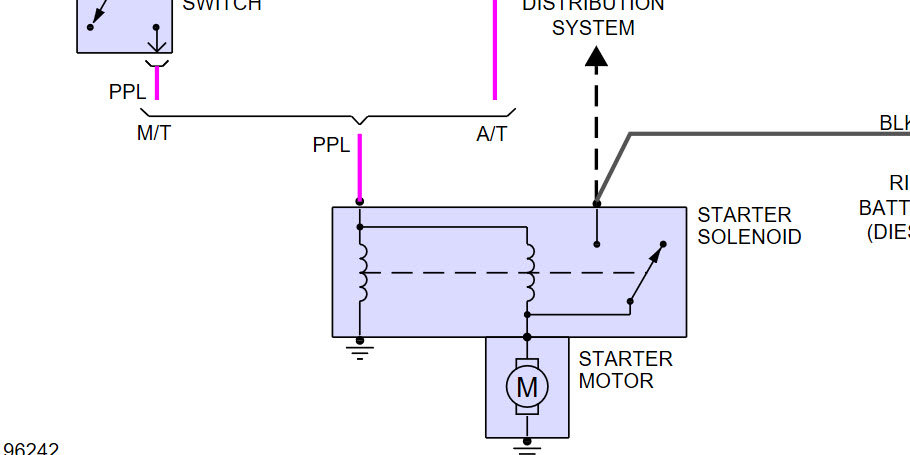

Need correct wiring diagram for new starter.

purple wire goes to "S" terminal remainder on large terminal. If you have another wire that has a small connection it goes to "I" terminal. See picture.
