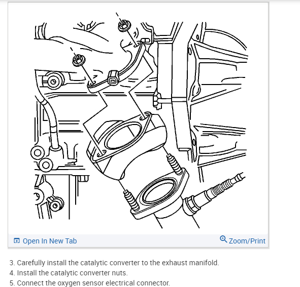

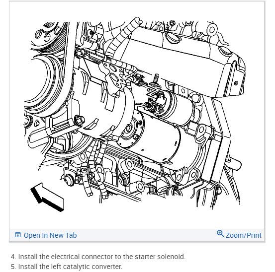

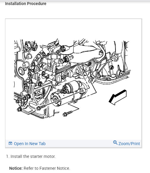

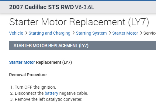

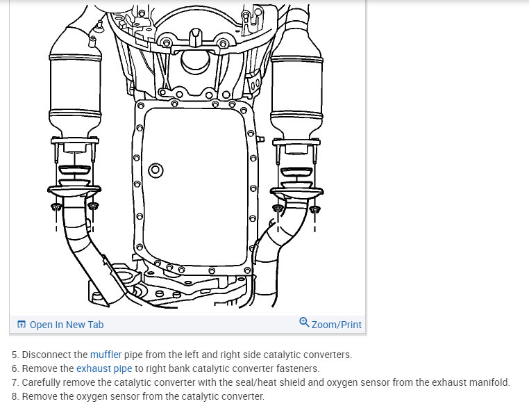

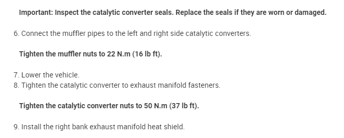

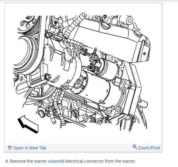

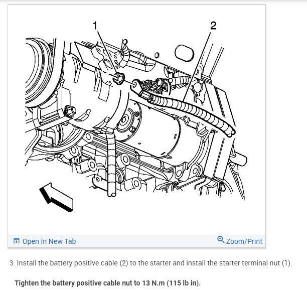

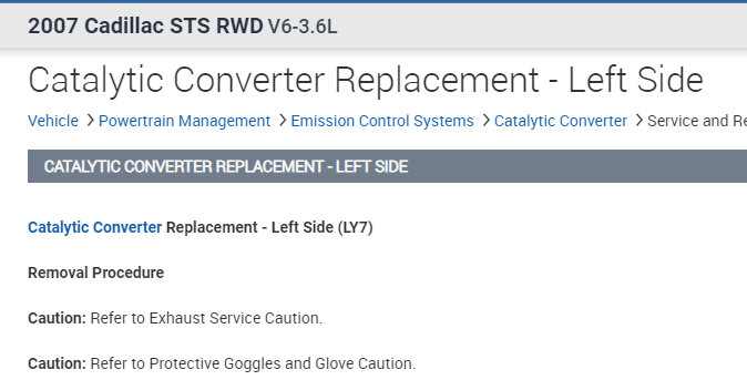

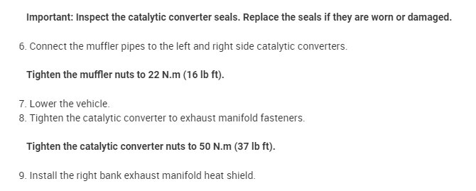

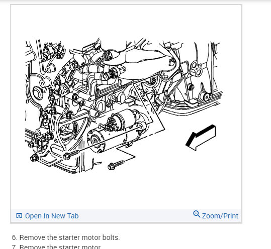

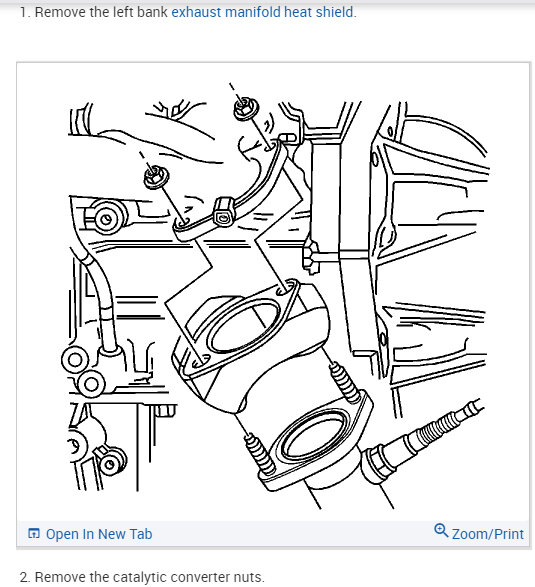

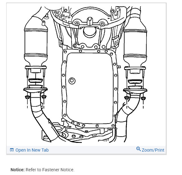

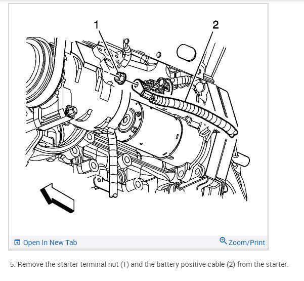

After watching YouTube and my retired mechanic neighbor, we figured the starter needs to be replaced. I need to do this myself in my parking space and I have the tools and jack. Looking at the schematic it looks like the catalytic converter is in the way. Do I need to remove it to get to the starter?
