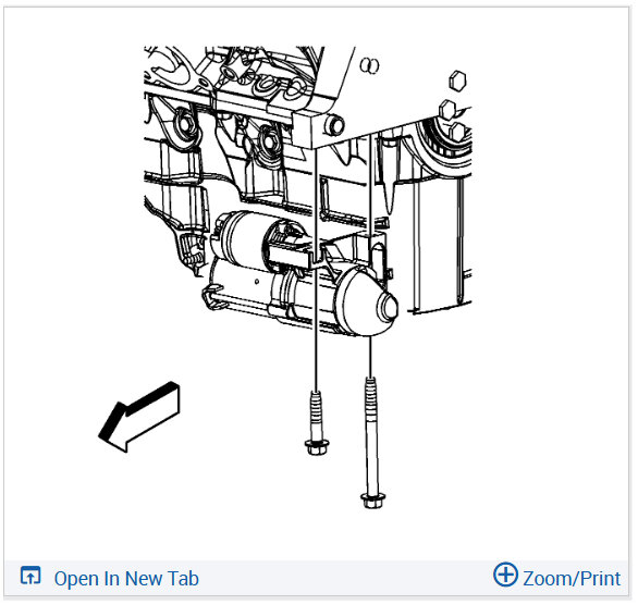

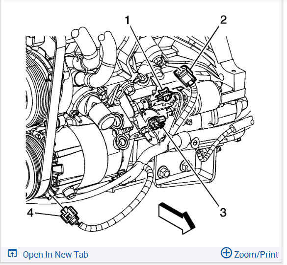

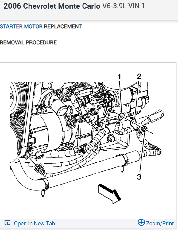

Here are the step-by-step instructions on how to change the starter out with additional information for your car below.
Tighten the bolts to 43 N.m (32 lb ft).
Check out the images (below). Please upload pictures or videos in your response of any problems so we can see what to help you with.
