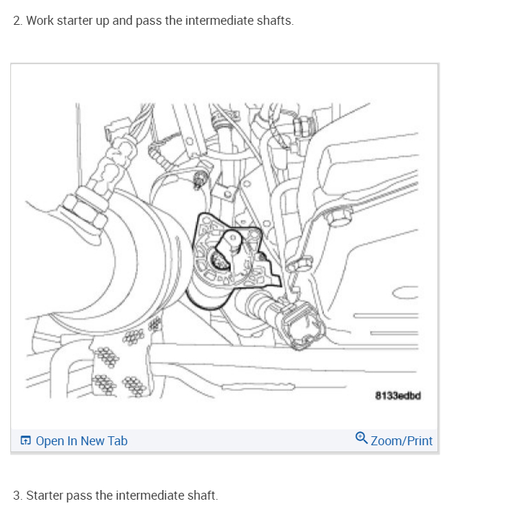

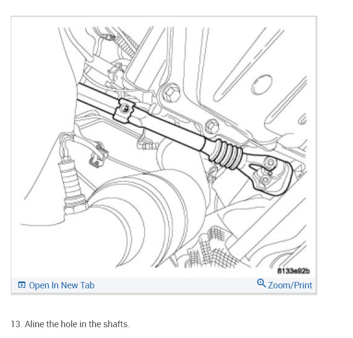

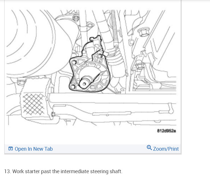

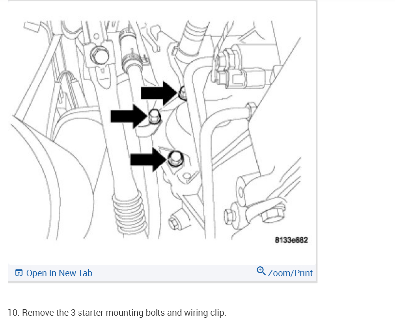

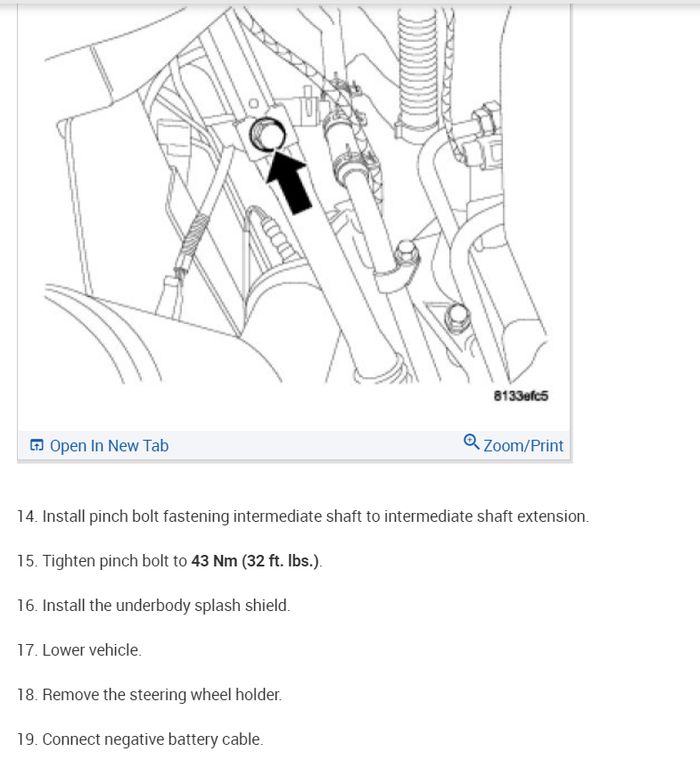

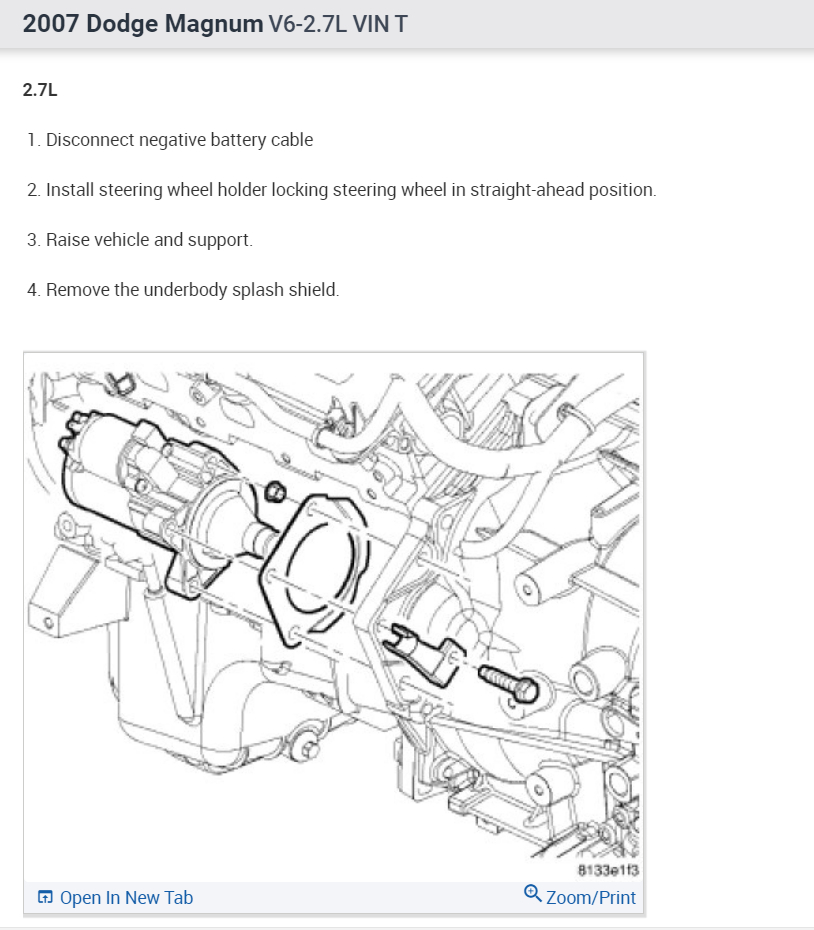

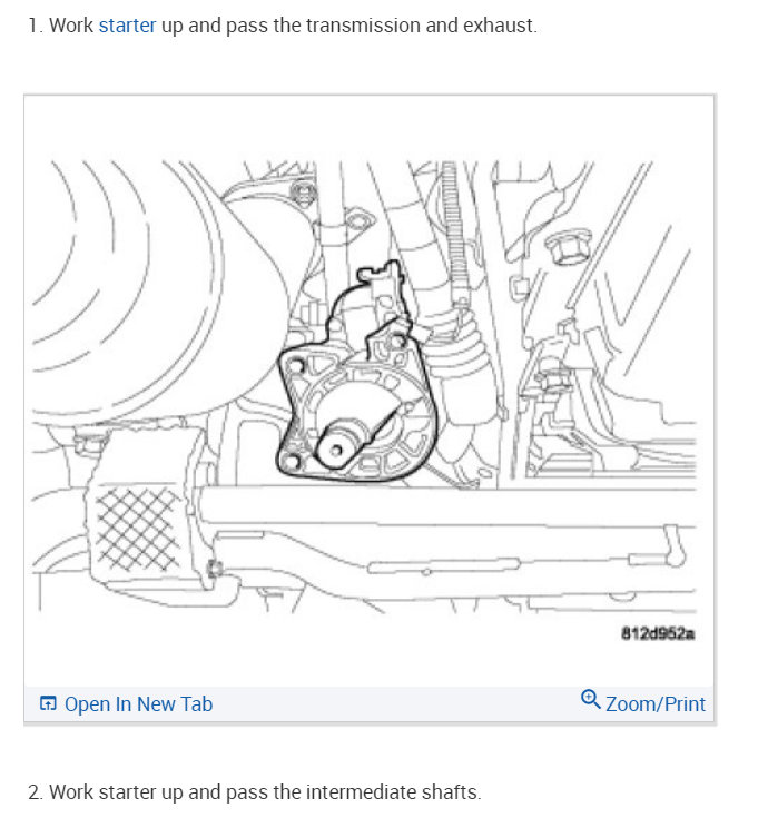

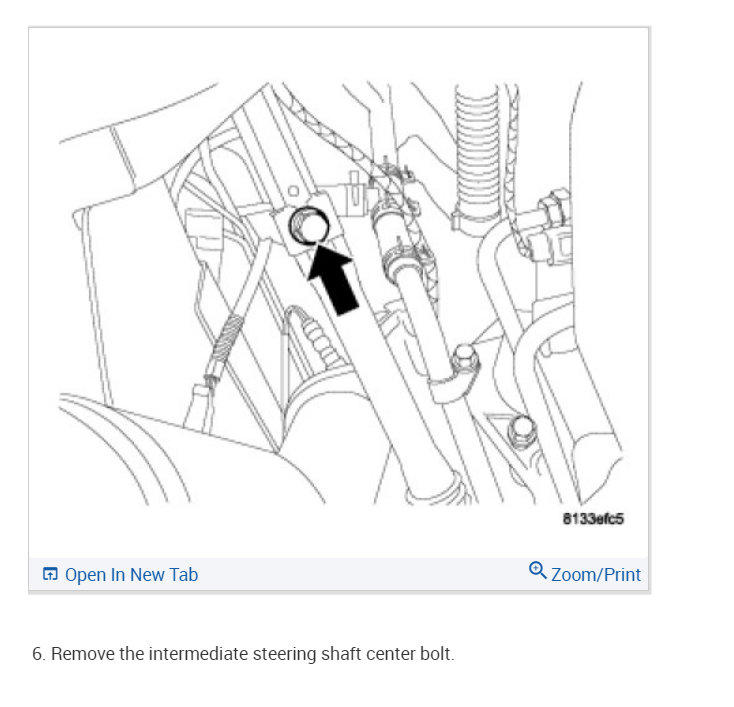

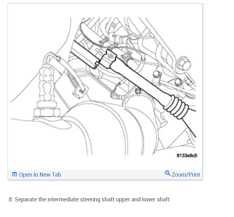

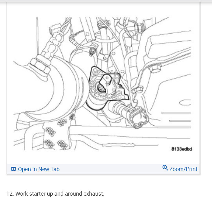

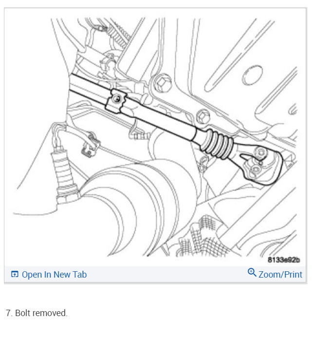

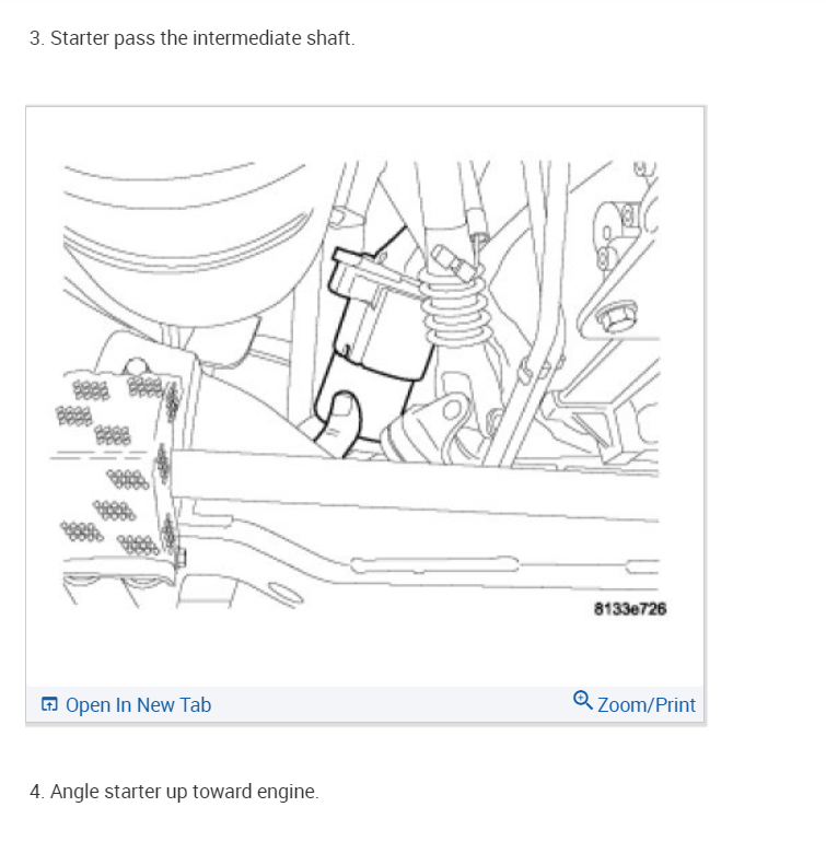

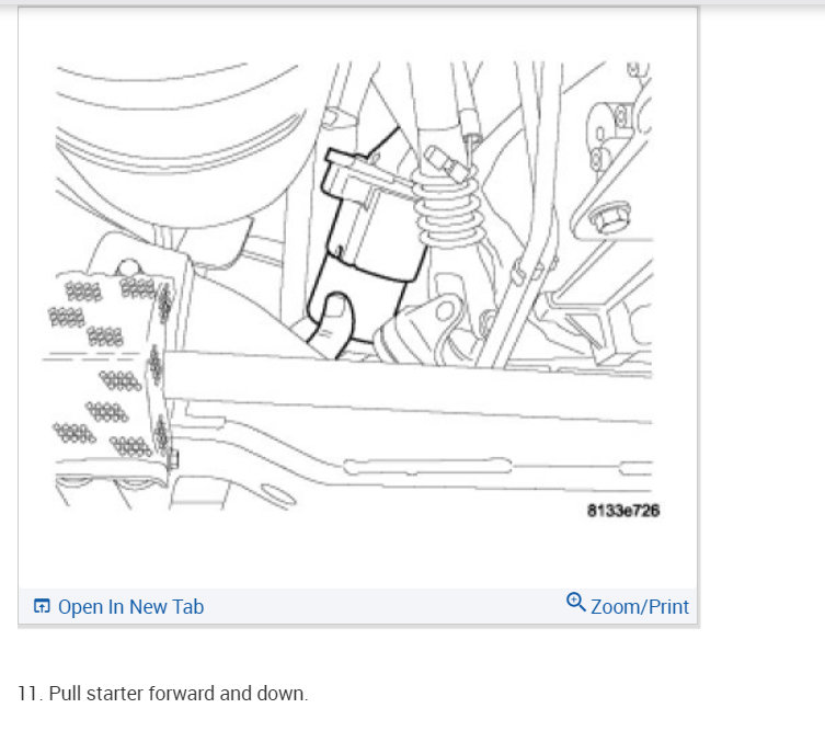

How do I replace the starter in the car listed above? I have to remove the intermediate shaft to be able to pull it out, right?
Aug 31, 2022 at 11:32 PM

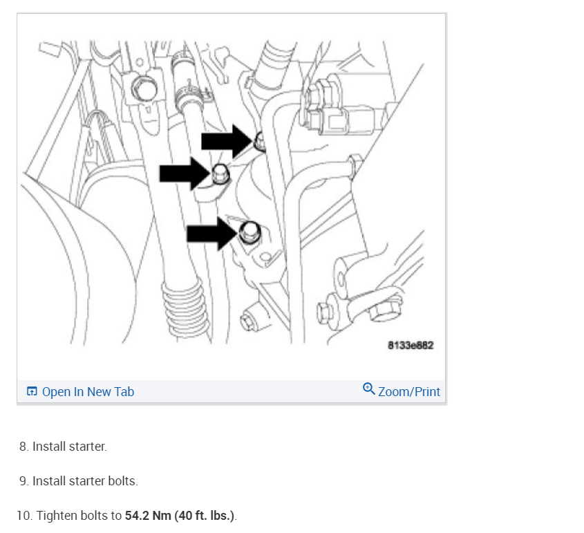

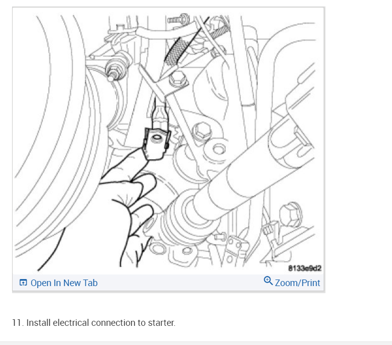

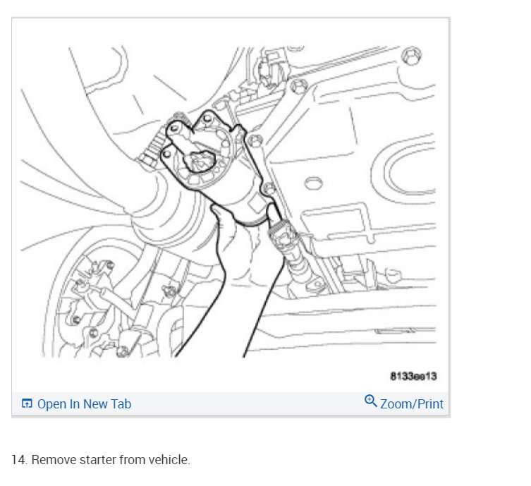

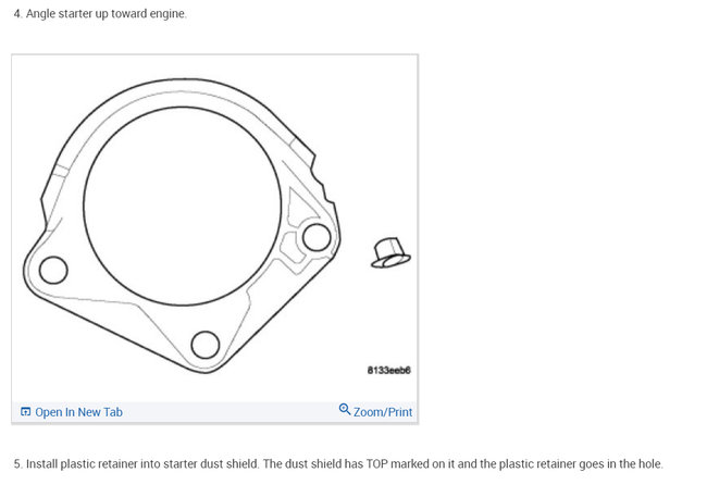

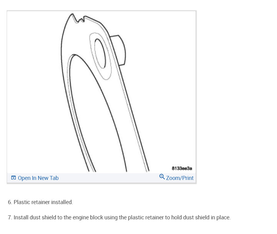

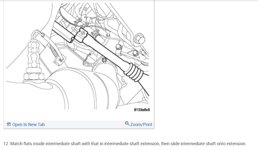

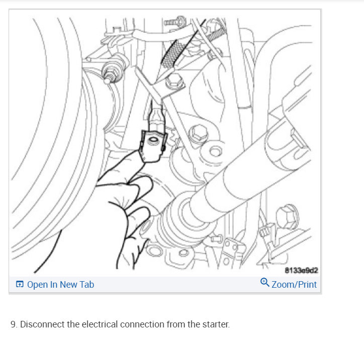

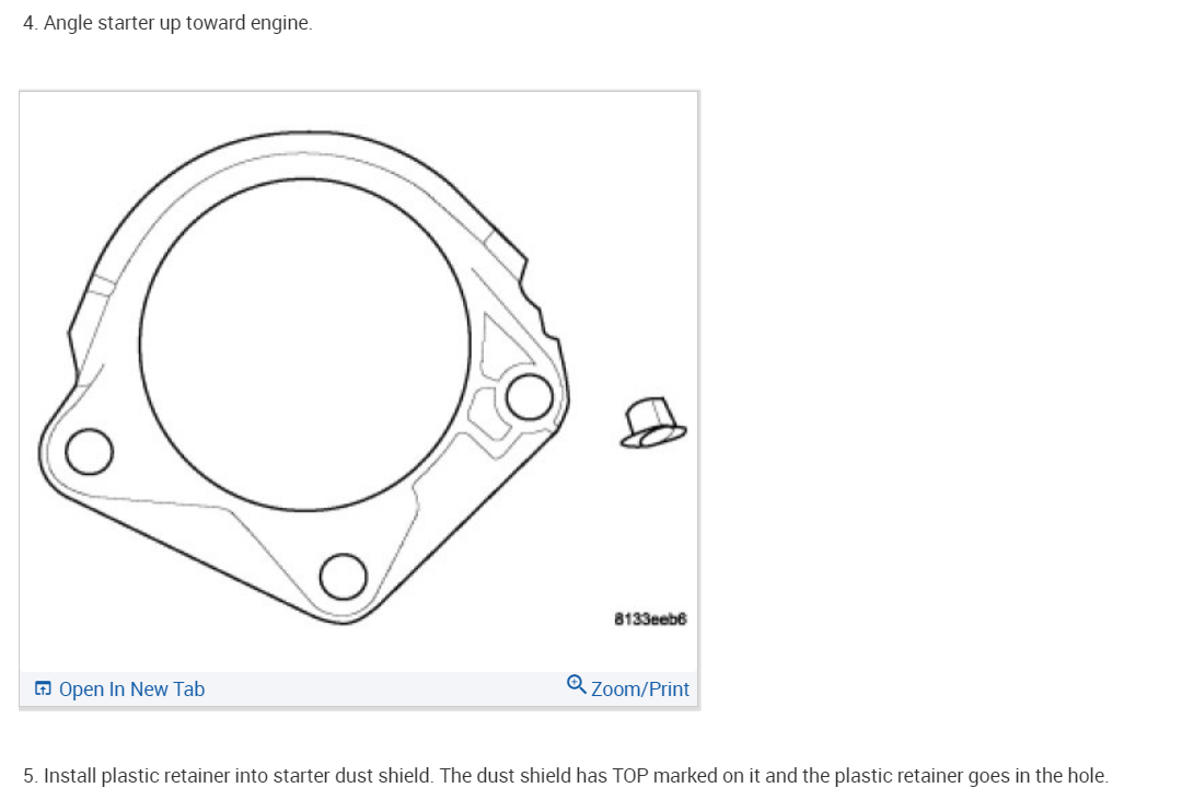

It looks like you need to undo the steering shaft to remove it. Here is a generic guide to help you see what you will be in for when doing the job and I have included how to do the job step by step in the images below for your car.
