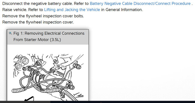

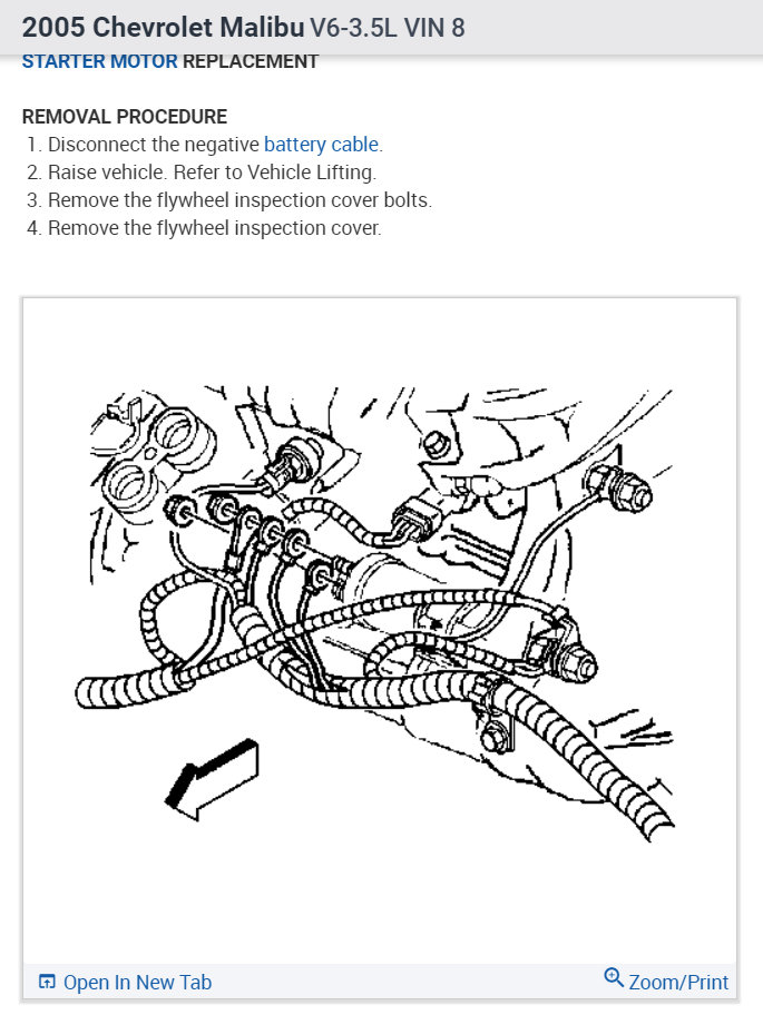

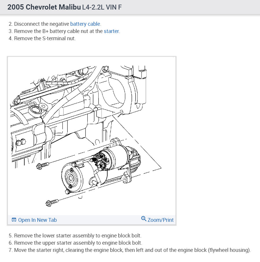

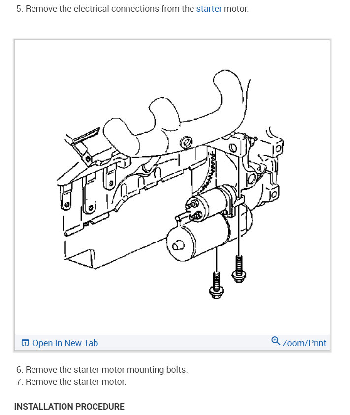

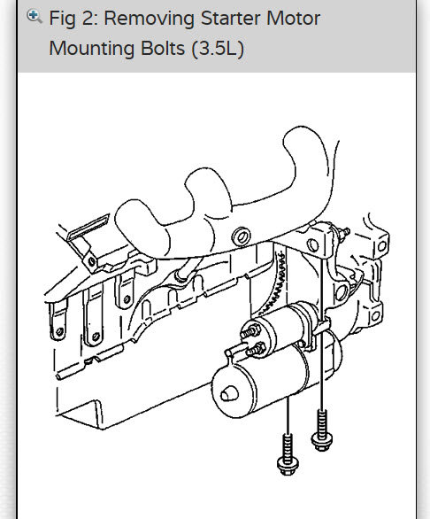

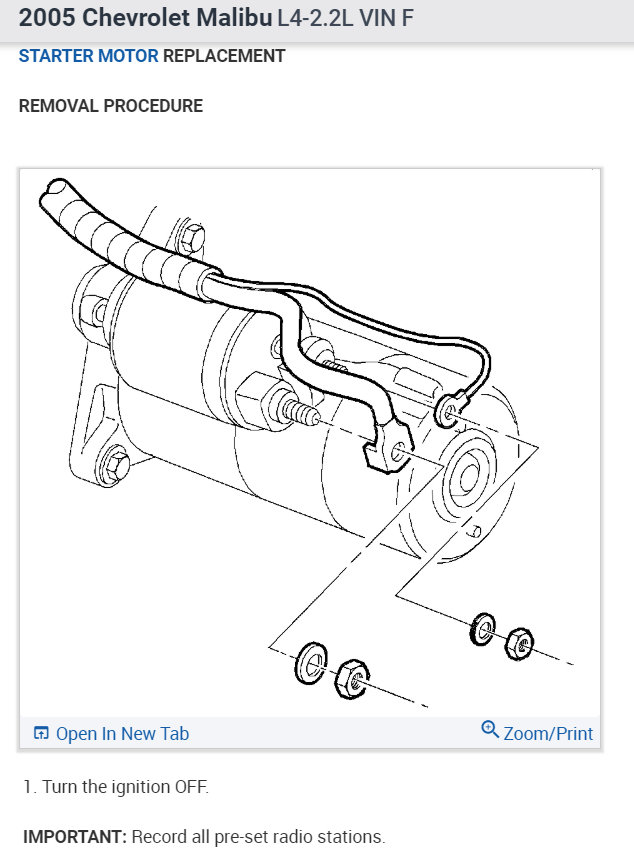

The starter is located at the right front just under the cartridge oil filter housing. I cannot get a box or socket on the top bolt that holds on the starter. How do I get this top bolt out. The head of the bolt is tucked under the filter housing on top of the starter. The bottom bolt can be taken out from under the car with no difficulty.
May 3, 2015 at 5:01 PM
Hi:
You need to use an extension to access the inner bolt from above the starter motor a wrench will not work. Here is a guide that shows how to do it and diagrams below to show you how the starter comes out in your car below.
