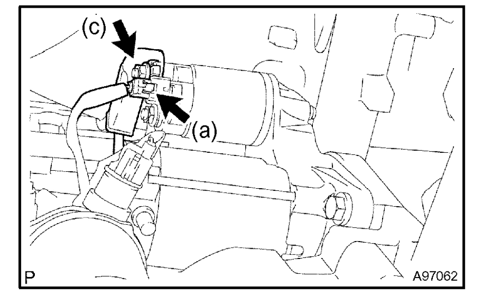

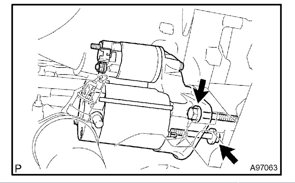

I attached the procedure for you as well as the pictures.
The top bolt you get from the top. you will need to move a harness out of the way and use a 6 inch extension with the 14 mm socket.
Replacement
1. Disconnect battery negative terminal
2. Remove engine under cover rh
3. Remove engine under cover lh
4. Remove starter assembly
a. Disconnect the starter connector.
b. Open the terminal cover.
c. Remove the nut, then remove the starter wire.
d. Remove the 2 bolts, then remove the starter.
