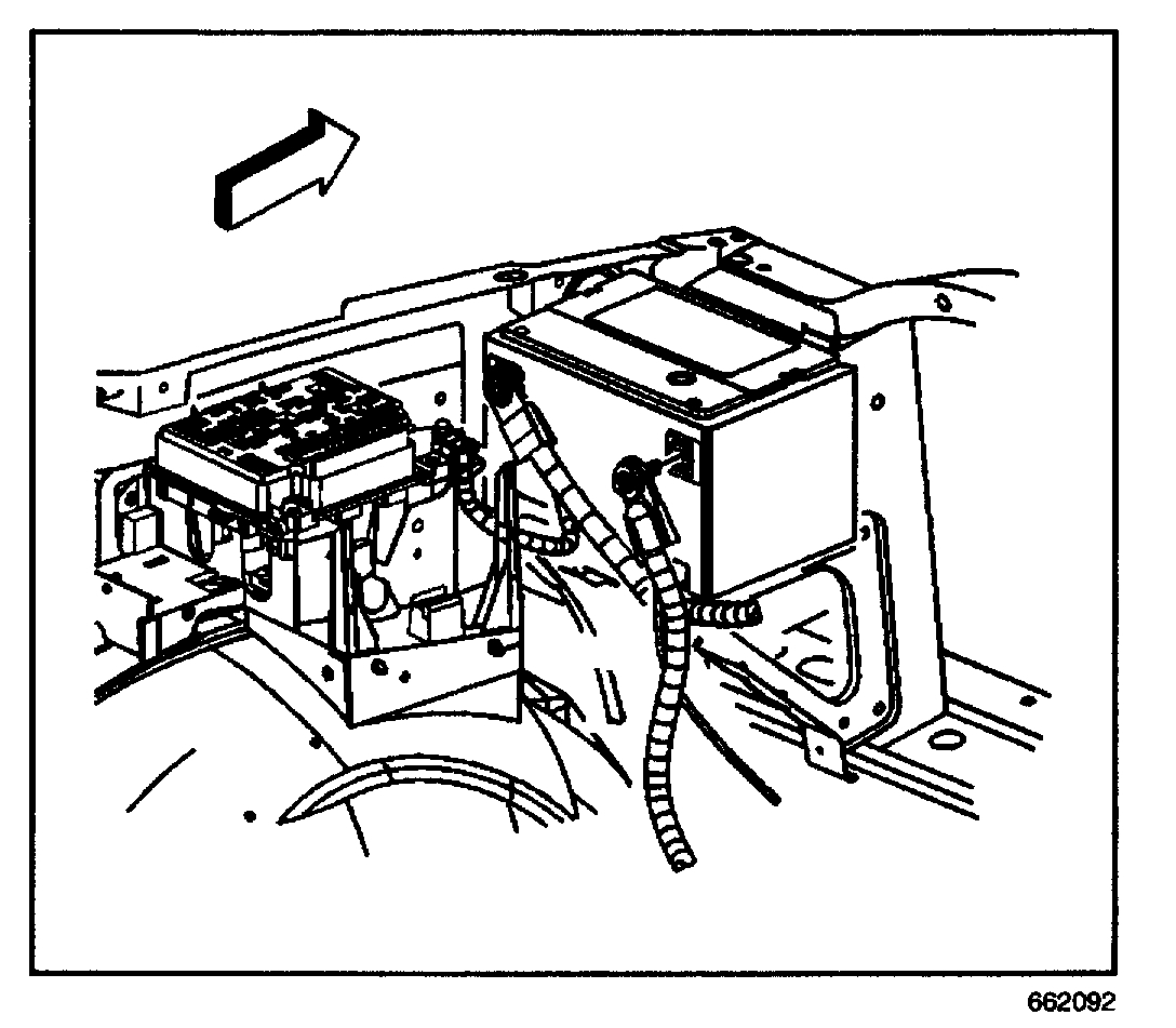

STARTER MOTOR REPLACEMENT -2
REMOVAL PROCEDURE
CAUTION: Refer to Battery Disconnect Caution In Service Precautions.

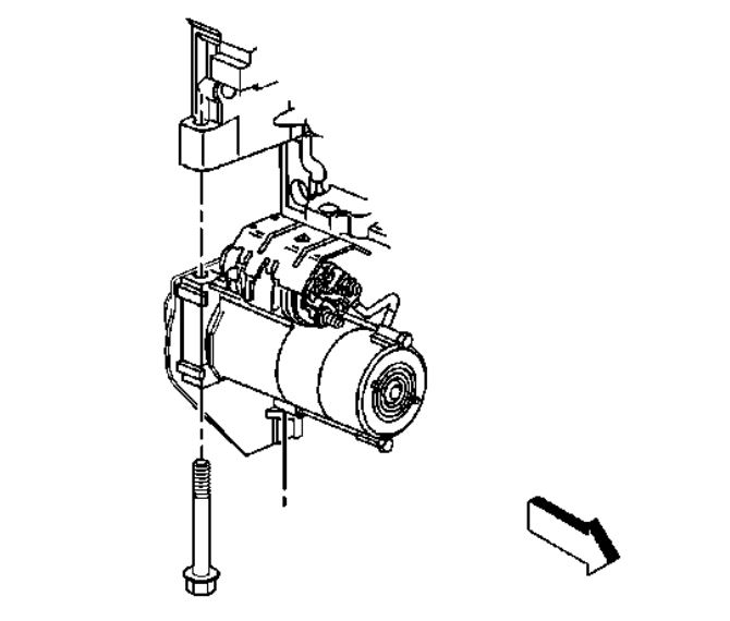

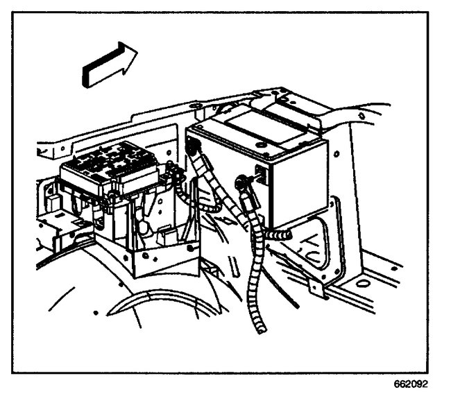

pic 1
1. Disconnect the negative battery cable.
2. Raise and suitably support the vehicle. Refer to Lifting and Jacking the Vehicle.

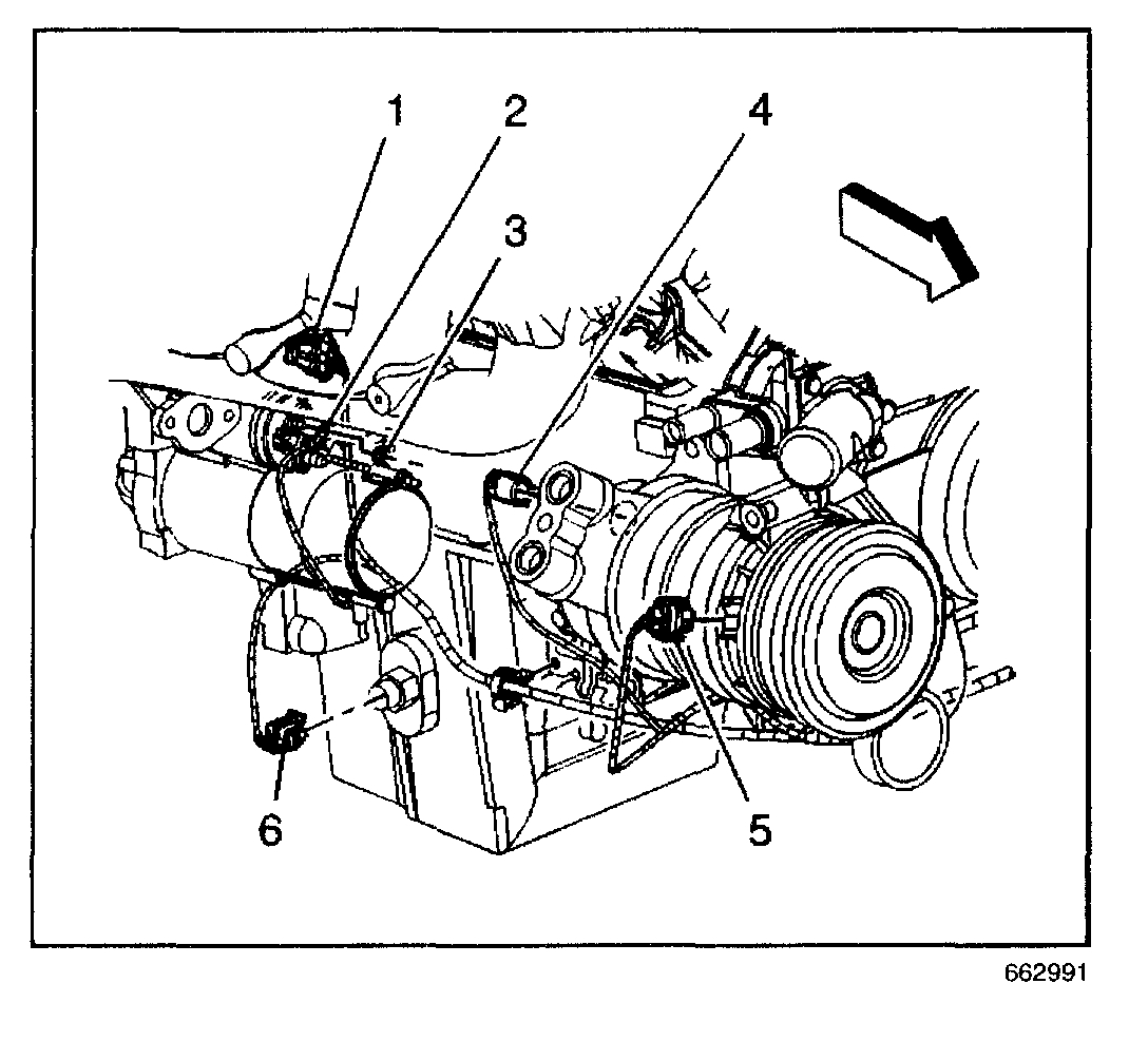

pic 2
3. Remove the right transmission cover bolt.

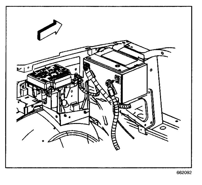

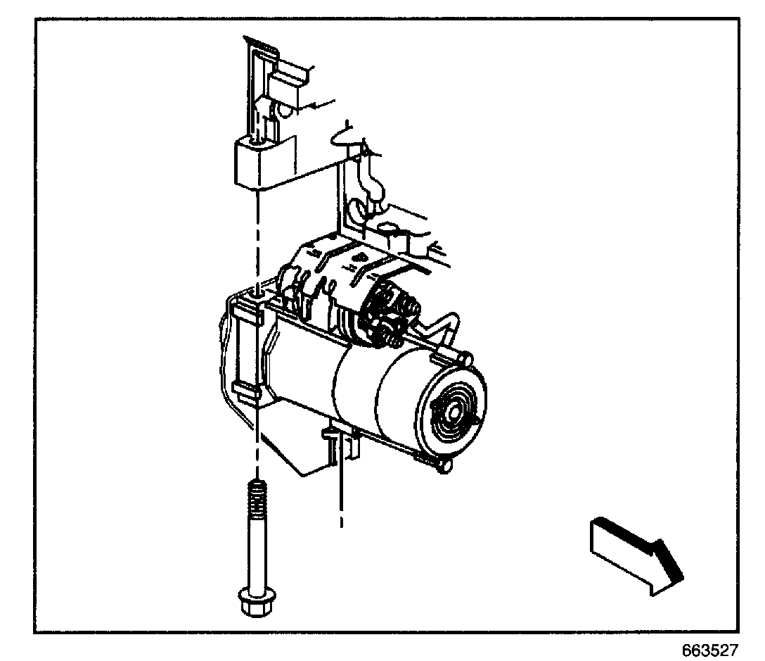

pic 3
4. Remove the starter bolts.
5. Disconnect the oil level sensor electrical connector.
6. Slide the starter forward until the starter clears the transmission.

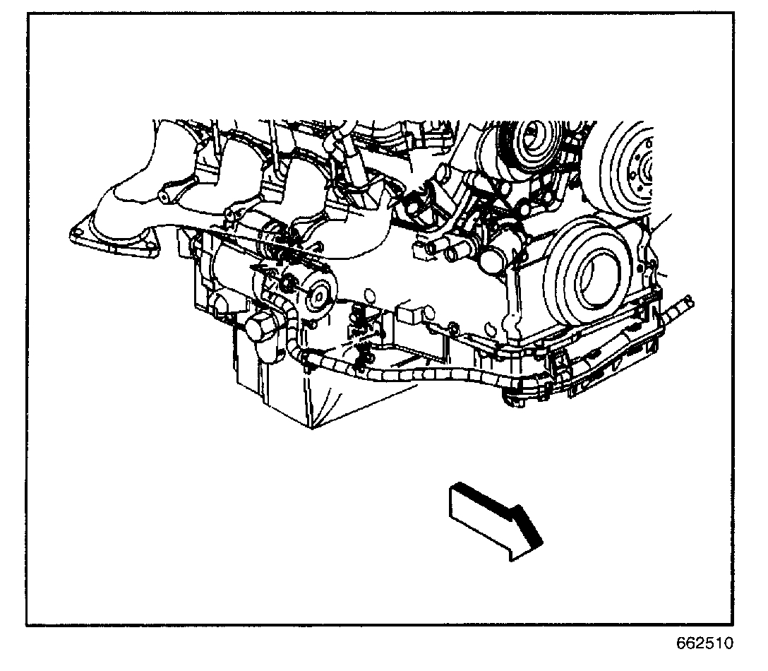

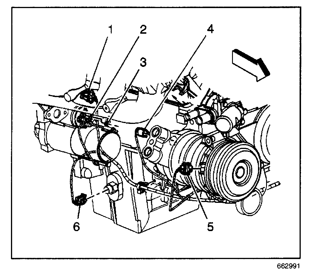

pic 4
7. Remove the starter solenoid nut (3).
8. Remove the starter lead (2) from the solenoid stud.

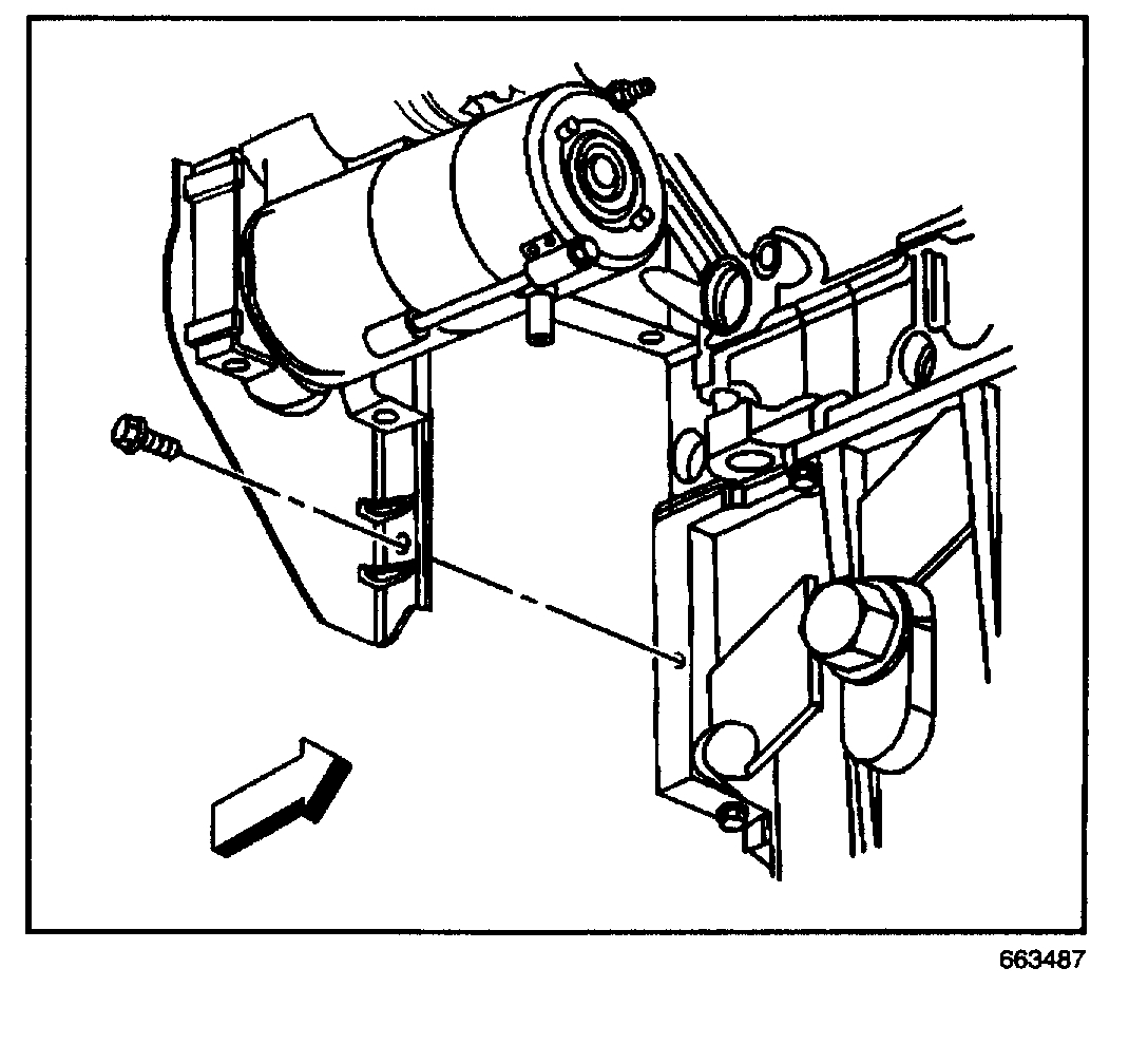

pic 5
9. Remove the starter lead nut.
10. Remove the positive cable from the starter stud.
11. Place the starter on a workbench.

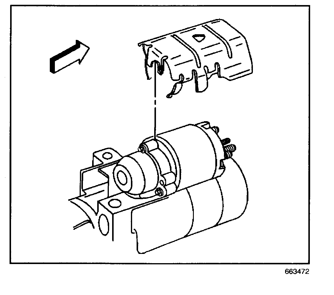

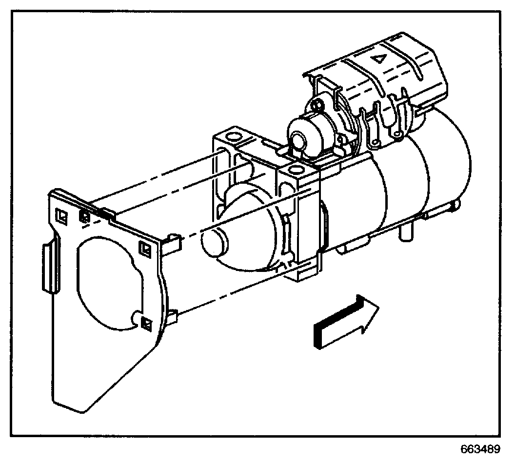

pic 6
12. Unsnap the transmission cover from the starter.

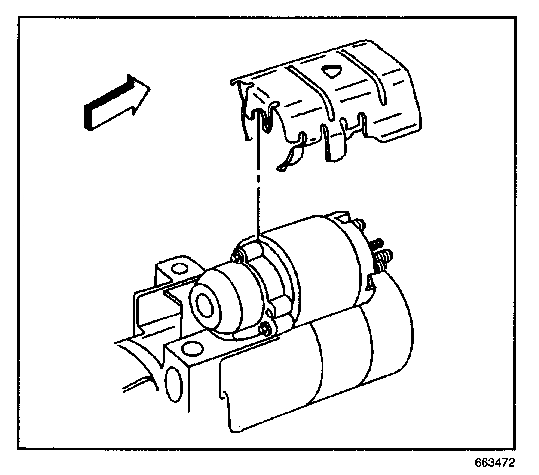

pic 7
13. If necessary, remove the starter shield.

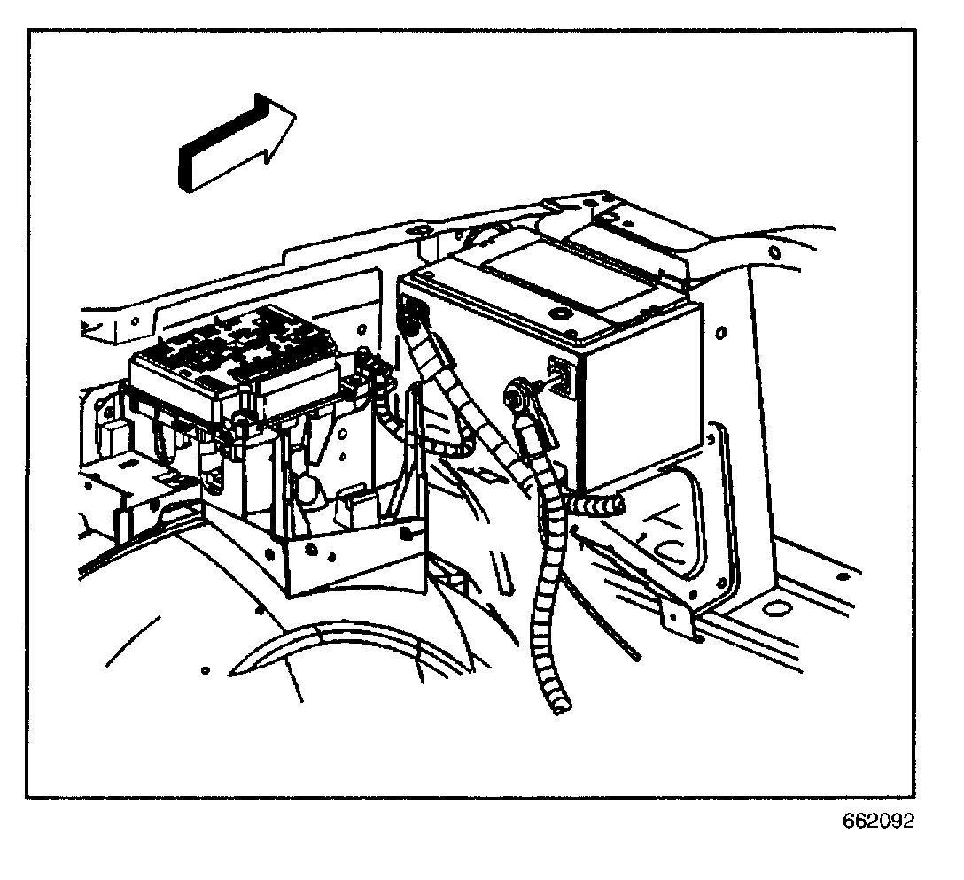

13. Connect the negative battery cable.
