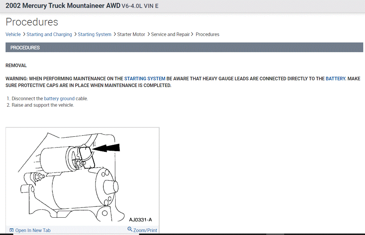

One thing I need you to remember, you must disconnect the negative battery terminal before starting to work on the starter. There is a 12v power supply constantly from the battery that can short.
To get you started, here is a link that shows in general how it is done. You can use this to help guide you.

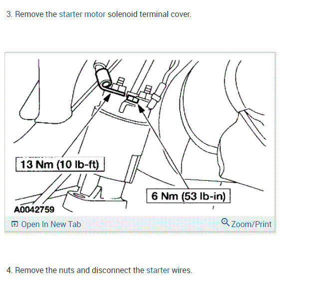

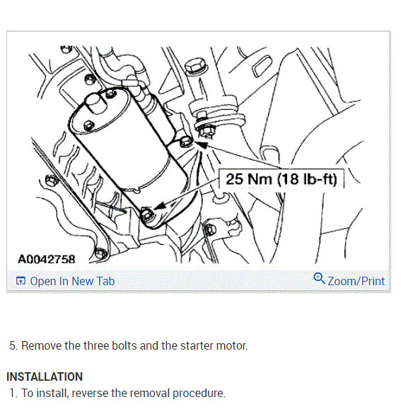

If you look at the attachments below, I provide the directions specific to your vehicle along with pics.
See pics below.
